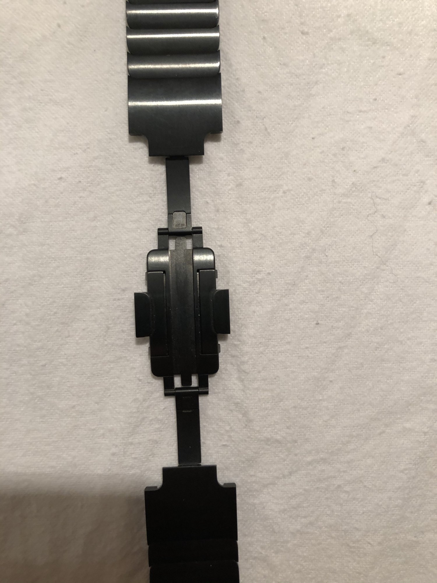

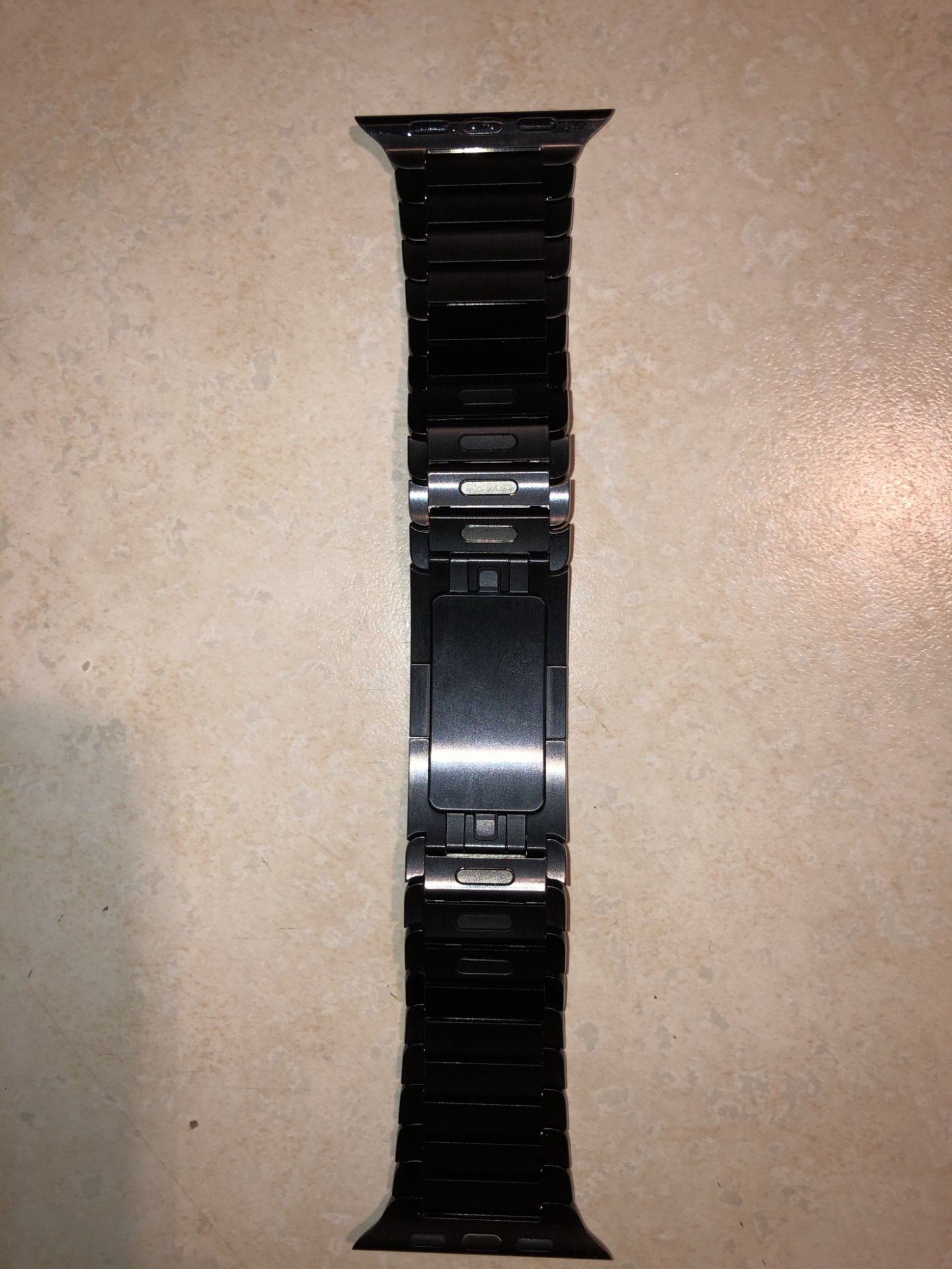

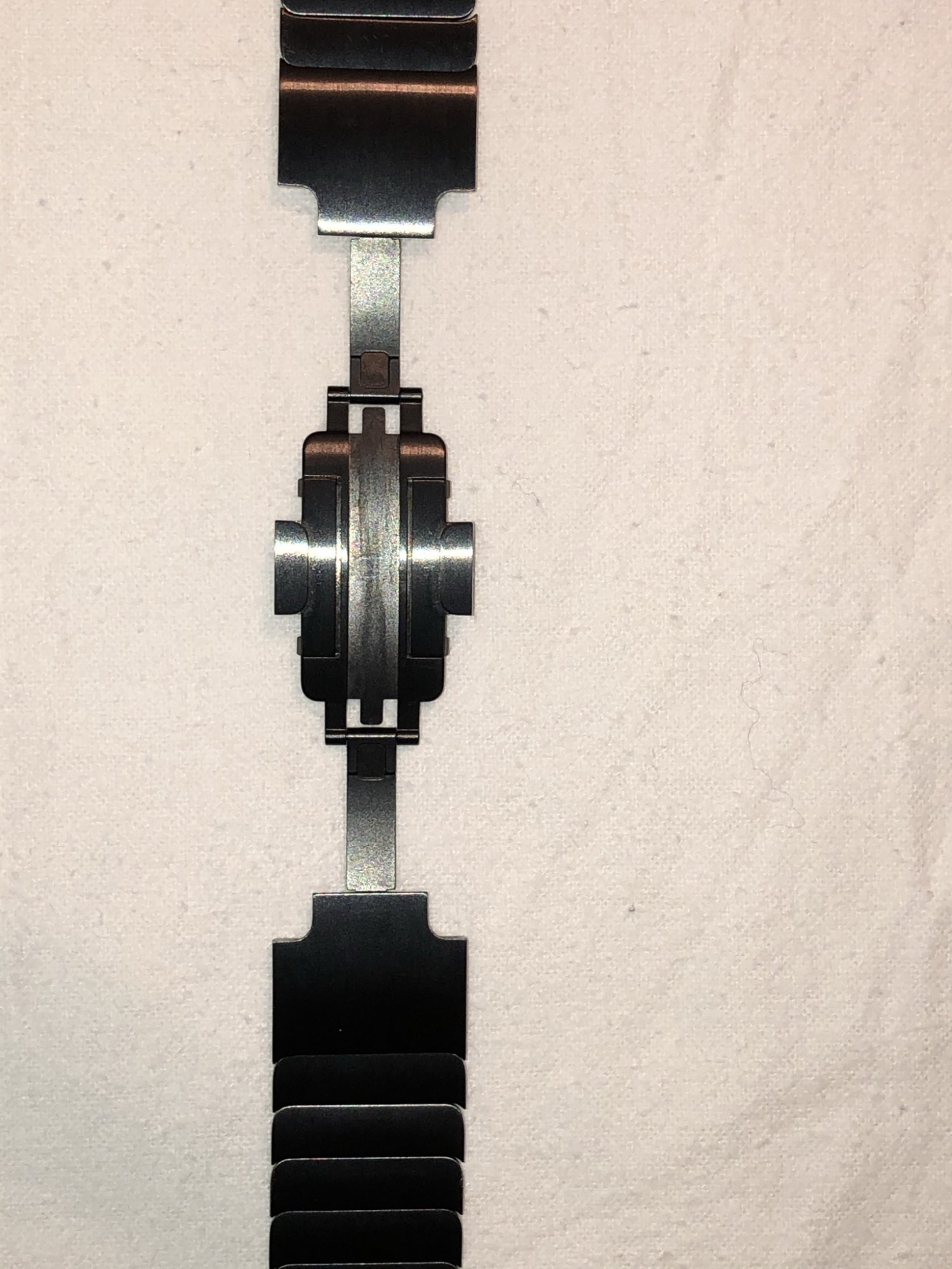

Yes, picture #3 and #5 shows the sizing and apple/nike+ marking. On the side of the 44mm marking of the loop the connector does have some characters - too difficult to see.
Oops! Neglected to actually click on the thumbnails and look at the full pictures. That’s a genuine band. Most likely the “Assembled in China“ marking is just not visible in that picture (the lighting is not great and the lug is so close to the camera that it is actually out of focus).
All listings I have come across have shown the "assembled in China" mark clearly. All bands have the marking in a contrasting color. There is no mark on the band. That is what prompted me to ask my question and seek opinions on it. I do believe that it is a genuine band, but it is just odd that the marking was not printed on it. Maybe, the markings were dissolved by cleaning the band with an abrasive cleaning agent. Possible?

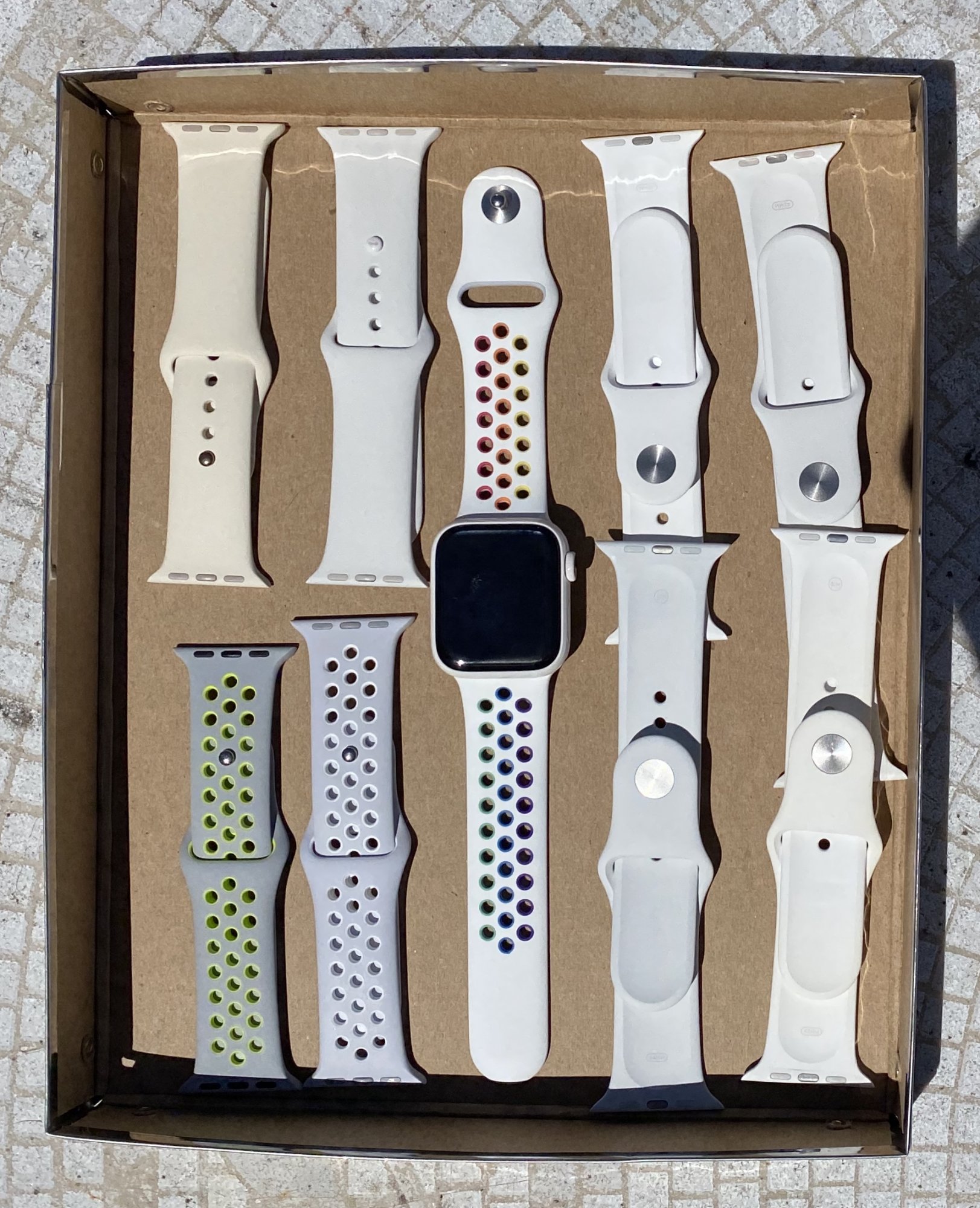

Hi there. Could anyone here talk about the color difference? What about the color brillance, intensity etc... are same colors by name really identical? I can just say that I had a white Apple and fake at the same time. The fake white was brighter. No I got some fake ones but I´m not quiet sure about the color quality. Thank you.
Apple has done so many colors (in certain hues) and quite a few whites, so I don’t think color is something to go by. Especially if you have a white OEM band of your own that has some mileage on it. Even if you take good care of it, I would bet just light exposure tints the bands slightly.
To wit:
Sure, sure. But it was a new one. I don´t want to say that brighter is better. The fake one was brighter but the brightness did not seem to be something better qualitywise. Maybe even not so good, I liked the Apple White better. I assume that the fake colors are less intensive generally but it is just an assumption. If that´s true, I´d prefer the Apple ones.

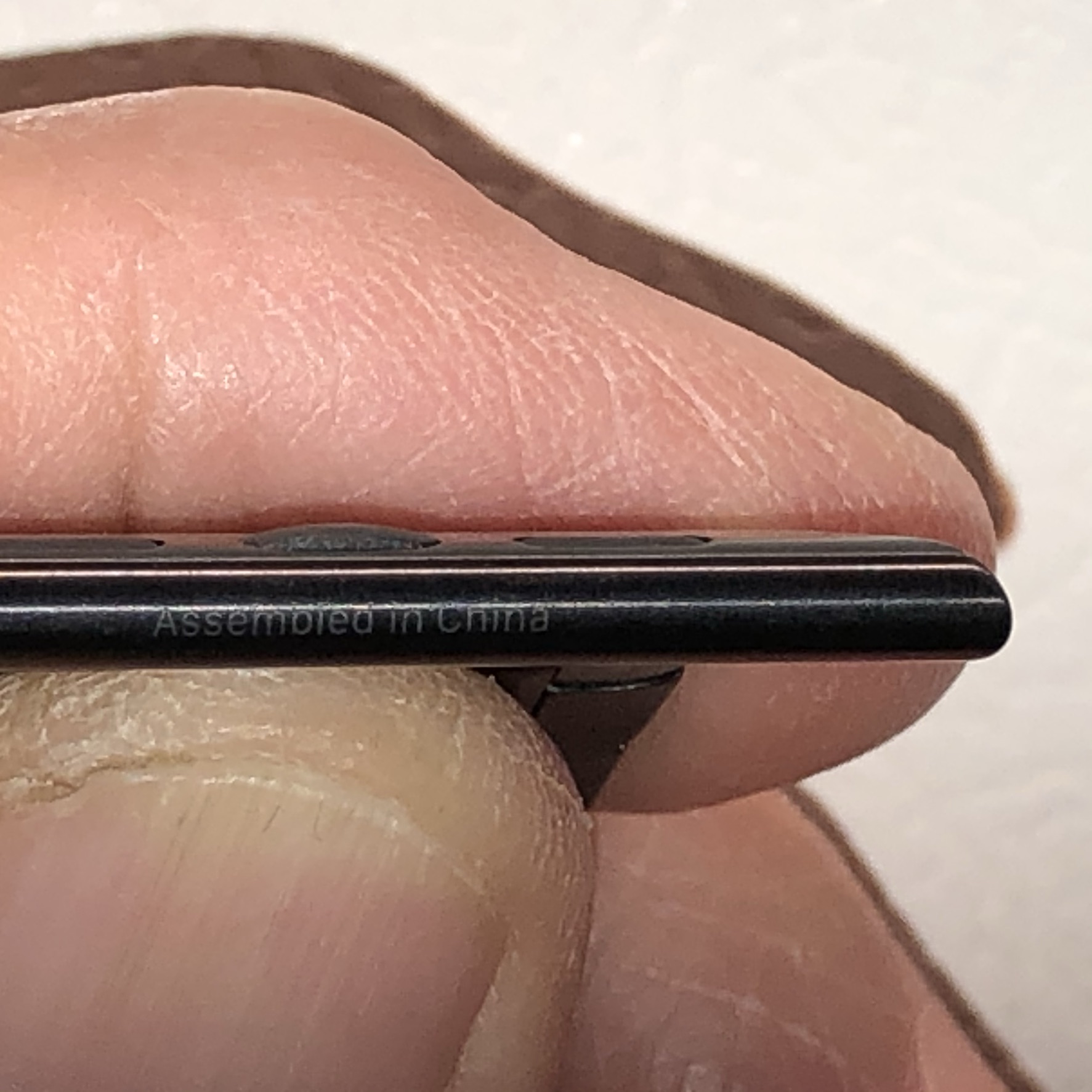

There is a "Stainless steel" engraving on the lug that moves freely.
Applicable for sizes 42/44mm. For sizes 38/40mm on the edge of the S/M strap.

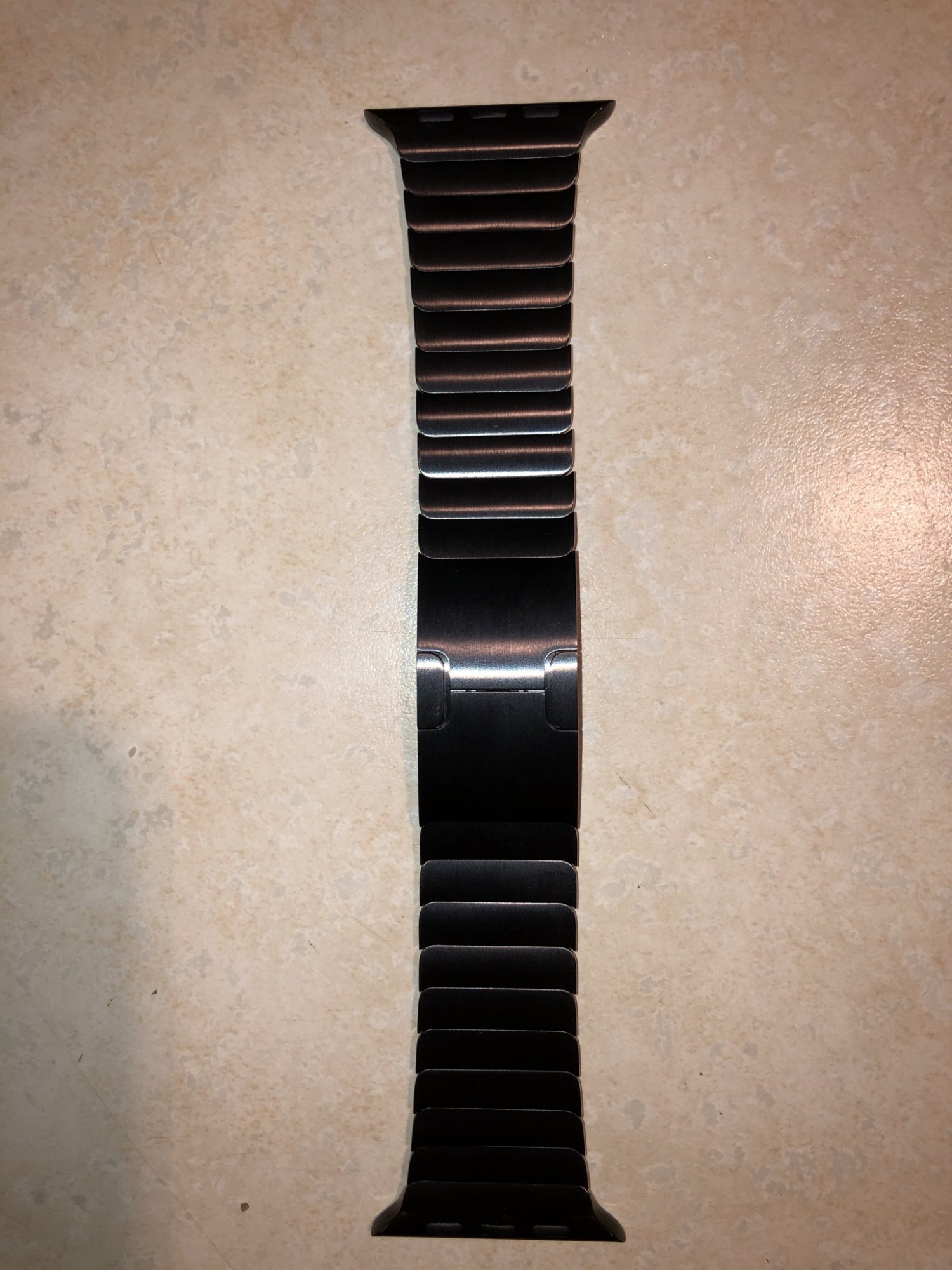

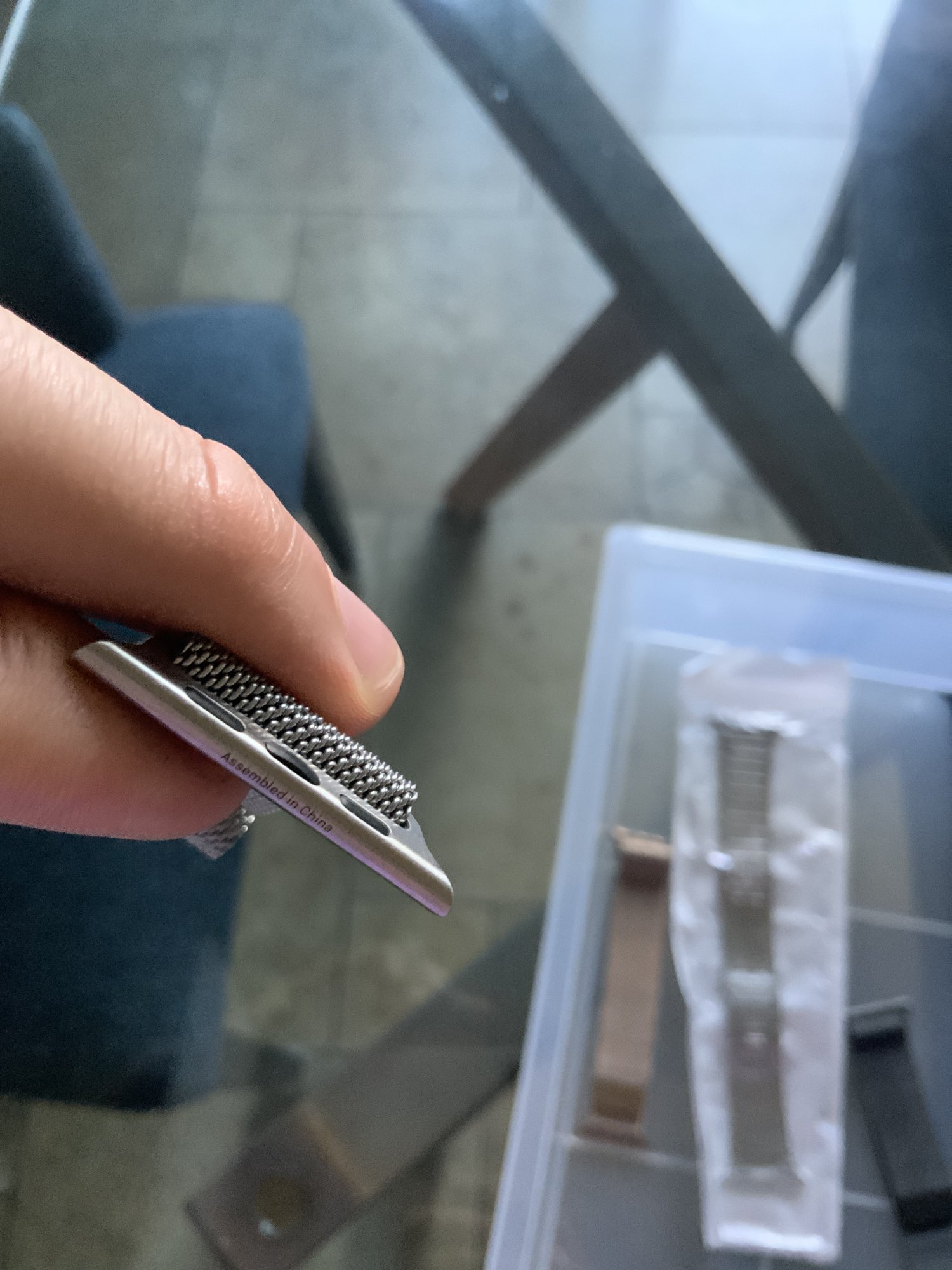

I just purchased a Milanese loop, the seller assured me it is original. It has the 44mm and Stainless steel stamped on it but I cannot find 'Made in China' anywhere. Also the magnet end does pass through the lug. Were there ever loops that were made without the 'made in china'?
All my Milanese, including my gold s4 which passes through for AirPower (lol), have “Assembled in China” lasered on the lug with the hole in it. Quick iPad pic:

Milanese Loop
One of the most popular styles of band for the Apple Watch, the Milanese Loop is also routinely copied. Pay close attention if buying one second hand.
Signs the band is Genuine AppleSigns the band is a Fake
  • The case size (38/40mm or 42/44mm) is engraved on the underside of the non-loop lug.
  • "Stainless Steel" is engraved on the underside of the loop that the band passes through.
  • "Assembled in China" is stamped on the edge of the lug opposite the case marking.
  • The edge of the magnetic clasp has a small indentation for your fingernail to make the band easier to take off.
  • On most genuine Milanese Loops, the magnetic clasp cannot be pulled through the loop lug.
    • However, there was a period in 2018-2019 where the Milanese Loop was made so that the magnet could be pulled through the loop and the band would come apart so the watch could be used with AirPower.
  • Engraved/stamped markings are not present.
  • The magnetic clasp can be pulled through the looped lug.
    • Again, this is not a sure sign the band is a fake. It may just be from the 2018-2019 run.
  • The coating wears off easily if it is a black or gold band.
  • The band is offered in funky colors like bright blue, red, or even metallic rainbow.

I recently purchased a used space black link bracelet that does not have the “316 L stainless steel” engraved under the clasp. But it does have the “Assembled in China” engraved on the lug edge. I asked the seller about the authenticity of the band and she told me her husband was an Apple employee and received this band as a gift from his work mates years ago. Have you ever encountered or heard of a link bracelet such as this?
Based on the wide range of unmarked prototypes and misfit bands we the band-obsessed get from ChargerStore on eBay that are nonetheless legit, I’m inclined to trust it.
Yeah the only place I have seen a genuine link bracelet without the clasp engraving is Chargerstore. Can you post a picture with the clasp buckled? The fake ones often don’t look as clean as the genuine band when closed. Also, do the links separate with buttons? I am skeptical of the “Apple employee” story you have been given. But, the band might still be genuine and just a factory reject from a place like Chargerstore.
I mostly have the first three generations Classic Buckles and a bunch of leather loops. I saw this advertised for $15 and figured why not. It’s actually pretty nice. It’s clean and well-made, no gaps and the closure snaps nicely. The “Assembled in China” etching throws me though.
