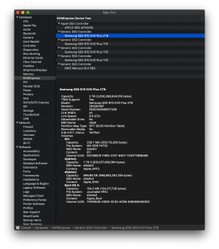

I inadvertently formatted my Samsung 970 EVO Plus blades before taking the time to obtain their Firmware revision IDs.
Now that they have been formatted as HFS+ and the 4 of them configured as RAID-0 using Apple, Disk Utility is it possible to obtain the firmware revision IDs, and if so how ?
[EDIT]
OK..... I figured this out for myself.
  1. With Option key pressed: Apple->System Information
  2. Select "NVME Express" in the side bar.
  3. Highlight the various Samsung SSD 970 EVO Plus 1TB (and in my case one 2TB)
  4. The firmware region is displayed under the Model: line in the lower portion of the window.
  5. See attachment screen shot image
Hope this may help others. 👍 🙂

The info in NVME Express will not be available if you have their driver installed.
OK.... I never installed Samsung's driver code nor anything from Sonnet. Everything about using my Sonnet PCIe x16 card with its installed Samsung blades have been working flawlessly for me. I have a 1TB on one of the 2TB blades setup as APFS and I can boot from. it without issues.
