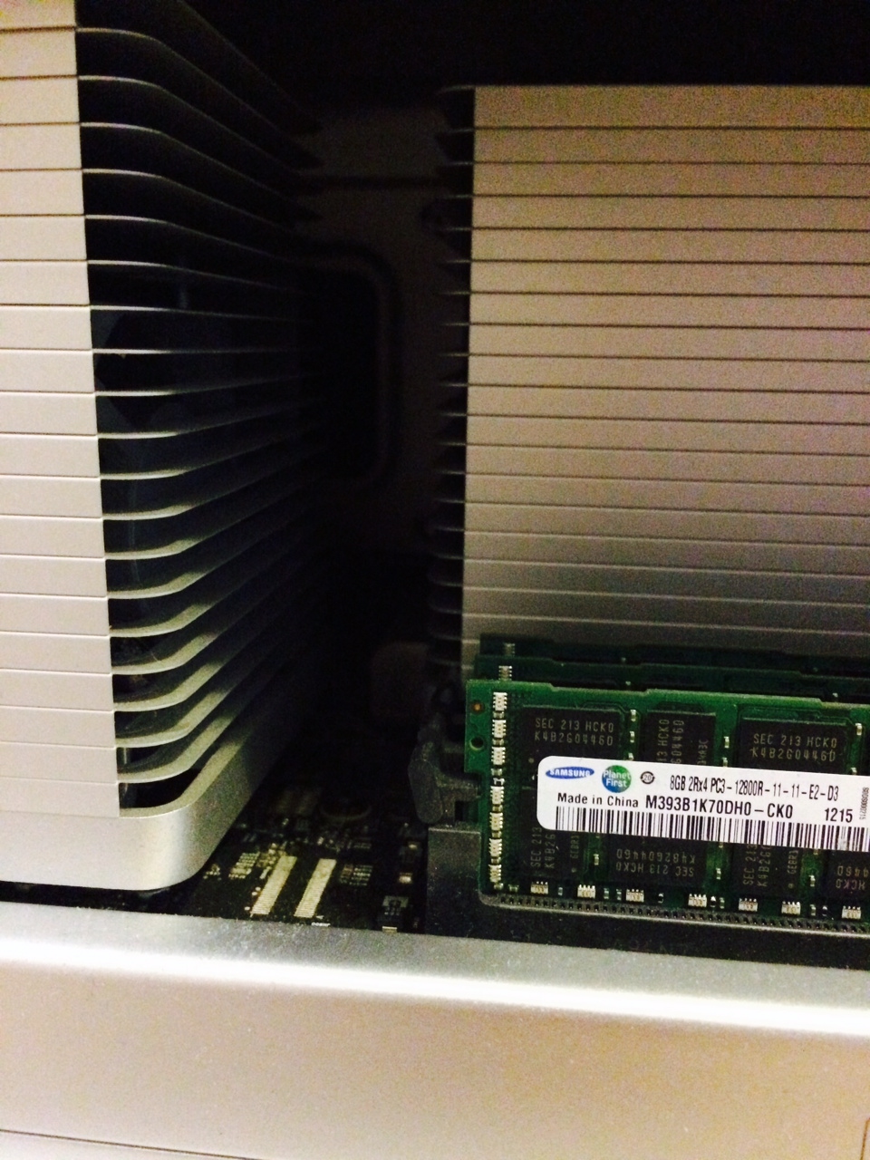

I don't know... I thinks mine is a lidless model; what are the differences (if any)?

Also it is an oxymoron what is listed on your RAM module - Made in China and 'Planet First'?!?!

Yeah hard to tell unless you take it apart. The 2009 model was set for lidless CPUs. You could still install lidded ones but either needed to use washers to to keep from tightening the screws too much or just not tighten the screws too much or you could damage the CPUs. It would be nice to know ahead of time of course.

And yes, your 4,1 can be upgraded to 5,1 firmware, but you paid for a 2012 5,1 machine and didn't receive it. The lidless CPUs could cause problems down the road if you decide to upgrade, a real 5,1 uses lidded (standard) CPUs that are much easier to upgrade.
