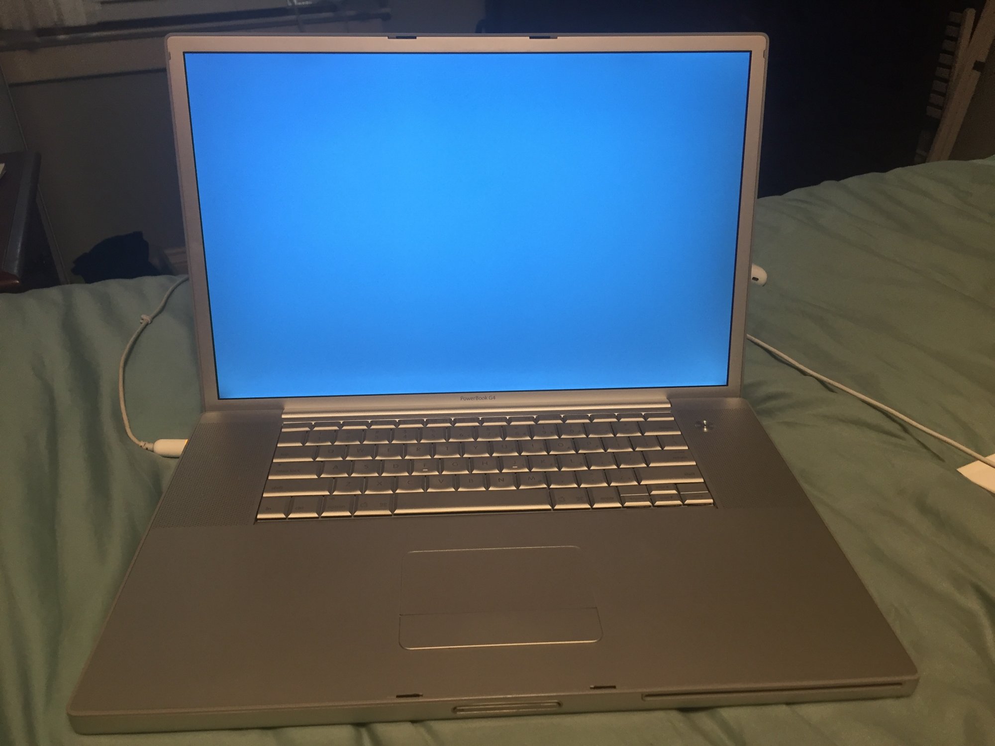

Hi Everyone! I just received a 17" Powerbook G4. I took a gamble on it hoping that it would be an A1139, and it turns out it paid off! I'm so happy and excited! It arrived running 10.5 (leopard?) and I would like to downgrade to to 10.4 tiger so that I can run the classic environment.

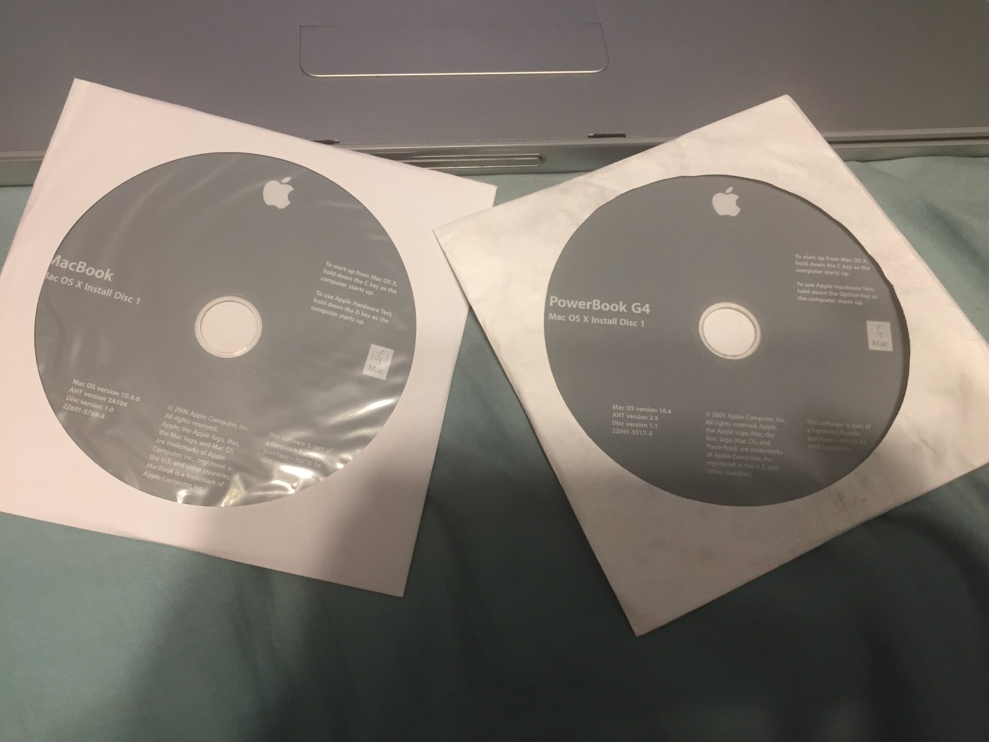

Fortunately I have the original install disk for tiger as well as these 2. (original disk not pictured as it is in my machine)
I put in the original disk and launched the install and now the screen has been like this for over 10 minutes.
I haven't worked with a machine like this in probably over a decade, so I have no idea what I did wrong or how to fix it. It was working perfectly fine with the few tests that I tried prior to this. Any and all help appreciated! TIA
Update: I zapped(?) the pram and got it to boot up normally. Now how do I safely go about installing tiger without it happening again?
Gray disks tend to be system specific. If you are absolutely sure that your gray disks support the model of 17" PowerBook G4 you are using then proceed. Otherwise, I'd find a retail version on Macintosh Garden (do a Google search), burn a disk and use that.
In the top photo you show a gray system disk for a MacBook. That is why I am questioning this. That disk is only going to work for the model of MB it shipped with.
In any case, once you're in the Installer, go to the Utility menu and open up Disk Utility. Select the drive and repartition it. That'll wipe it. Then quit Disk Utility, select the drive for the install and proceed.

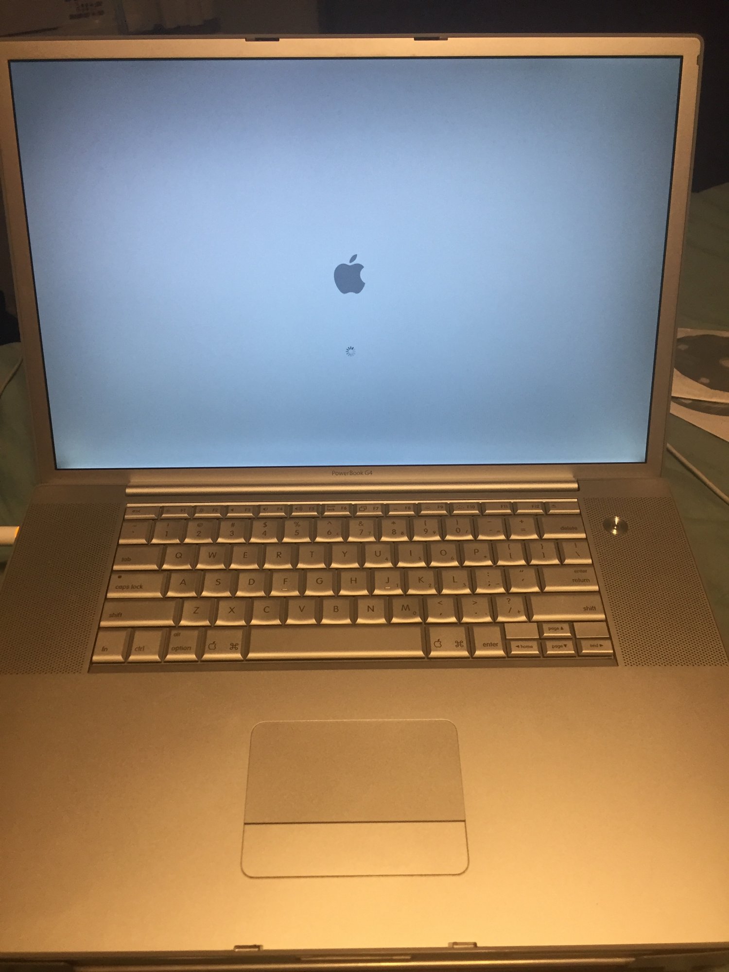

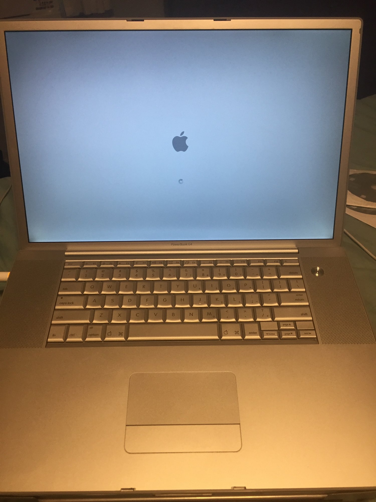

update: I tried the install again and it is now stuck on the apple screen and the wheel is frozen.
I tried a restart while holding down the "c" key and that didn't seems to do anything.
update: I tried the install again and it is now stuck on the apple screen and the wheel is frozen.View attachment 935803
See my post above. Are you absolutely SURE the gray disks you have are for your specific model 17" PowerBook?

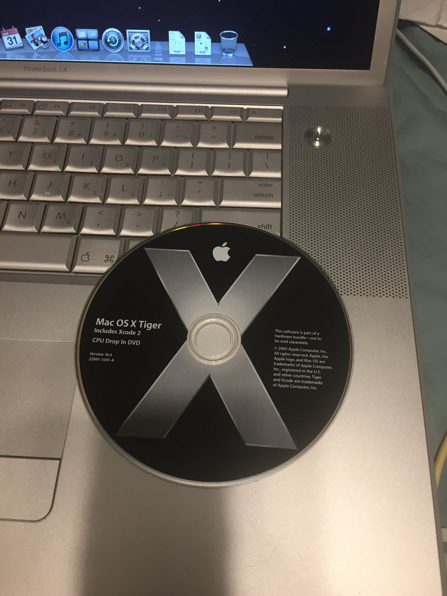

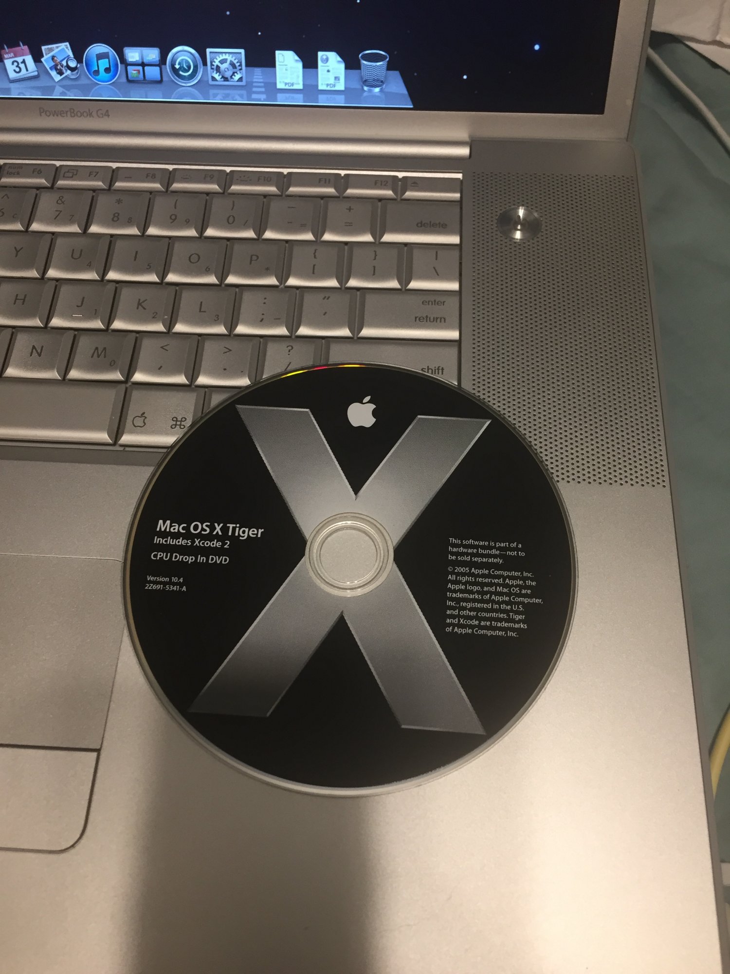

The grey disk is not what I am using. This is what I am using.
I wasn't able to get it out of the machine when I made my initial post, but since I rebooted it I can now.
Reactions: eyoungren
The grey disk is not what I am using. This is what I am using. View attachment 935804
OK, that's a retail disk.

Do you know exactly what model of 17" G4 you have? It's possible it came out after the gold master of Tiger did, making it not possible to use the retail disc you have.
This is an A1139 which was made in 2005. Would that be too late for the original disk to work? It does appear to just be 10.4.
From the DVD label:
"CPU Drop In DVD"
That's a DVD that was a "drop in" to the box that new PowerBook when Tiger was first released, so the new buyer could immediately upgrade a Panther system to Tiger. I think you can trick that DVD into a clean install, but mostly it was to upgrade an already-existing Panther system. However, 10.4 will be too old to work in your PB G4 DL.
The DL model also came with a special build of 10.4.2, so you will need to find a version higher than that 10.4.2 (Last commercial install version is 10.4.6 - that will get you where you want to be with Tiger.)

From the DVD label:
"CPU Drop In DVD"

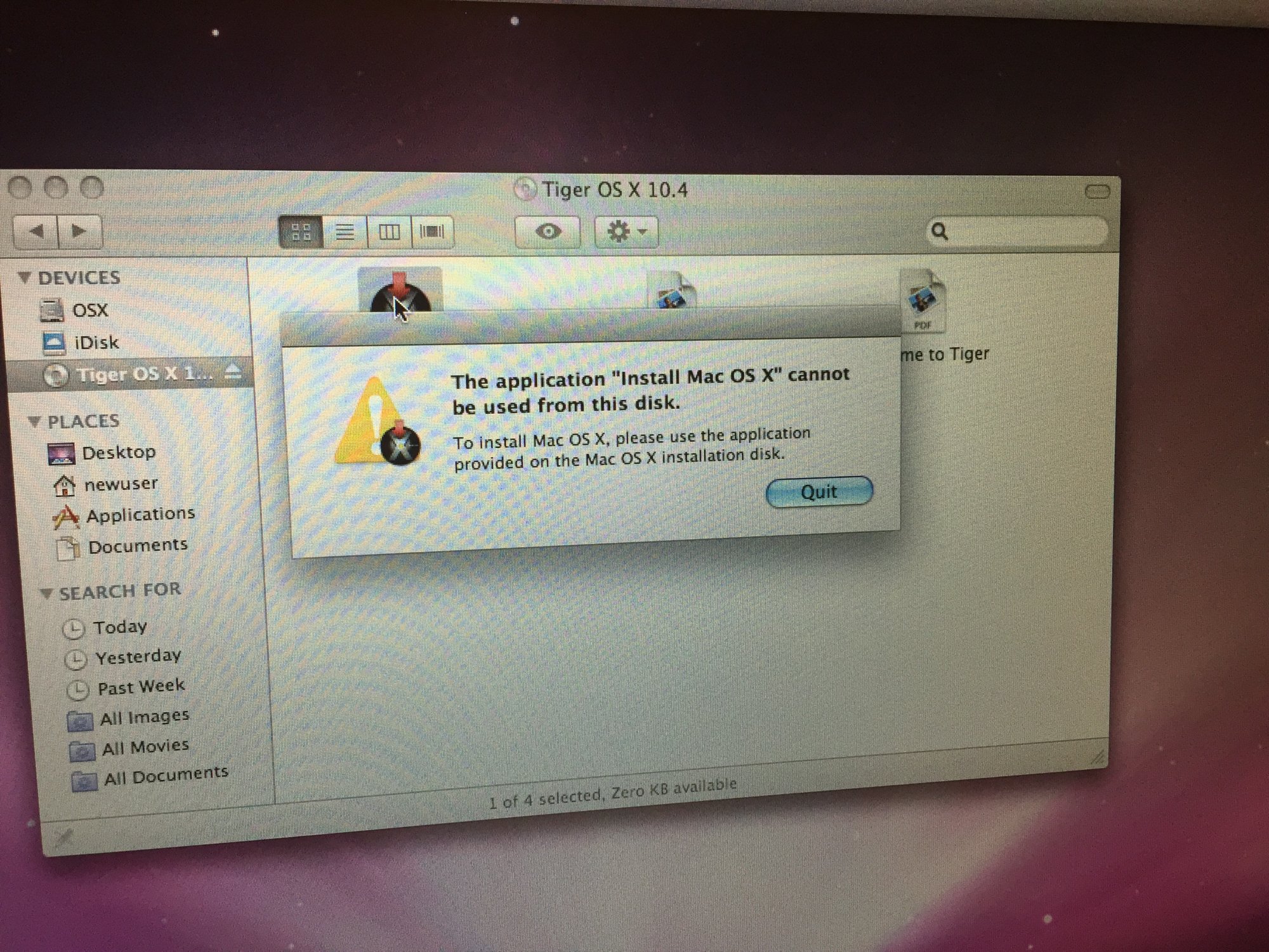

I was right! I have more questions! I dowloaded file #30 from the link above. I burned it to a dvd+R as a zip file and when that didn't work I unzipped it, opened the .dmg and burned the files inside to the dvd. Neither worked. The first attempt enabled me to open the .dmg on the powerbook and launch the installer, but when it restarted it just prompted me to log in to my account. It was like it forgot that I was trying to do an install in the restart. When I tried the dvd with the files directly burned to it, after attempting to launch the installer, it gives me this message.
Am I doing this all wrong? What am I missing?
