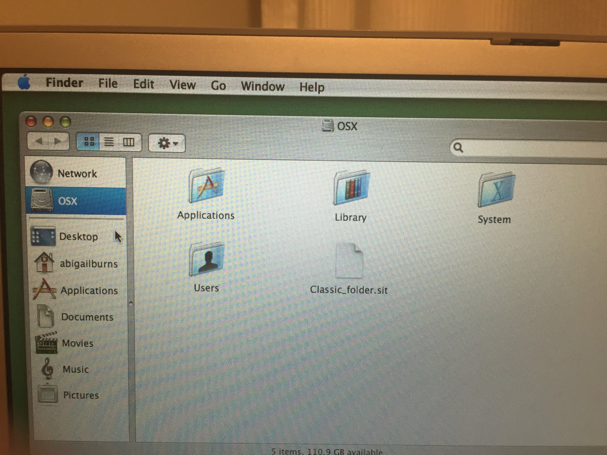

Ok so I think I found the right thing on Macintosh garden for classic. I downloaded the second file from this page. https://macintoshgarden.org/apps/mac-os-922-system-folders
It dowloaded as a .sit file so hopefully that is the right thing. Now I feel silly asking this, but how do I find the root of the hard drive in tiger so that I can put this file there?
The root of a drive is always the beginning. Open the hard drive on the desktop and the very first thing you see is the root.
Ok so I copied the .sit file to what I think is the hard drive (but its labelled OSX?).

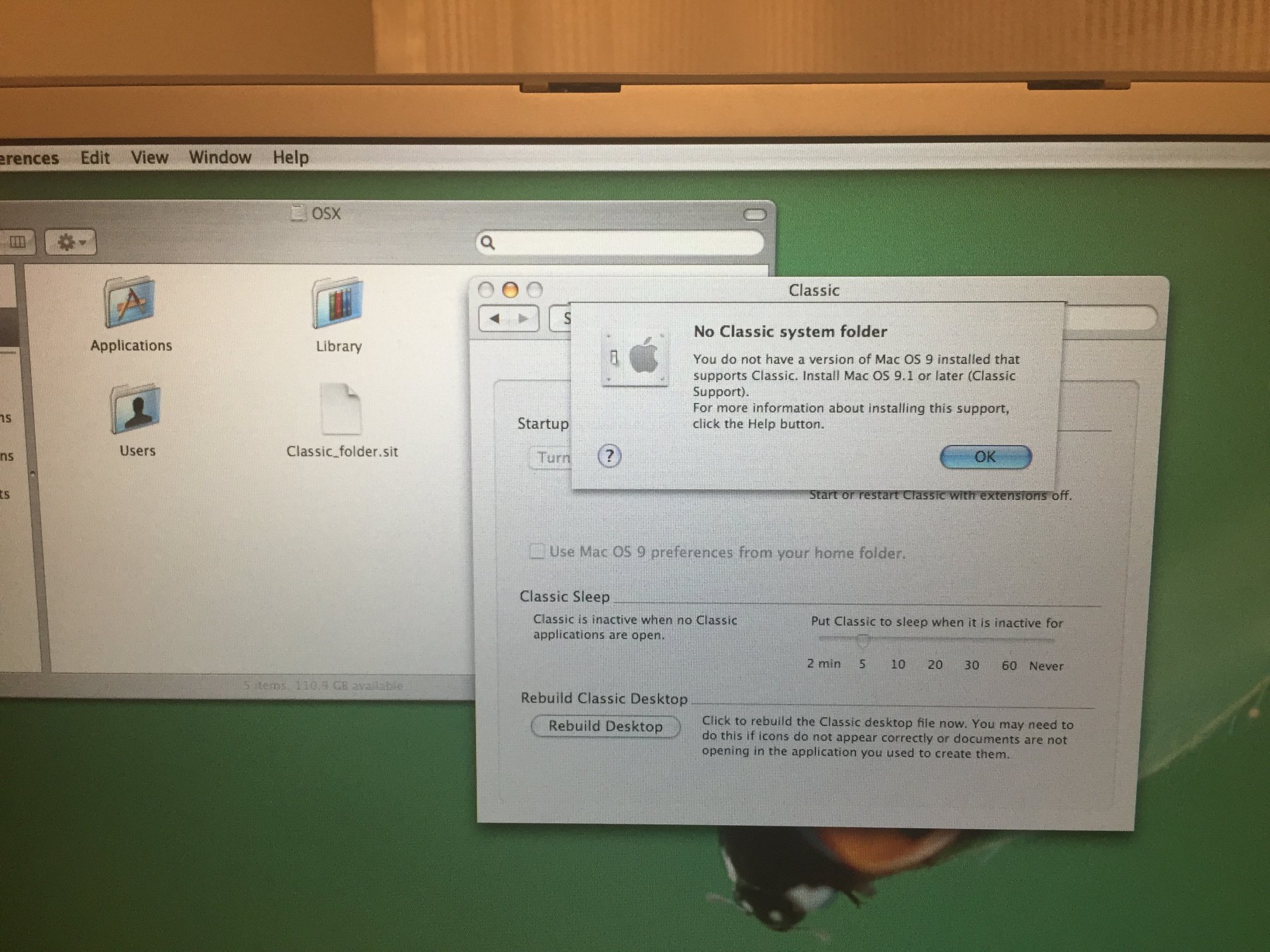

But when i go into classic section in system preferences I get this message.
Your download System Folder is an .sit file -- a file comressed in "stuff-it" format.
You need to "un-stuff" that file so it is an actual System Folder. The Unarchiver will do that very neatly, but you would need to do that on a Mac running Lion (Mac OS X 10.7) or newer.
Thats what I ended up figuring out too! So i actually downloaded an old version of stuffit expander on my current computer and put it on a file drive to download it onto the powerbook. That didn't work tho, so i put the .sit onto the thumb drive and now i am doing what you suggested.
Hey I just wanted to give everyone an update since i did end up resolving this. Stuffit wants working so i ended up expanding the .sit on my normal computer and loading the system folder on to a usb. I dragged the system folder from the usb to the root of the hard drive, which on my computer is labeled OSX. I then had to go into system preferences, select the newly present classic button under the systems section, and select the correct folder for classic. I've tested a few games so far and they're all working great! Thank you all so much for helping me figure all of this out! This would have taken me so much longer other wise and I'm not sure I would have succeeded. So thank you all of you!
