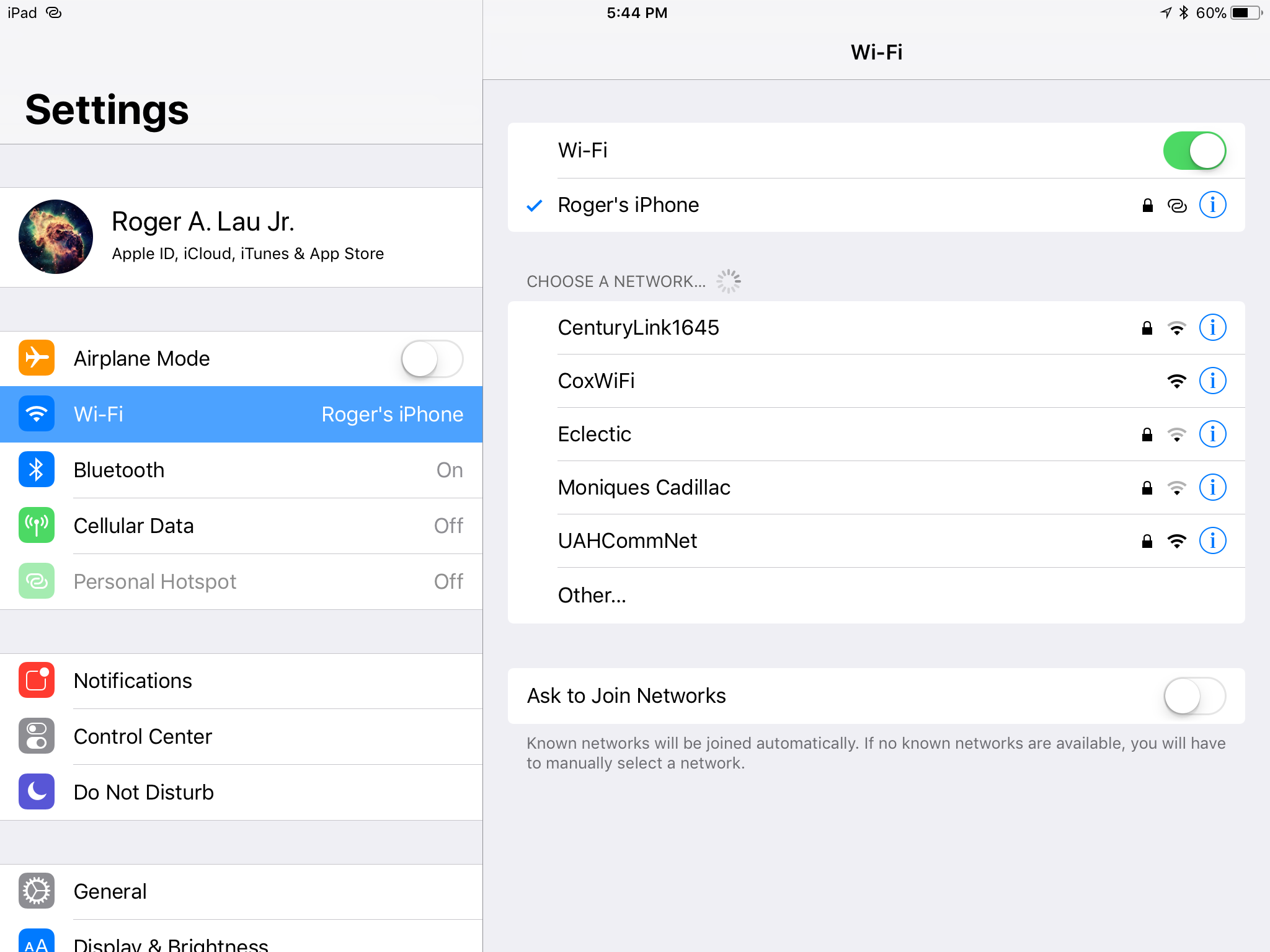

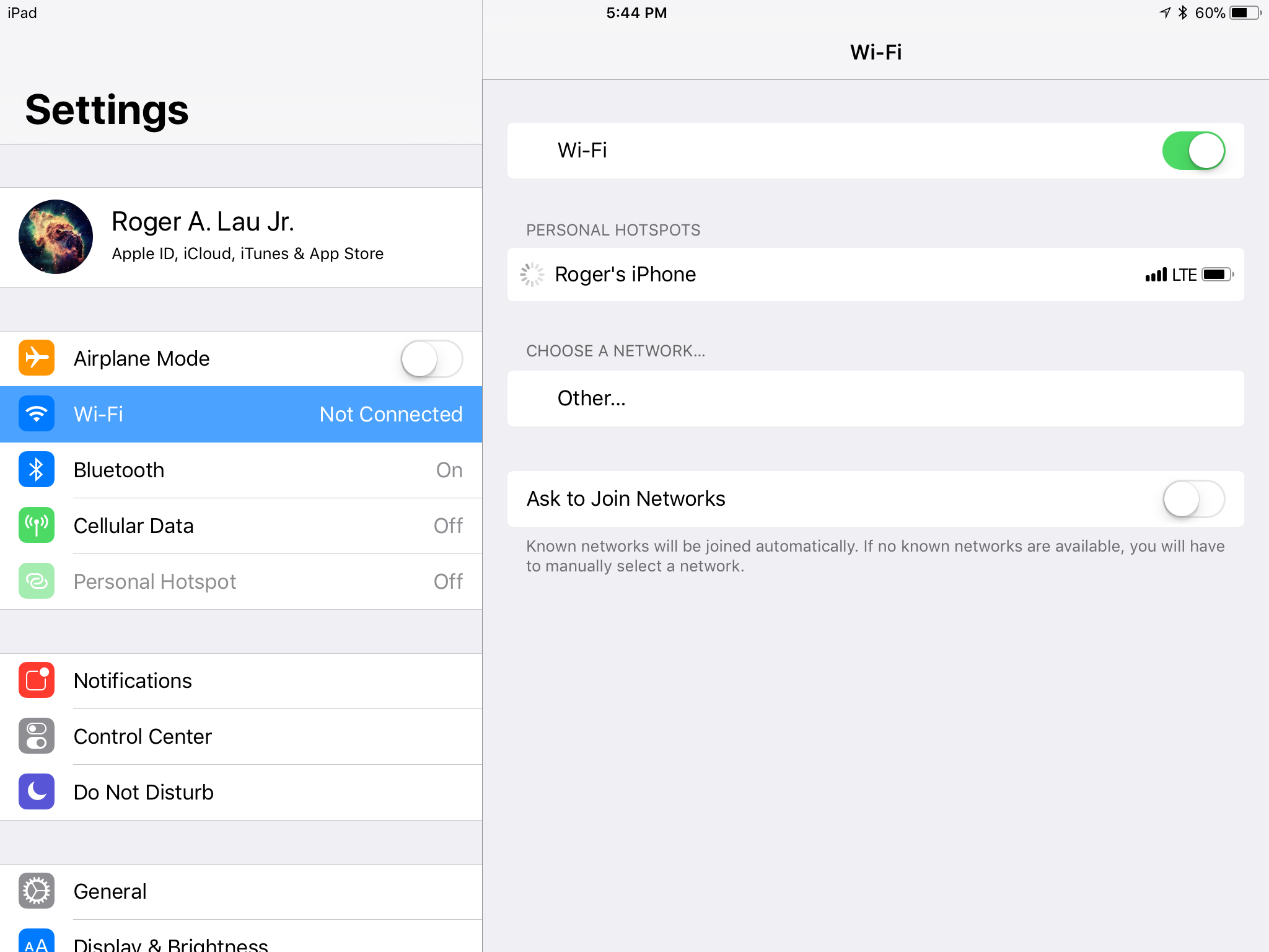

Yes you can do this. All you need to do is be signed in to both the iPad and iPhone with the same iCloud account. And you MUST have two-step verification enabled. If I can upload a screenshot video I will!! I’ll try at least...
As the photos proceed...
HOTSPOT is OFF, but comes up.
I turn the HOTSPOT ON
IPhone HOTSPOT is ON, and as I said I turn it on from the iPad. Which has NO cellular service connected.
