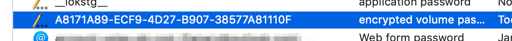

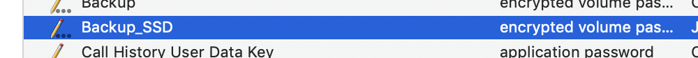

I played around with it, and it looks like you can copy the entry from the login Keychain and paste it into the iCloud Keychain. But instead of keeping the drive name, it changes it to the UUID # of the drive.
Here is the login Keychain entry.
I right clicked and copied it from login then right clicked and pasted in iCloud Keychain and it made the new entry you see here in the iCloud Keychain. Presumably this would sync along with everything else in the iCloud Keychain.
I have not tested if you delete this entry from login Keychain if this iCloud entry will unlock the drive.

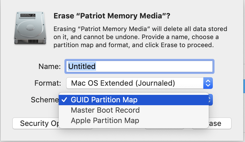

Hi everyone,
I would really appreciate your help.

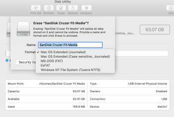

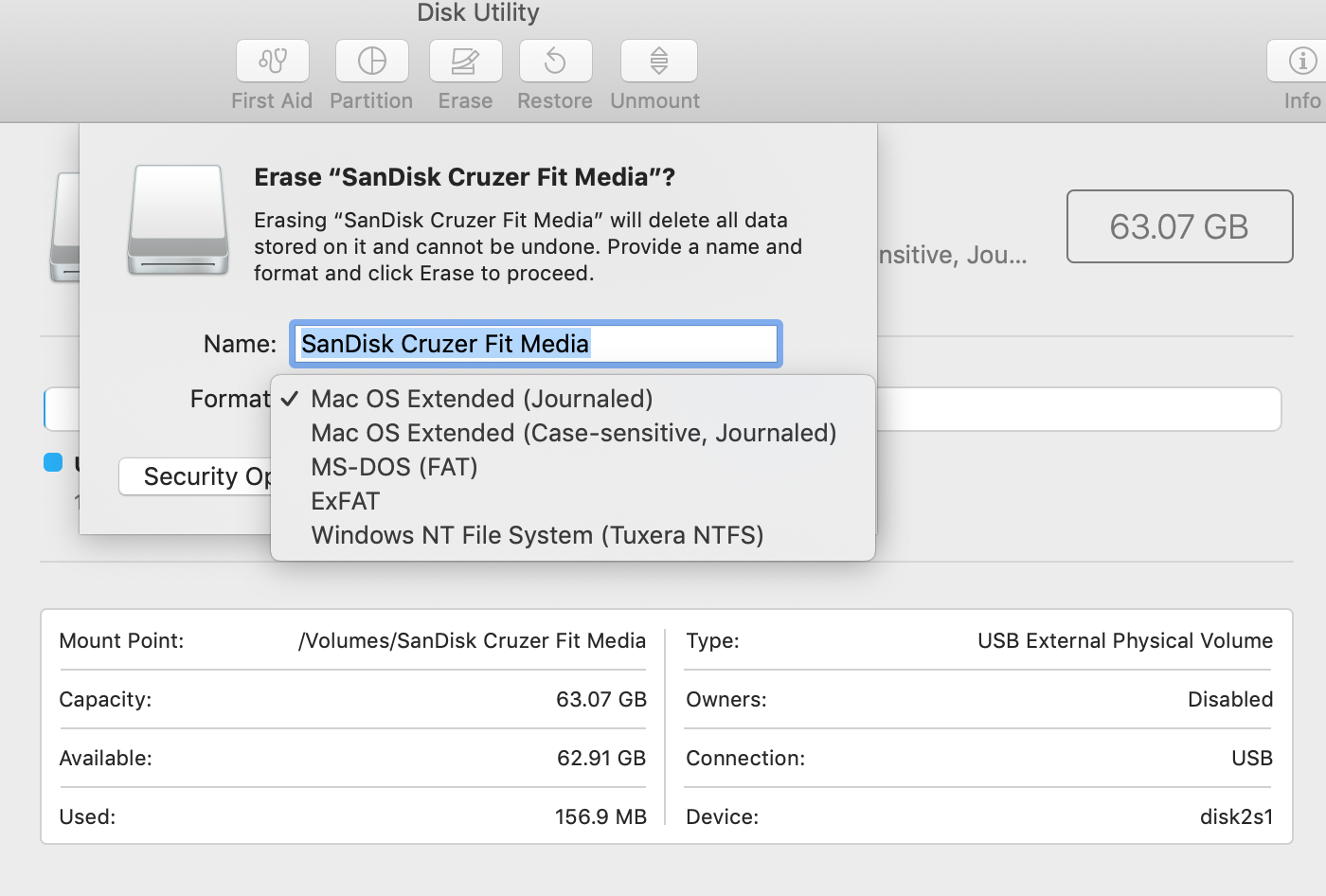

I tried to encrypt my usb drive but no joy. 🙁 When I drop down erase options in Disk utility it would not give me encrypt one. Please look at the attached photo and advise me what to do.
Thank you very much in advance

Hi everyone,

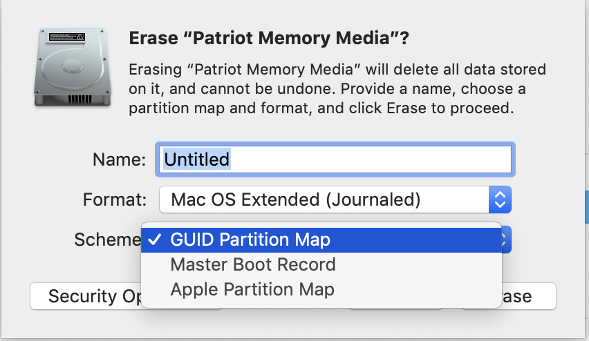

Go to the scheme dropdown and change it from MBR to GUID then the encrypted options will appear.
