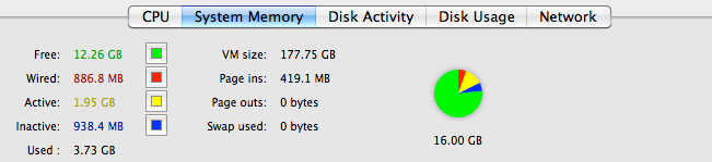

To know for sure if the OS is utilizing all of your RAM, check the Activity Monitor and it will tell you there. For example, I have a non-unibody MBP (pre-Santa Rosa) and it has 4GB in it, About This Mac shows 4GB, but Activity Monitor shows that the OS only recognizes and uses 3GB of that 4GB RAM.
P.S. The attached photo is of my iMac not my MBP I described.

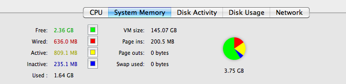

I booted into the 64 bit kernel but Activity Monitor is saying it's only using 3.75 of the 4 gigs I have installed in my early 2008 MBP.
I'm a little confused.
Don't be needlessly vexed. You have zero reason to boot into 64 bit kernel if you only have 4 GIGs of installed RAM. The question only comes into play if you have more than 32 GIGs installed. I advise you to go back to 32 bit kernel and enjoy fuss-free operations.
Most likely that unavailable 256MB is the shared memory used for your graphics card.
It's because of memory overlap...
The MacBook Pro Core 2 Duo presumably uses Intel's 945PM chipset, which can physically handle 4 GB of DDR2 RAM. However, a number of items must be stored in physical RAM space, and when RAM reaches 4 GB, there is some overlap.
In other words, in a 3 GB RAM configuration, there is no overlap with the memory ranges required for certain system functions. Between 3 GB and 4 GB, however, system memory attempts to occupy space that is already assigned to these functions. For instance, the PCI Express RAM allocation occurs at somewhere around 3.5 GB of RAM and requires 256 MB of RAM. Thus, the virtual space between 3.5 GB of RAM and 3.75 GB of RAM is occupied by PCI Express data. So in a system with 3 GB of RAM, nothing is being wasted because the memory space required by PCI Express is still between 3.5 and 3.75 GB, and the installed system RAM does not violate this space.
The net result is that at least 3 GB of RAM should be fully accessible, while when 4 GB of RAM installed, ~700 MB of of the RAM is overlapping critical system functions, making it non-addressable by the system.
http://www.everymac.com/systems/app...ore-2-duo-3-gb-memory-limitation-details.html
Not possible. It's a MBP, and this is before the 13" and the days of 2 graphics cards. That model only has a discrete card, which has its own dedicated memory. On top of that, my MacBook has 6 GB RAM, and all 6 GB show up in the Activity Monitor, even though my GPU is stealing 144 MB RAM from the system.
