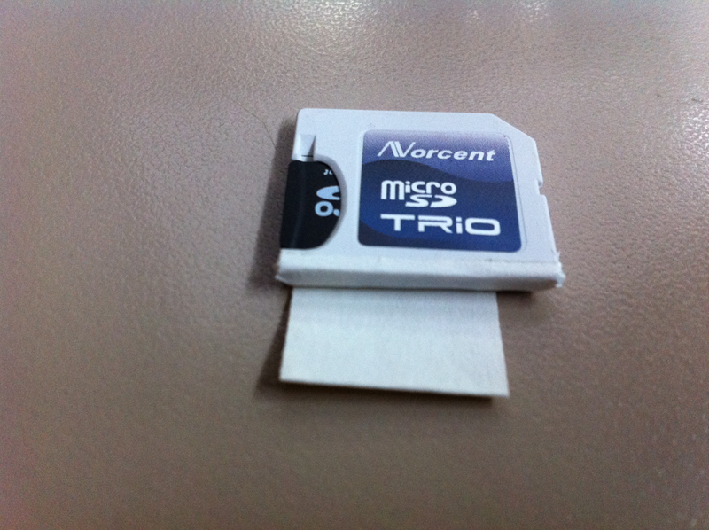

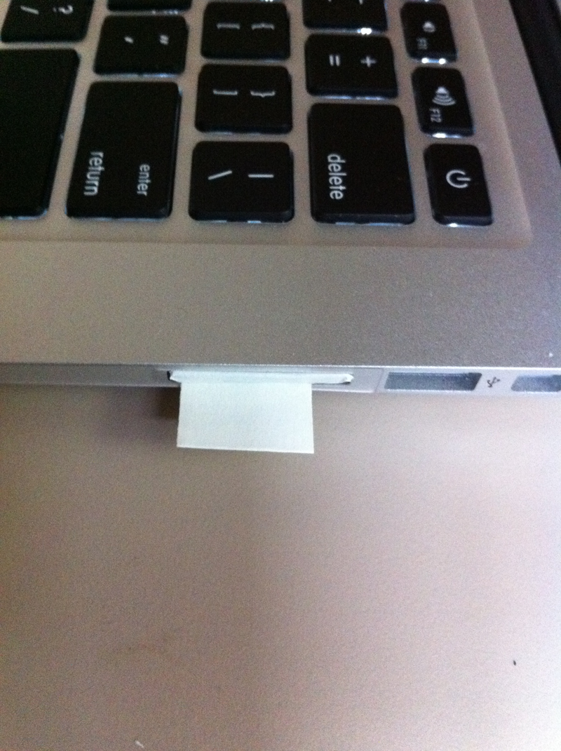

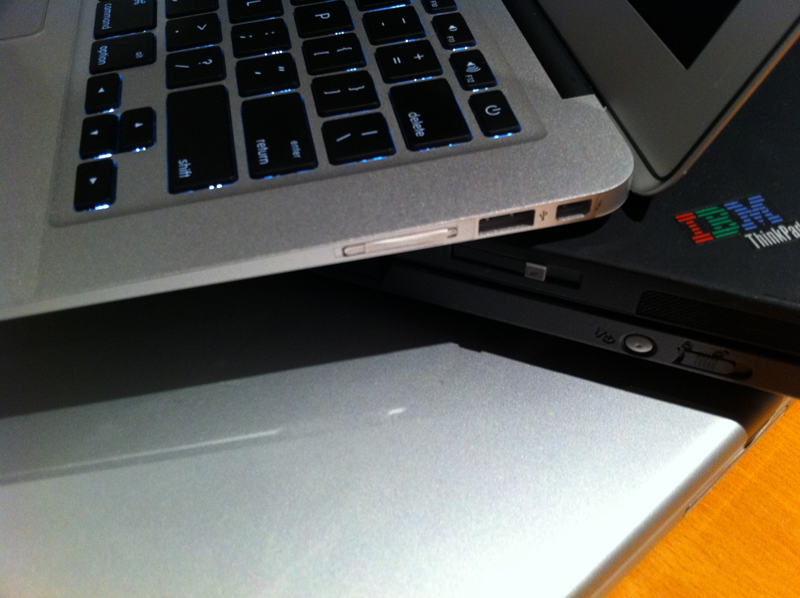

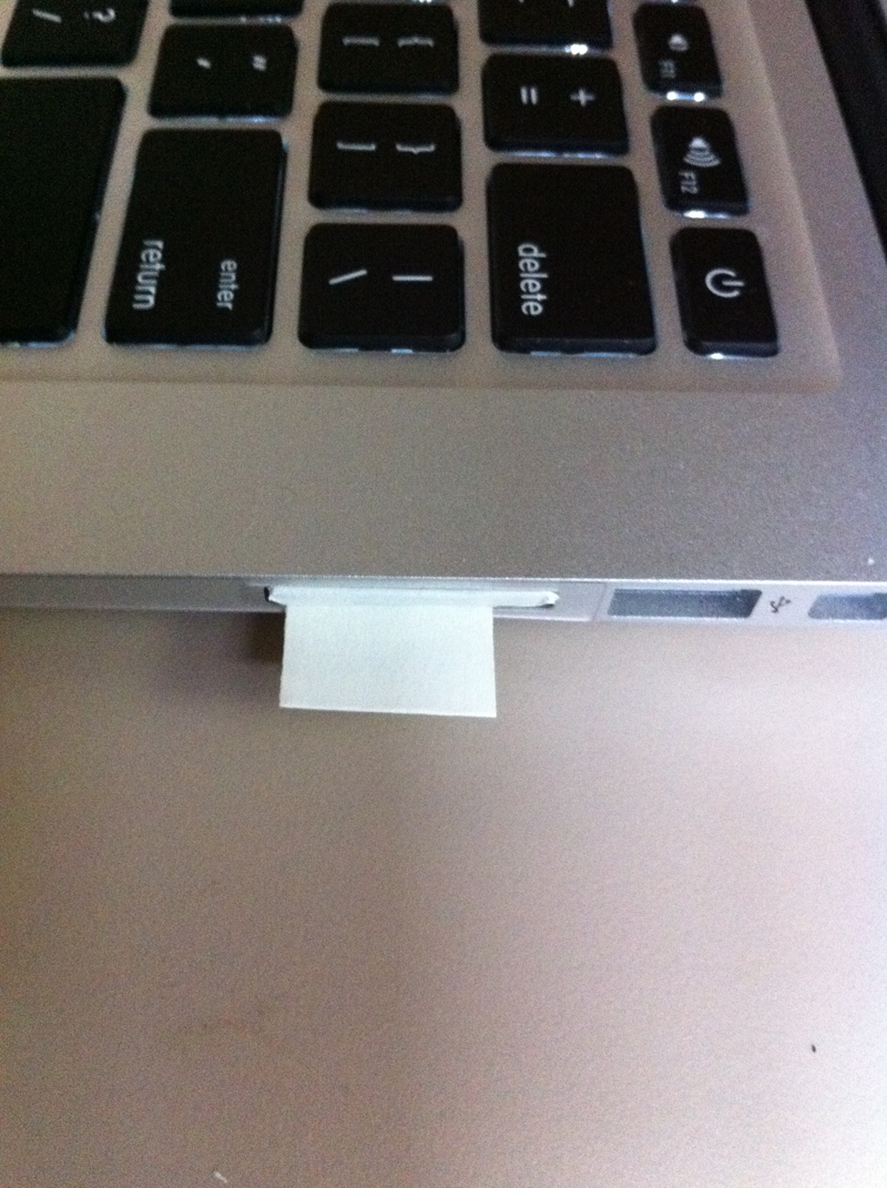

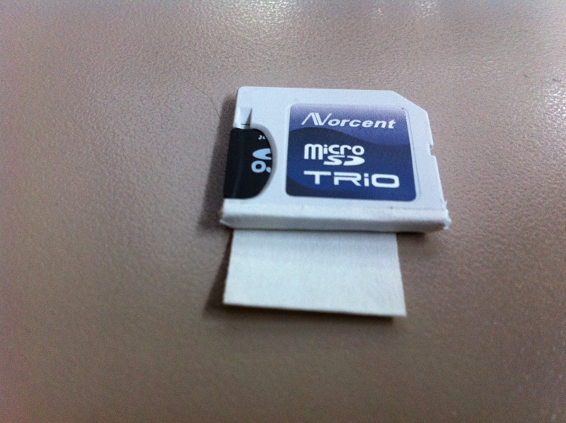

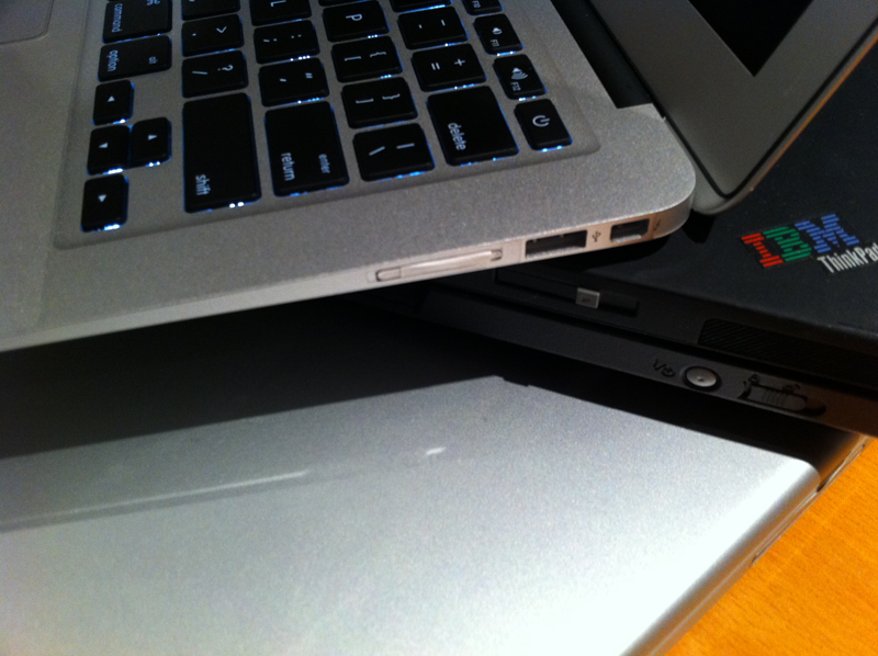

Thanks for this idea. Mine came in and here is what it looks like. I put a tab on it so I can pull it out if I have to. The tab in the pic was before I cut it down.
So now you have a piece of paper sticking out the side of your MBA??? What's the purpose of cutting the memory card down if you are going to have that eyesore?
Sorry, no it was there for when I was trying it out. I cut it down and when I insert it, I tuck it in. So you can't even tell it's there, sort of.

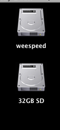

I have 32gb MicroSd in it. I have my itunes library there and also my pictures. I like it.

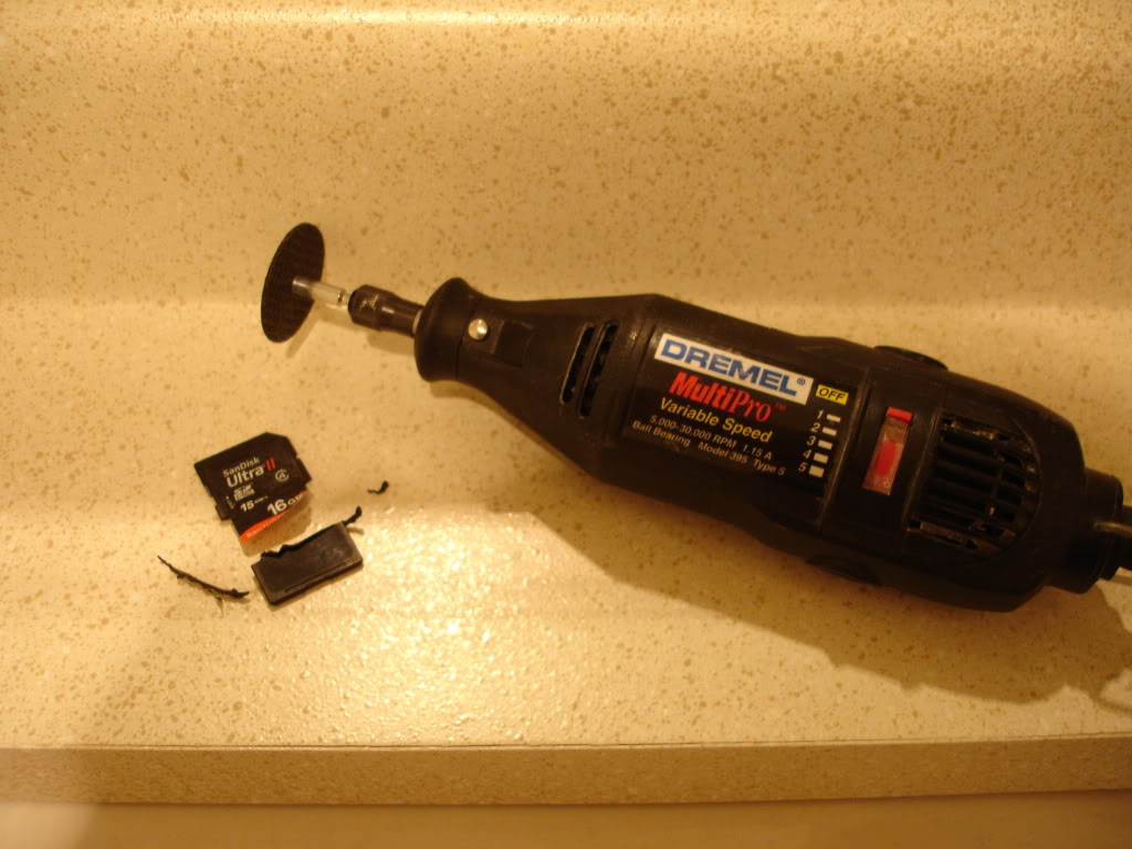

That pull tab is really smart, weespeed. You've convinced me to invest in that method now. How did you cut yours down so smoothly?
Thanks, but I give all the adulations to the OP. He thought of it, I just figured a pull tab would make it easy to remove if I have to.
I cut the adapter like the OP. I used good wire cutters but I'm sure some good scissors would work good too. Then I ran it along a file until it was even.
There is a circuit board and chips in there, so I used some 3m masking tape and cut it down to cover the exposed circuit. See OP first picture. The black area in his/her picture is the exposed circuit board.
Then I folded some of the masking tape and left part of the sticky side exposed. Cut it to match the adapter and stuck it on.
When I insert the adapter, I fold the tab in and it fits snug in there. It does make it really easy to remove.
Yeah, props to OP for the great idea in the first place.

There was another topic on here that said to get a Micro SD / USB / SD card adapter and cut the USB half off and it would fit flush and use a Micro SD card with it.
I made one of these in a similar fashion:
I used a $4.30 shipped adapter from ebay "MicroSD/TF to SD USB". I took some care in dissecting it, turns out most of the circuitry is inside the USB connector, so with an sharp knife (exacto, or box cutter) you can cut most of the guts out. There ware a few surface mount components (resistors or capacitors) left visible inside the hole. I picked them out with the knife for completeness sake. Finally, I used a bit of scrap plastic and a file to fashion a "plug" for the hole left where the USB connector and circuitry used to be. A little CA glue and some filing and a tape tab similar to above, and good to go!
