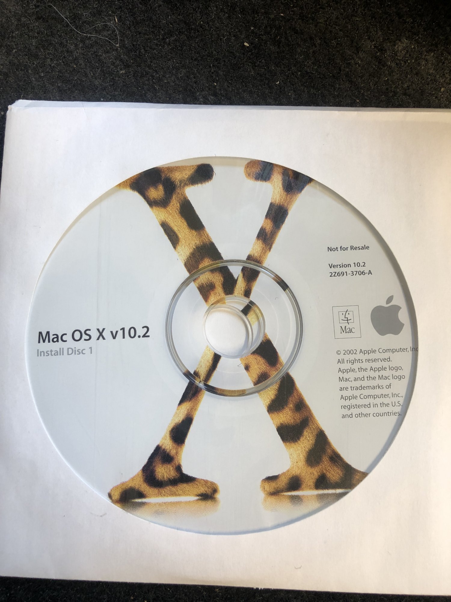

I have read through many messages and it seems you need the discs to complete a factory reset. I do not have the originals, so can I complete this task through the internet?
I do have Mac OSX 10.2 dics and I thought I could use them and just do a complete reinstall, but it kicks the dics back out. Is there another method, or am I going to have to try and fine the 10.4.11 discs.
Thank you, JR

Inserting the 10.2 disc - then shutting the machine down.
Then restarting the machine (with the install disc still in).
(If it kicks out, push it back in.)
BUT, holding down the Option key as you restart, until the boot picker screen appears.
Then, selecting the 10.2 disc as the startup device.
If that works then you can possibly install 10.2.
Or download a copy of 10.4.6 and burn an install disc from that.
Which you could then attempt the above steps with as well.
If this works not, post back for other methods.

Thank you very much for the advice. I tried the above, but for some reason it keeps ejecting the disc, strange as I have used it before. Do you know where to download 10.4.6 and I can try it.

And sometimes… a very light, delicate cleaning / wipe down of the Jaguar (10.2) install disc with windex (etc.). Can make a world of difference.
And if that fails, there’s always the old open firmware route
Of course, you've also tried cold booting with the disc in... and holding down the "c" key at boot?

I wonder if the elderly imac g4 disk drive's optical eye needs to be cleaned or if the drive itself is malfunctioning? If that were true, additional potential options include
1.) Install from an external usb2.0 DVD drive if you have one
2.) Use a external usb2.0 cd/dvd drive to burn new Tiger media if the 10.2 disk is damaged
3.) If you have another firewire400 PowerPC mac & cable around, you can use target disk mode to utilize the host mac dvd drive to install to the target mac
4.) Using TDM, Restore to the target mac hdd via disk utility using the Tiger disk image downloaded from macintosh garden
