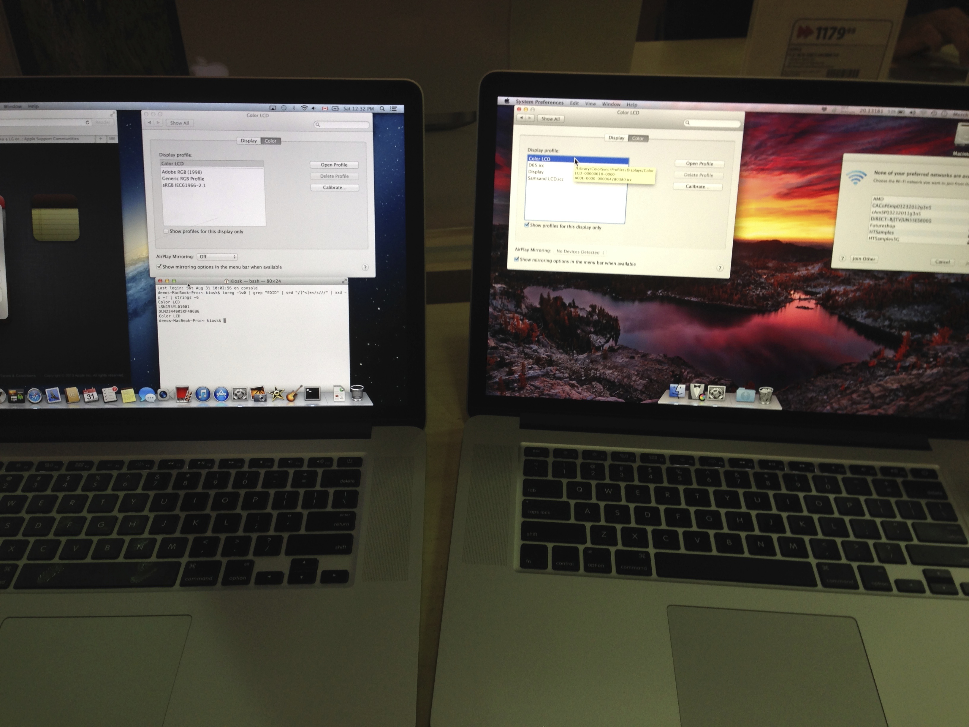

Here's mine.
Edit: To be clear, mine is the display on the right, the yellow one. The display on the left is an in-store unit.
Did you use the same profile as the OP? If not, could you share yours, please?
I've tried all the ICC profiles I've seen people post around the Internet. None of them help. I bought a Spyder4Elite colour calibrator. That didn't help. It just makes the screen purplish-yellowish. You want the ICC profile I made with the Spyder4Elite? It won't help. I don't even use it. I just use the default colour profile and turn up the native white point up past 8000 K.
But anyway, here's an ICC file I made with the Spyder4Elite I bought for 200 bucks to try to solve the problem that Apple refuses to help me with. Put it in ~/Library/ColorSync/Profiles . It won't help though.
http://merchv.com/Apple/Spyder4-Apple-Color-LCD-1.icc
Edit: I hope you didn't think my display was the nice one on the left. That's a store unit. My display is the yellow one on the right.
Oh ok. Thought both were yours and you were making a comparison. I am using the profile that's available on this same thread and have been really happy with it since. I was just curious to test yours.. did it and, you're right, purple all around.

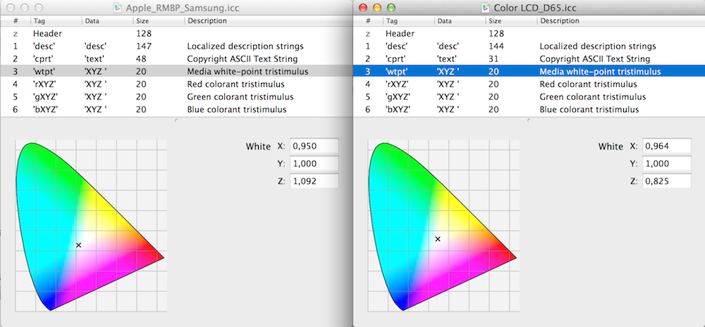

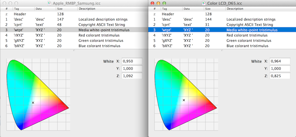

Calibrated Color profile for rMBP with Samsung display:
https://www.dropbox.com/s/l96oz5mqr8jboxo/Apple_RMBP_Samsung
Your profile has just one small glitch: because it doesn't contain the 'mmod' tag specifying that this profile is Apple Display specific, Color Preference pane does hide this profile if you check the Show profiles for this display only checkbox.

PS After I calibrated my display with a colorimeter, it appeared that the Apple_RMBP_Samsung.icc is slightly blue for my display.
