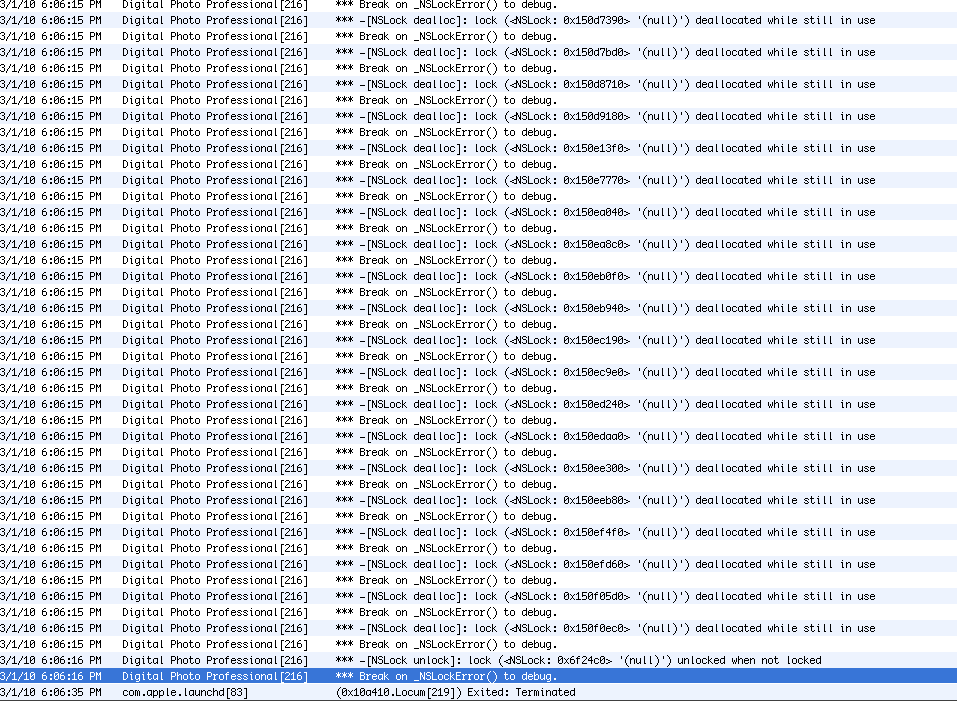

Does this tell you anything?
(click to enlarge)
Not on its own, but that's what Google is for. I used the error as a search piece and turned up others with the problem. Here's one from a guy, but the problem remedied itself, potentially from an Apple update. Here's a discussion on another forum, though no solution. And yet another one. Seems like the Canon software was not well tested before release. Have you tried the Canon site to see if there are any updates?
