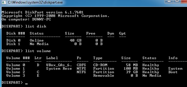

but I already tried that and it still doesn't show up, I tried everything there is online when the drive unmounted improperly it set it's status to No Media and though it shows up on windows using Diskpart I can't change the No Media Status of the drive. I downloaded every program known to the internet for windows that deals with Recovery and Partitions but none them will show or access the USB 3.0 Hard Drive in it's No Media State even though it is properly connected and I own Disk Drill Pro but it won't even do nothing.. I even tried booting into getparted but it wouldn't show up there either and I attached the USB Drive to Windows98 in Virtualbox on my Mac and ran Fdisk but it still doesn't show up.

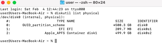

Try from Terminal
Code:
diskutil list physical
and post a screenshot.

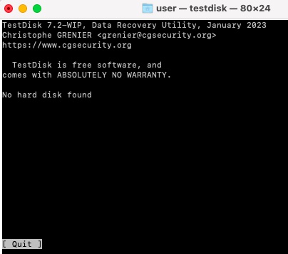

You can also try TestDisk https://www.cgsecurity.org/wiki/TestDisk_Download
“TestDisk Step By Step” https://www.cgsecurity.org/wiki/TestDisk_Step_By_Step
Thank you, I did try that in the Terminal but it still doesn't show My USB Drive, and I tried Testdisk but it doesn't find anything either. Here are some screen shots.

Disk 1 and Volume 3 is it but I can't format it, Partition it, or Change the Volume using DiskPart.

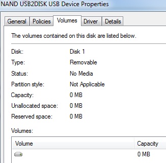

That is what it say's in Windows Device Manger.
Terminal not listing it.
Testdisk saying nothing was found.

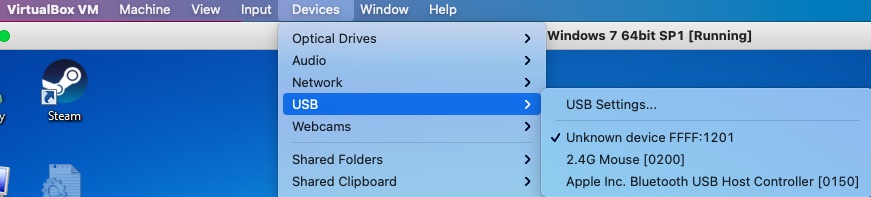

Also I tested this all on the same Computer running Virtualbox on my Mac with Windows 7, it shows up under USB devices in Virtualbox.
Unknown device FFFF:1201

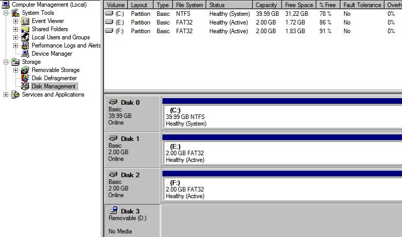

Maybe those help. I can't figure it out, in the attachment that is from Windows XP where I have other Virtual Hard Drives installed so it's listed there as Disk 3 in the Disk Manager.

What model is this drive? It could be that the enclosure failed. Looks sketchy nonetheless especially with a name like "USB2DISK"
I don't really know all the box say's is External Hard Disk USB 3.0, then on the drive it just has USB 3.0. I ordered it from a U. S. Seller but it still say's Made In China. There is no Manual.
Say's it's driverless except on Windows 10.
