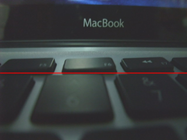

So I got the 2.4 macbook last week and exchanged it because the trackpad was loose and the keyboard had a flex on the left side. Anyway I got a new one and everything was perfect on it except for one thing.
The top function keys were slanted to left from the esc key to F3 and then to right from F4 to F9 and then back down to left from there to the eject button. I did not want to take it back for just that reason because everything else on it was great, so I took a stiff piece of paper ( a junk mail ad ) and tore off a corner and put it underneath the opposite side of the slant and flexed it back slowly and held it there for 30 seconds or so and it WORKED! 😀 I am not so happy it came like that, because of what I paid for it but it was an easy fix and I am completely happy with this notebook.

yeah just lift the OPPOSITE side of where it is slanting
let's say it's slanted and leans down like this:
well put the piece of cardboard paper or stiff paper \ <--- under this side and lift up to even the key out
you may have to hold the key down from the other side with one finger to prevent it form popping clean off and flying across the room 🙂 happened to me haha

I had the slanted function keys but fixed it by holding a stiff piece of paper(from a macworld magazinecover, irony 🙂) under the left side of the keys while adding pressure to the right side for about 30 seconds on every key. I had to repeat this about 4-5 times, BE VERY CAREFUL! But in the end it worked great.

tried it ..
wasnt very successful. after i take the paper out, they key just goes back on the slant. :-/
helllppp appleee.
Like I said, be careful and patient, it has to be repeated. My keys havent popped back yet.

I don't know if this is too late, but I had no problems with my BTO 2.8ghz, 7200 rpm hd MBP except for the left command key being slanted. I figured the key would come off like they usually do, so I took a credit card and slid it under the slanted side- the lower side. With a little pressure they pop off. I then put it back on using equal finger pressure and it went right back on. Problem solved, no messing with Apple support.
