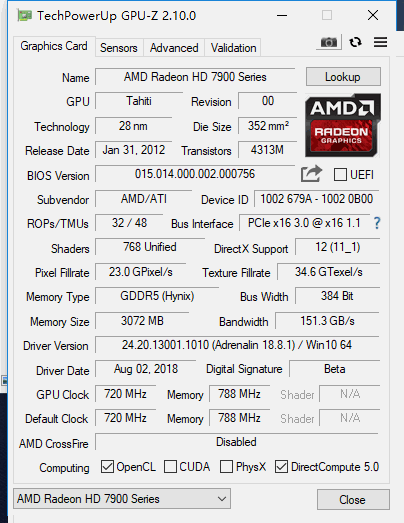

I have e AMD HD 7950 3g ,how to Flashing the HD 7950??

Thank you very much, I am novice, I don’t even know what software to use.
How to convert your original rom to an EFI
Thank you, I have succeeded, but windows10 can't enter.
[doublepost=1535026773][/doublepost]
Thank you for the link provided, I seem to have succeeded.but windows10 can't enter.

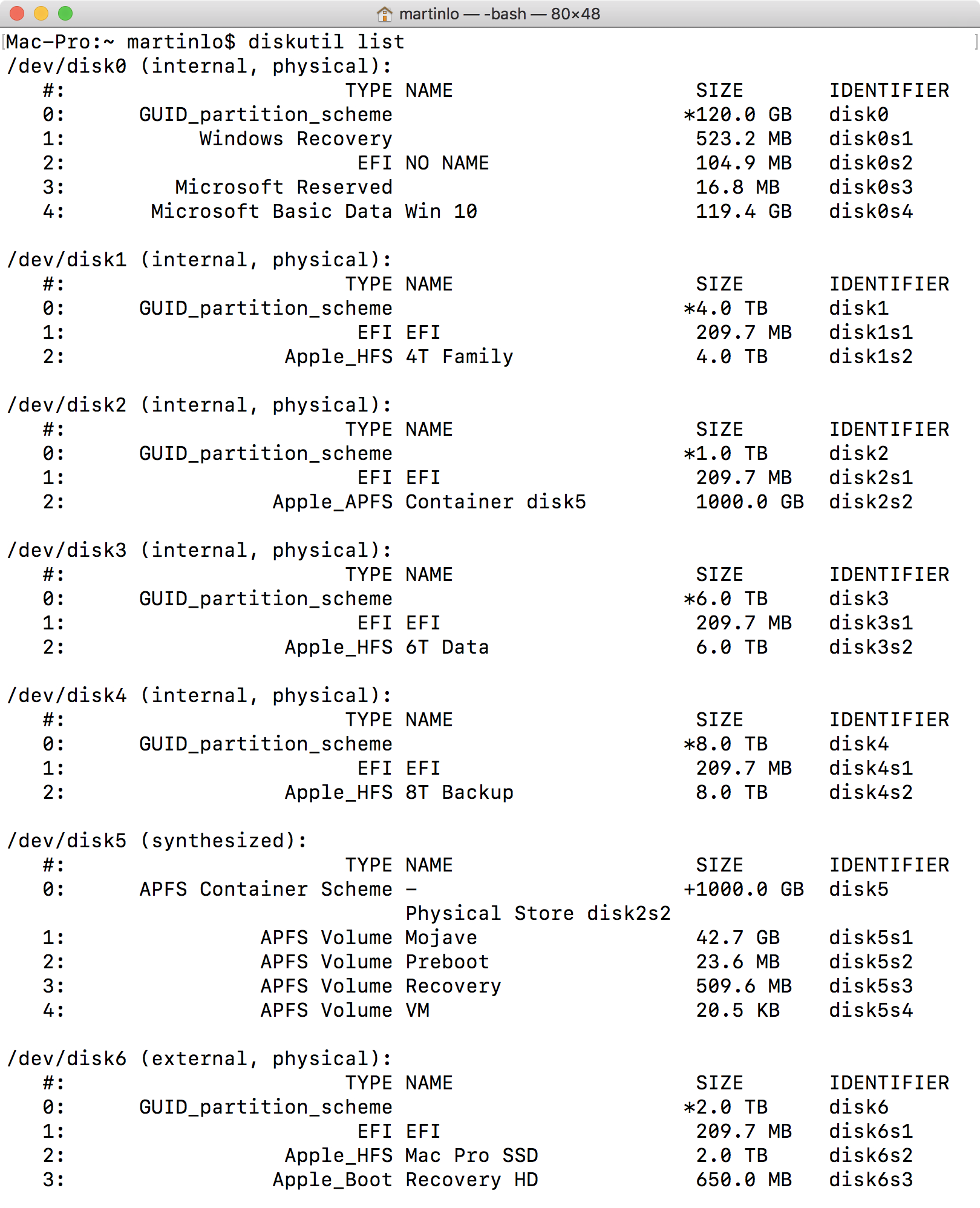

If you don't mind, can you open Terminal, enter
Code:
diskutil list
And post the result here?
It should look something like this.
