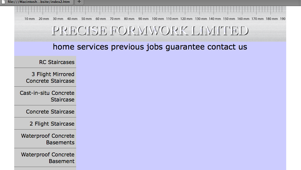

Thanks to everyone on this brillian forum I've got my logo centre'd as the "masterhead".
I've just constructed my "sidebar" and looks pretty sexy, only when I go to float it to the right I loose my light blue background 😕. How can I keep my background, I've tried clear:both.
Also my navbar at the top; It is constructed by an <ul> and I want it to align it by justify text so it fits perfectly spaced out to the size of the ruler (and container 900px I think).
Any help well appreciated.😀

Is there a reason you cannot apply the light blue to your ul/li items? Oh, and did you mean float it left, rather than right?
An idea for your nav; 900 / 6 nav items = 150px. Make your li items in the nav 150px wide each. That's one approach. Using text-align: justify wouldn't work as there's only one line. Think about when justify is applied to a single line of text, it doesn't stretch the text all the way across.

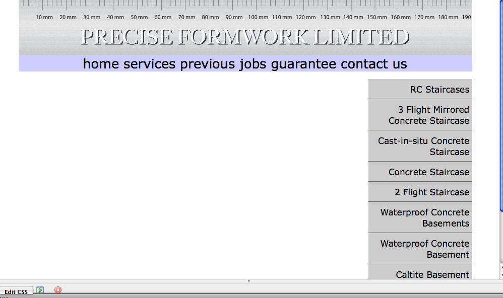

This is what happens when I float my sidebar right. I quite like the grey side bar and was hoping to keep it.
I'm trying to learn how things are laid out with coding, as you can see I'm struggling 😛.
So rewarding when it goes good though.😀 My book did tell me to beware of floats and they really do go weird; don't understand them yet.

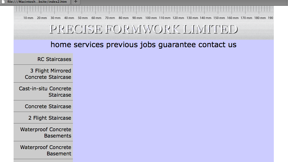

I don't drink alcohol so I'll pass on the beer. Your problem description and the attached image were showing different things, which led me down the wrong path. A common technique to handle this situation is to add an empty div after the navigation and give it a class of clear and then in the CSS have it clear:both. It's not wonderful in terms of semantic HTML, but is an easy route. Often you'll have other content that you can apply the clear to (if need be) so the background fills naturally, such as the footer section. It'll partly depend on how you layout the entire page content and all.
