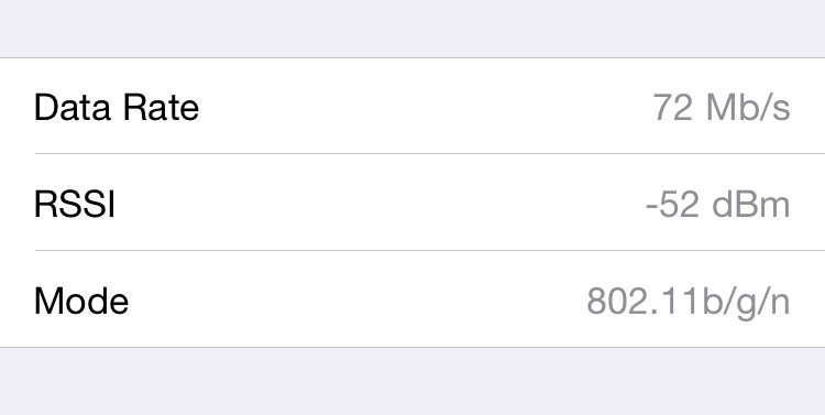

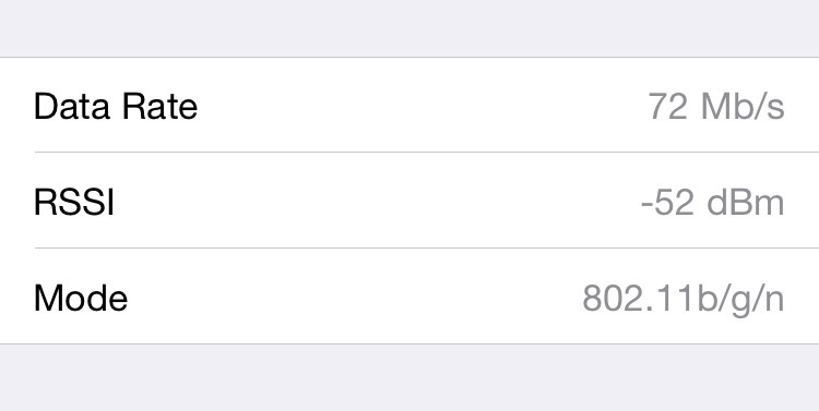

The AC thing ain't working man! I'm not speaking of internet speed, I'm merely talking of N/AC technology, look unto the screenshot! It's my iPhone 6 and I'm standing before the freakin' APE and ain't working!! Grrrrr
Where are you getting this info off your iPhone?
Ah? My iPhone! AirPort Utilily!! Duh...
Hmm... apparently the version of AirPort Utility on my iPhone doesn't show this data. However, I can get it from AirPort Utility on my Mac for my iPhone. See attached. As you can see my iPhone is connecting at the higher data rate so it does work. I'm thinking you have some configuration settings that are not quite right. Especially since the mode in your screenshot is b/g/n instead of a/n/ac.
