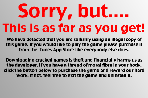

Forget the going to a web page lol, if people are using a pirated copy of my apps they see the attached screenshot 😀 (obviously we place the button on with code, hence why its not in the picture...)
We let them go through the main menu etc to give them a taste of the game if they were to buy it then as soon as they try to actually start a new game, bam that pops up. I'm actually tempted to ask them if they would like to accept push notifications the first time the app launches and if its a cracked version I will have a script hound them on a daily basis until the app is uninstalled. If its a legit version I will use push to notify of other (more friendly) stuff

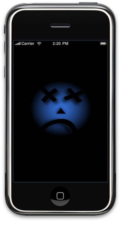

keeping in line with the OPs discussion. since the ability to force quit an app may change (has changed?), i'd just toss up an image instead of adding the viewController.view during applicationDidFinishLaunching. besides, quitting an app for a cracker is more polite than presenting a static image which they'll have to exit from themselves. attached is what i use for my own apps. also, images are ideal to avoid using strings such as "This Application Has Been Pirated", which can be located.
Yeah, I just put an image instead. The image says "Stop Pirating this App" or something like that. You said dont use something like that, why not?
an image of text will be fine, except for localization purposes... but i mean, who is really going to localize this type of message?
i've been reading about several methods which allow people to crack iPhone apps. the most prominent is to scan for string objects to either remove or change them rendering the anti-piracy method ineffective. so it seems you are at a greater risk if you use unencrypted string objects as they can be easily located.
