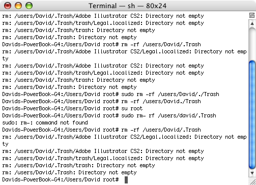

I tried all that and it's STILL not working. 😱 View attached thumbnail... am I doing it correctly?

Oh the problem, in the thumbnail is you are root you don't want to do ~/.Trash with root, if you're in your home folder /users/david then just type in ./Trash instead of ~/.Trash with root.
And it's STILL not working... I tried what you said. View thumbnail:
EDIT: never mind, same thing
EDIT2: The only way I can figure how to do it is reboot in single-user mode and remove it from /users/david/.Trash/
