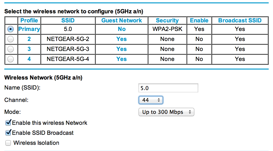

The following screenshot are the only wireless settings I can configure - Notice you cant choose between N or A.

Turns out someone else has encountered my problem with the same router. It is a bug with the current firmware - If I disable encryption it runs at full speed however with any form of encryption it switches to 54mbps 802.11a.
http://superuser.com/questions/371860/enabling-wifi-password-drops-network-into-802-11a-instead-of-n
I will downgrade my firmware to see if it fixes it!
Success!! Once I downgraded my router firmware it finally connects as 802.11n and not 802.11a! I now finally get the 300Mbps speeds netgear claimed!
