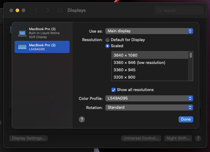

When I go to the Settings from the Monitor itself, I can set to 60Hz but regardless I don't get a 5120x1440 option from Mac's Display Settings.
