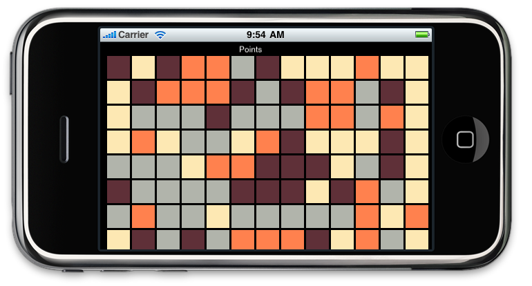

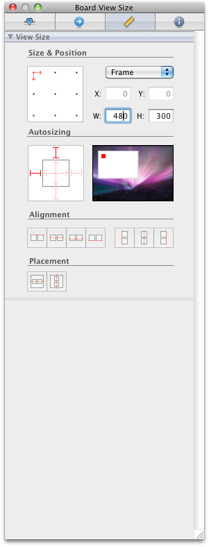

What I am trying to do is create some kind of bric-game (see attachement). The view which I am creating in Interface Builder is defined (by default) to a height of 300 in Interface Builder.

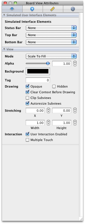

I want to be able to utilize the entire screen, without the status bar.
I assume that the status bar is stealing 20 px from me, which I want to use. How come it is still visible even though I am defining "none" for the status bar property (as well as for top and bottom bar, see attachements) in Interface Builder? How do I remove it in order for me to be able to use the entire screen? Couldn't find any info regarding this!
Anything else I have to think of in order to start using the entire screen?
Thanks!
/N

That setting in Interface Builder is to let you see what it would like like hidden: it has no actual effect outside of interface builder. You can hide the status bar programatically (so for example you could show it in your menu screen and only hide it when the actual game was running) using the well documented setStatusBarHidden:animated:. Or if you want it hidden right from launch then use the similarly well documented UIStatusBarHidden key/value pair in your Info.plist file.

Ooops, sorry for redundant information. We posted it at the same time. But the total answer is a bit more informative, thanks for now!
To define the status bar property is only a hint that it should be hidden. I don't understand why it isn't enough, feels like I am doing the same job twice now.
Notice how these things are called "Simulated Interface Elements"? So, they really are only intended to give you an idea of what your screen looks like if they are on. They are not meant to actually affect those parts of the UI. Hence the term "simulated" vs. "actual".
