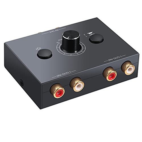

- You won't get HDMI audio back to your Mac this way.
- If you want to make use of the TV's digital/optical OUT, you need an optical (Toslink) to analog converter to feed your AMP or a Toslink-to-USB interface to feed it into your Mac
- I was talking about an analog switch: Input_1: your Mac's line out, Input_2: TV's analog line-out (or the analog signal of the Toslink-converter), Output: your AMP
(see attached example)
Your MacBook unfortunately only has optical OUT, not IN (Apple: "Support for audio line out (digital/analog)").
Maybe there is a way to split the HDMI cable and add a HDMI-USB-grabber but that seems dubious and expensive.
