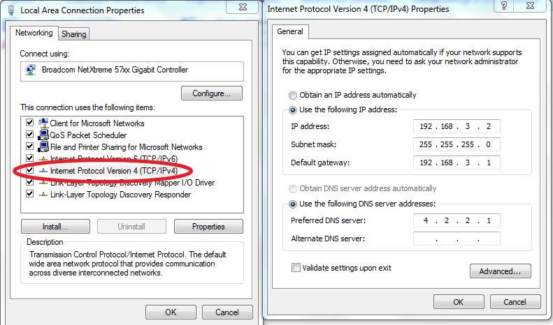

Well if I try to change the win7 settings again they are just going to revert back to a static IP once I try to go on the internet or anything. How do I make it so it stays the same all the time? Should I put the settings on both the general tab and alternate configuration tab on the TCP/IPv4 properties?

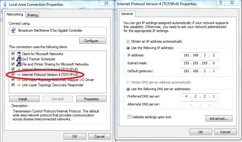

Please see attachment. Posting this from my Win 7 laptop through Airport. I got a meeting in 5mins. I will check in later.
Alright yep, thats exactly what I did, and every time after I push ok and try to log on to the internet, it reverts back to "obtain IP address automatically."
I will try it again but I don't know if it will do anything different.
Edit: As soon as I tried to get on the internet the settings changed back from what I had set them to be before. I don't know how yours is working and mine isn't but I guess there is nothing I can do.
