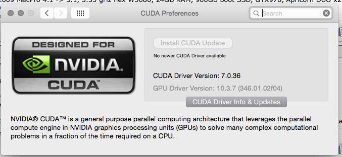

Check the Cuda Preference Pane to see which driver is running.
Note: When the Nvidia driver is selected, you should be directed to reboot for the driver to be activated.
Lou
Don't have CUDA loaded. I suppose I could, but not sure purpose it serves. This Mac Pro will mainly be for video and photo editing (Photoshop and FCPX).
Also, when I select the nVidia driver, it only prompts for password. No reboot. If I reselect OS X Default Display driver then it wants to reboot.
