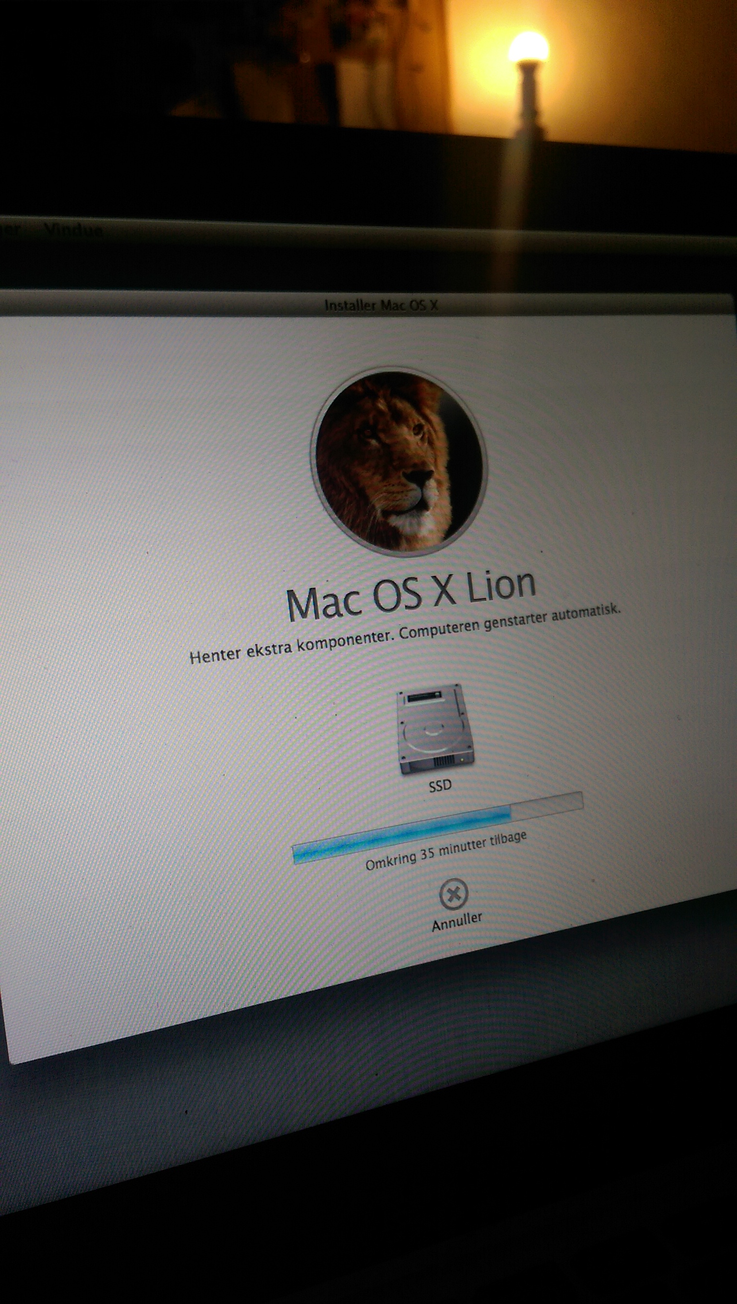

I do get the spinning globe and enters internet Recovery easily. But I wasn't able to install Lion (it didn't move for a few hours when saying 27 minutes remaining...)
I guess I'm gonna try making a USB with Yosemite installer and see if I can make it that way.
Okay, I seriously need help! The ssd seems totally fine, but I can't figure out how to get OS X installed on it. When I boot into Internet Recovery OS X Utilities says "Reinstall Mac OS X" and when I start that installation it says "downlaoding additional components". To me it seems like my machine might think an OS is already installed, since it doesn't just say "Install OS X" ???

Just to give you a feel for the time... it is downloading about 7GB of stuff to install the OS. So if you are on a slow connection, that can take a while.

Just woke up and unfortunately the process hasn't moved anywhere since I left it - starting to loose my patience :/
If it has actually now been 6 or 7 hours, that's a little long, I think.
Are you using a wireless connection? Plug in to ethernet, if possible, and try again.
Was using a wireless connection and it never came to an end. Decided to make a bootable flash drive installation, worked like a charm and now my MBP is faster than ever.
