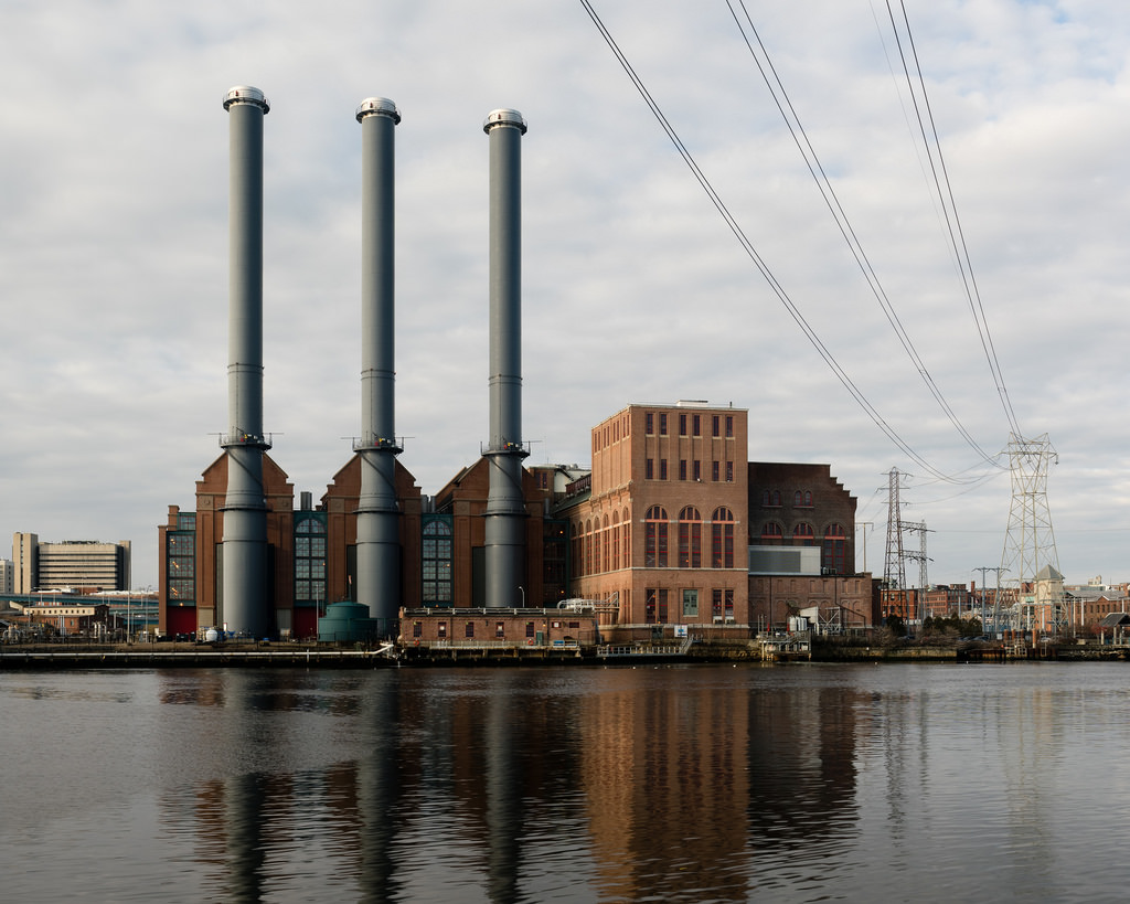

This was exposed for 2.5 seconds @ f/11 and ISO 64. I was using an ND filter, but can't remember the strength. There was relatively little wind that day, so there wasn't much chop on the water compared to "normal" days I've been there. Notice that the power lines (which were certainly subject to any wind) are still fairly crisp. Yes, this was only a 2.5 sec exposure and I have some longer ones (6 sec, 10 sec, 20 sec) of the same subject where the power lines are blurred, but the wind was also stronger for those shots and the water never became still enough to create this effect even with the much longer exposure times.

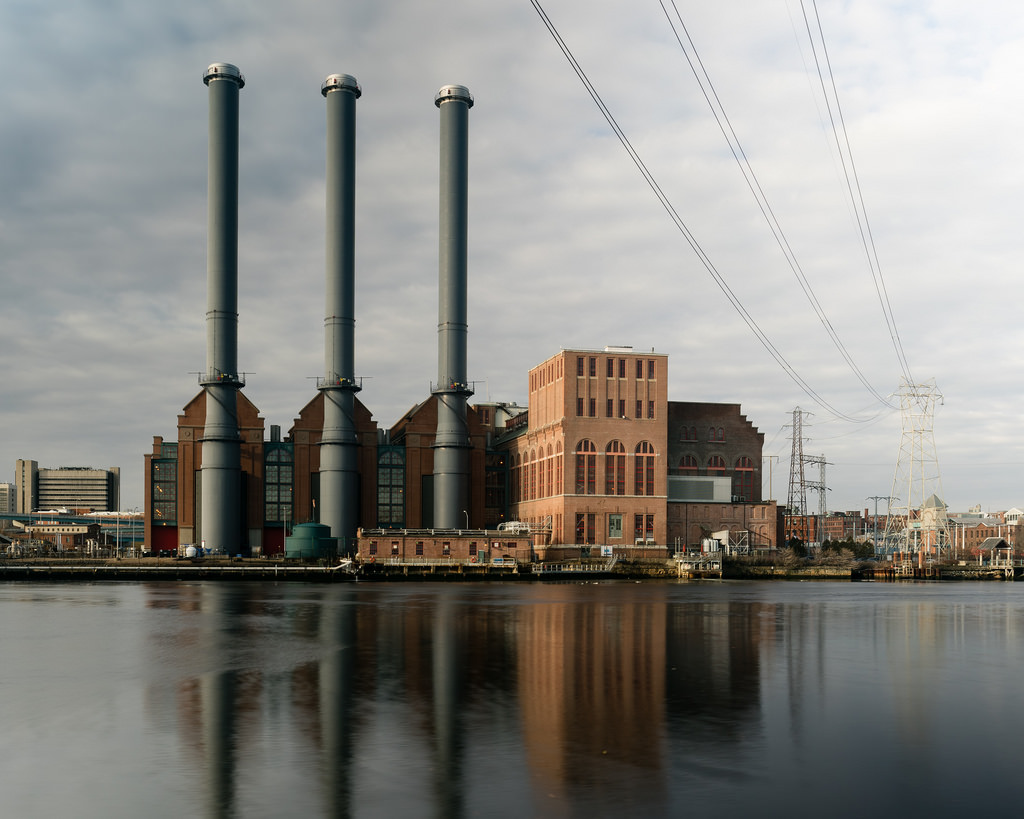

Thanks Kenoh 🙂. I don't think I posted the one above, instead posting this shot that was taken just after (minus the ND filter) exposed for 1/6 sec @ f/11 and ISO 64. The ND filter darkened the lower right corner as I had my TS lens shifted up to capture this and it didn't play well with the filter.
