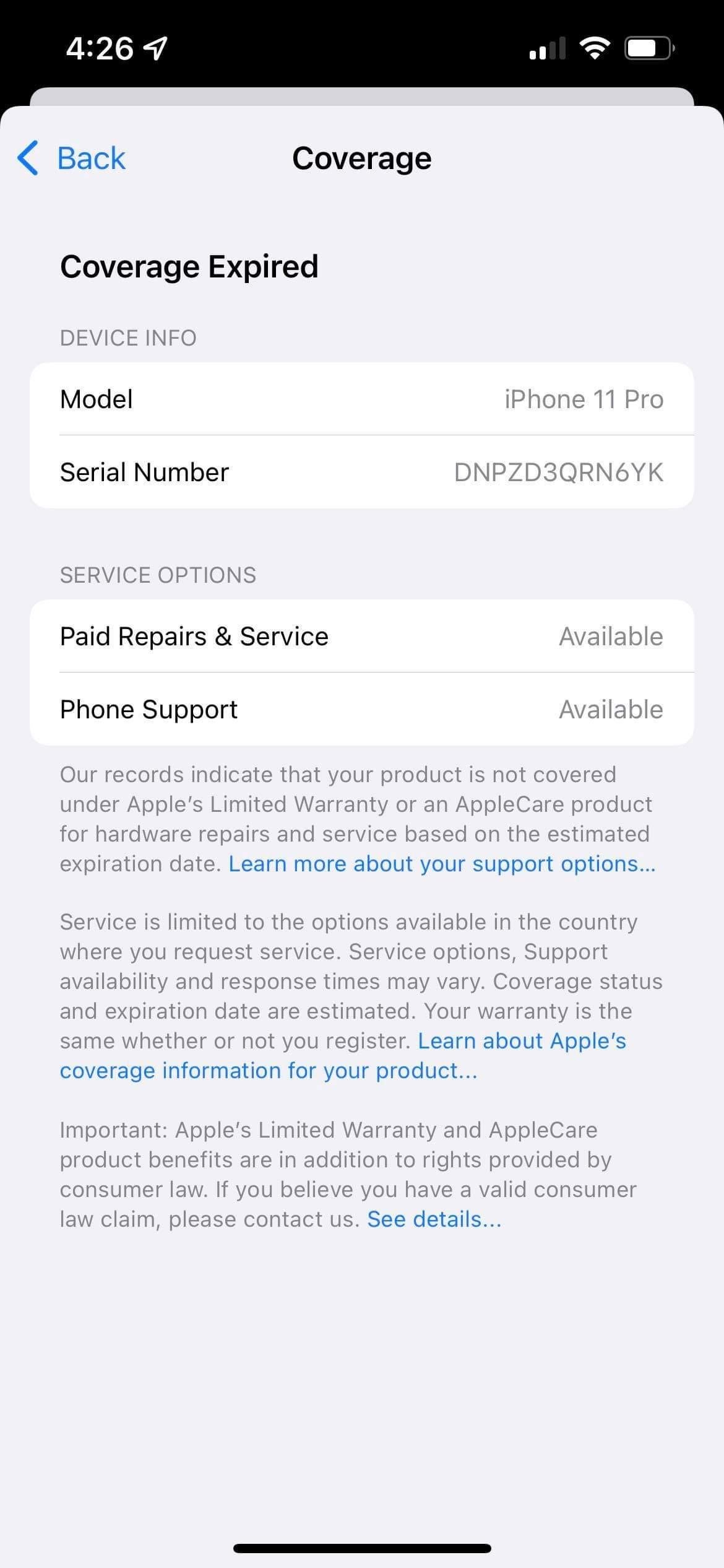

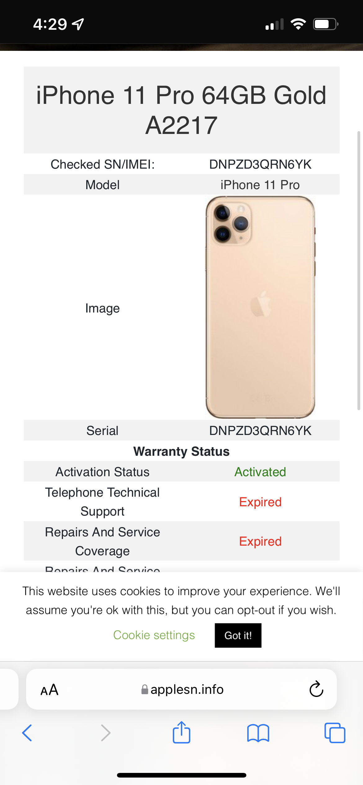

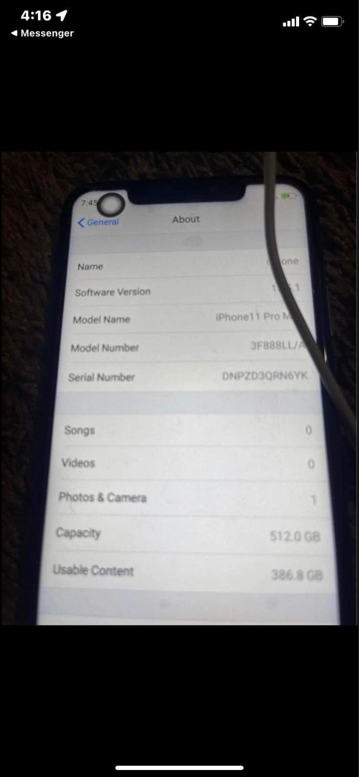

Somebody that I know purchased an “iphone 11 pro max”. I believe it to be a fake. When I run the serial number it comes back to an 11 pro, gold 64 gig. I ran the serial through apples AppleCare device app. This is a grey device they have. Also it shows 512 gigs of space and 380 gigs available with only 1 picture. No videos or songs or anything else on the device. There is no back swipe gesture so assistive touch is turned on. These aren’t the only discrepancies but this alone is enough to prove to me it’s a clone.
Here is a picture of the about section and me running the serial number through apple.
I’ve tried and tried to get them to believe me about it being a fake. But they just won’t believe me. Any ideas on how to get them to believe me? I’m only trying to help them out so they don’t have a bad experience with their first apple device and hate apple forever.
The first photo shows there is a space missing in the model name “iPhone11”. It could be fake or could be an iPhone with spoof serial number or not properly formatted name.
I would just send them the link below and have him paste the serial in there. (If you click on it, it will launch the Support app)
Great catch! Even I missed that lol
Send your friend that as proof. No device should have the same serial.
Thanks for finding that! Should be the nail in the coffin. It really does suck because she spent $700 on it. The good thing is. She got it from her brothers friend. I’m hoping her brother will stick up for her. And maybe she can get her cash back. I’m willing to bet he knew it was a fake and wanted to offload it on somebody else.

From the top picture alone, notice how the clock and the battery icons location were awkward asf.
This is the video comparing fake and real iPhone and the fake one has the same awkward battery placement at 12:50.
