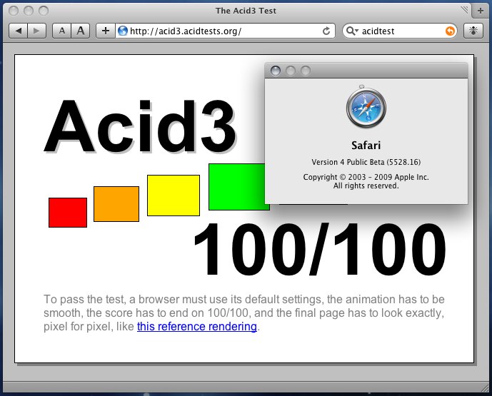

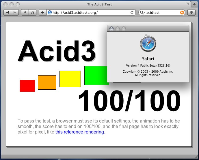

It seems to run fine, passes acidtest 3 with 100% so it should be using the new version of webkit installed with Safari 4 final and the new javascript engine, but I don't know how to test for that.
I one or two things though, it seems to run a bit slower than the final version and when I ran the both the beta and the final at the same time the beta wouldn't load topsites correctly or the history page. It worked fine when only the beta was running though.

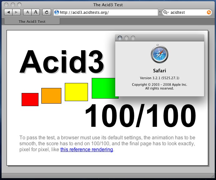

I found that this also works with the Safari.app from the last Safari 3 update.
You do lose Top Sites and coverflow in history though, but has the side benefit of disabling the Screenshots that Safari 4 takes of all the websites you visit.
I assume they are both using the updated javascript engine, but I'm not sure how to verify that, does anyone know?
