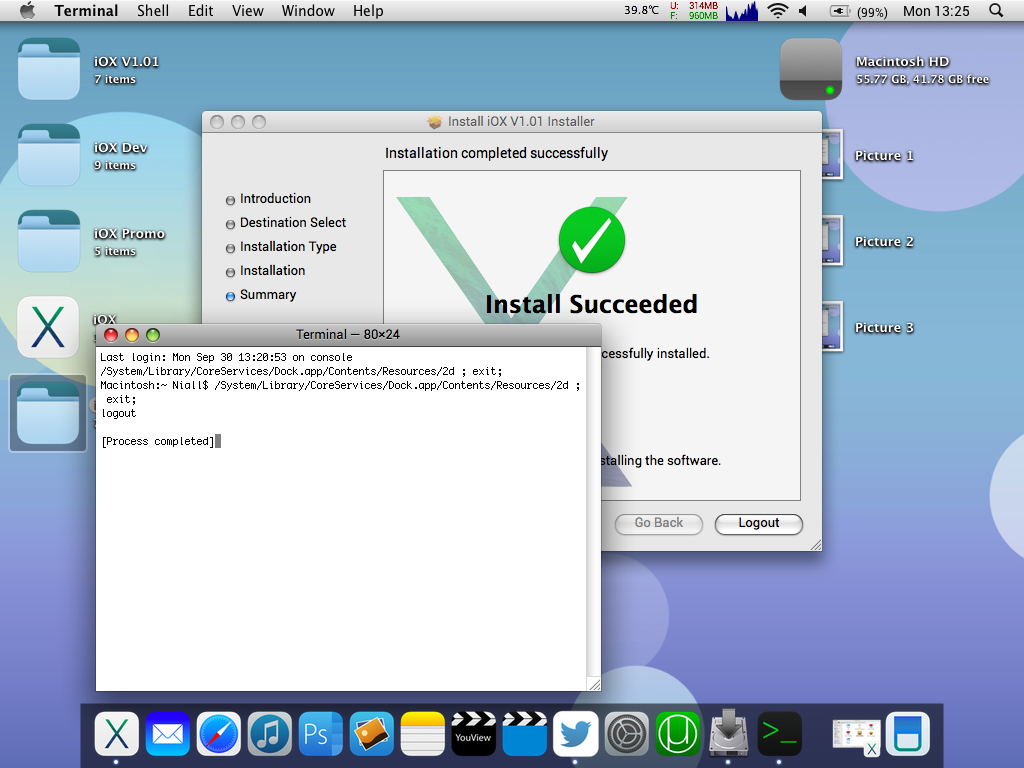

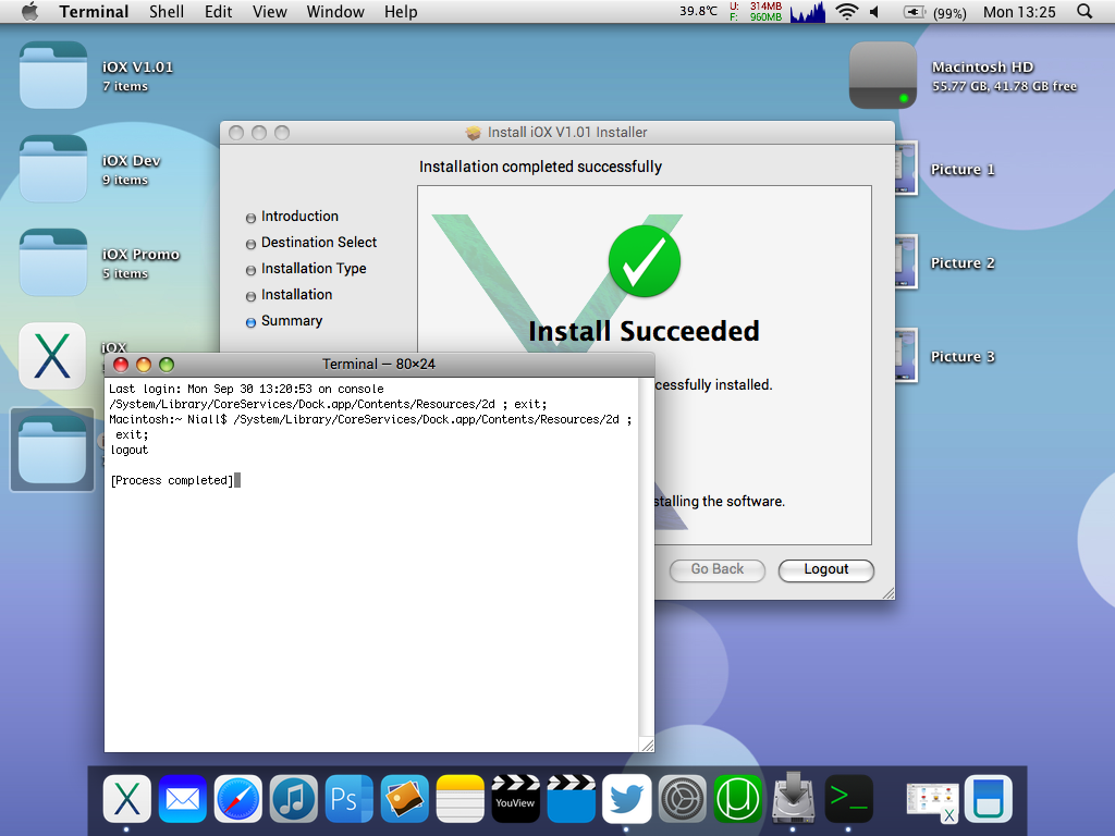

That's my mind playing tricks on me. I thought it cleaned up the directory but no, the pic above is just an instance is which I was using a short(er) directory than before. Forget I said that. It's no different to the .command - still opens up terminal and completest he process.
Video going through where the command is kept & how it acts in the installer.
Sorry, I'm not going to install Flash for that.
Please post descriptions and/or screenshots.

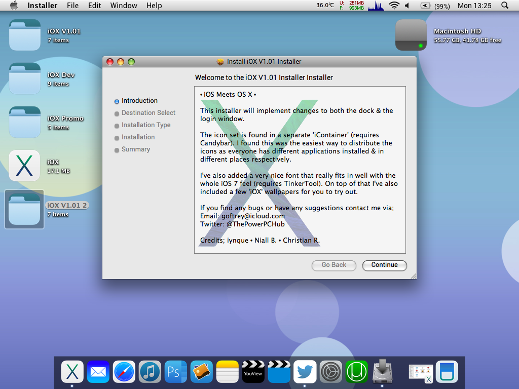

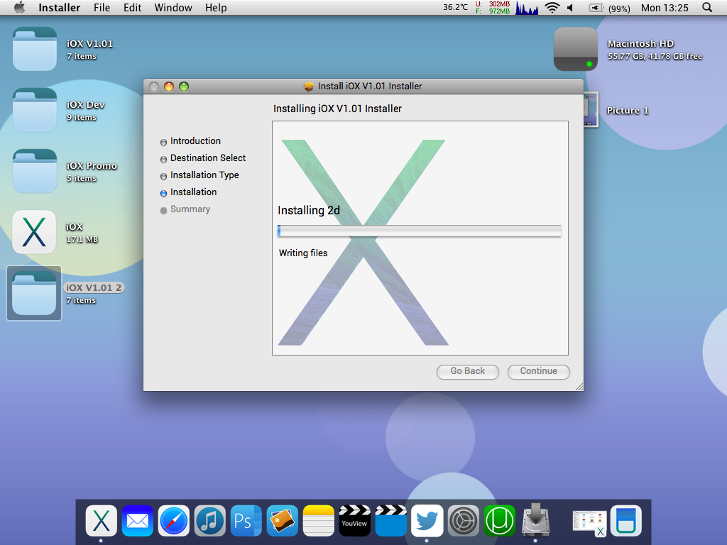

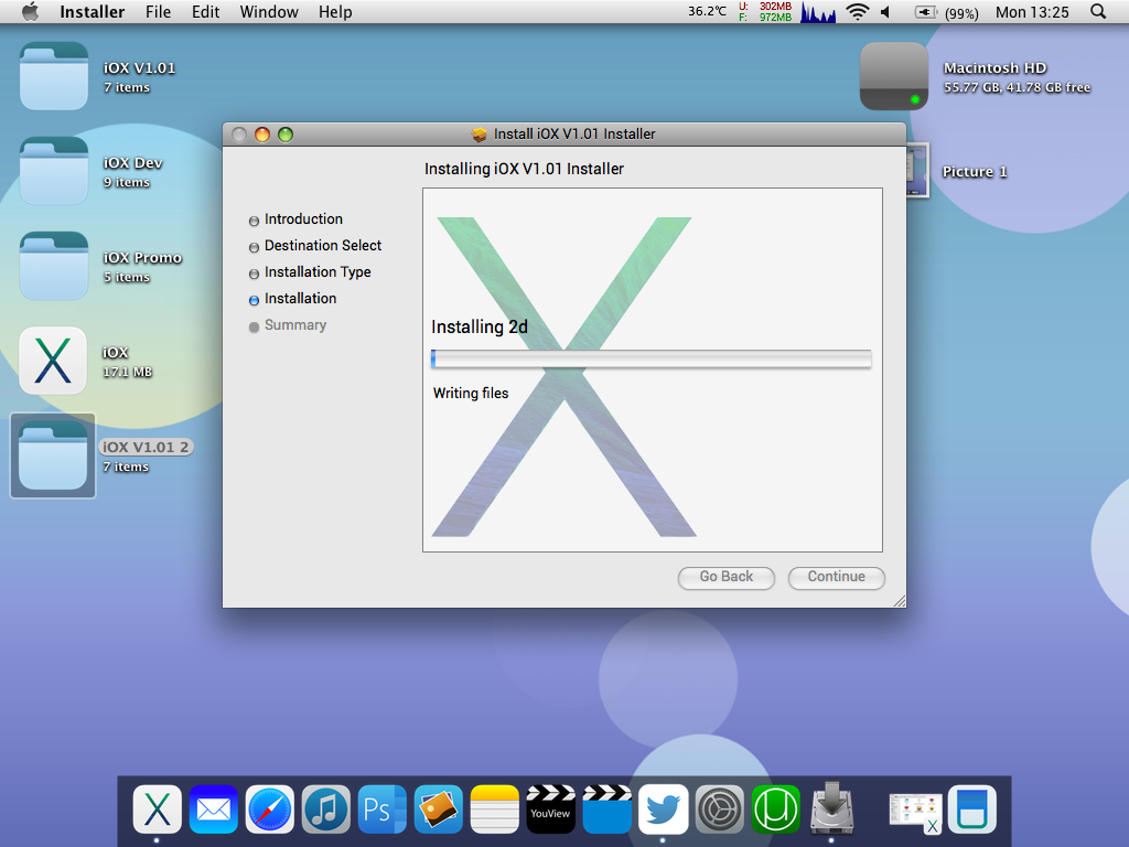

Screens: Before, during & post installation.
Those are Installer screenshots. I asked to see where the post-installer script is in PackageMaker. I need to see how you're making the .mpkg and exactly how the post-install script is being invoked (with PackageMaker). I don't need to see the result of running it (with Installer).
If this were just a shell script, I'm asking to post your code, not to see the results of running the code.
Have you tried to name the script "postinstall"? There seems to be specific names that packagemaker recognizes.
