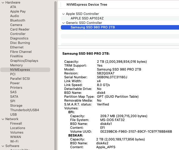

I doubt the firmware is the issue, but you can check what version you have. Go to System Report --> Hardware --> NVMExpress and find the drive. You can see in the Revision field I've got 5B2QGX7

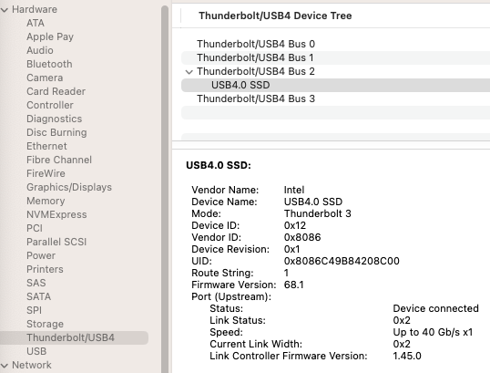

Also in System Report, go to the Thunderbolt/USB4 info and find your enclosure. See what speed it reports. Mine is up to 40 Gb/s:
