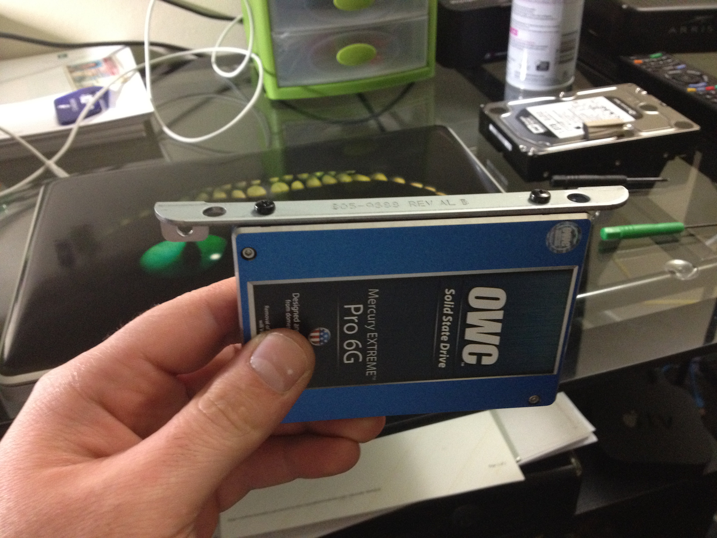

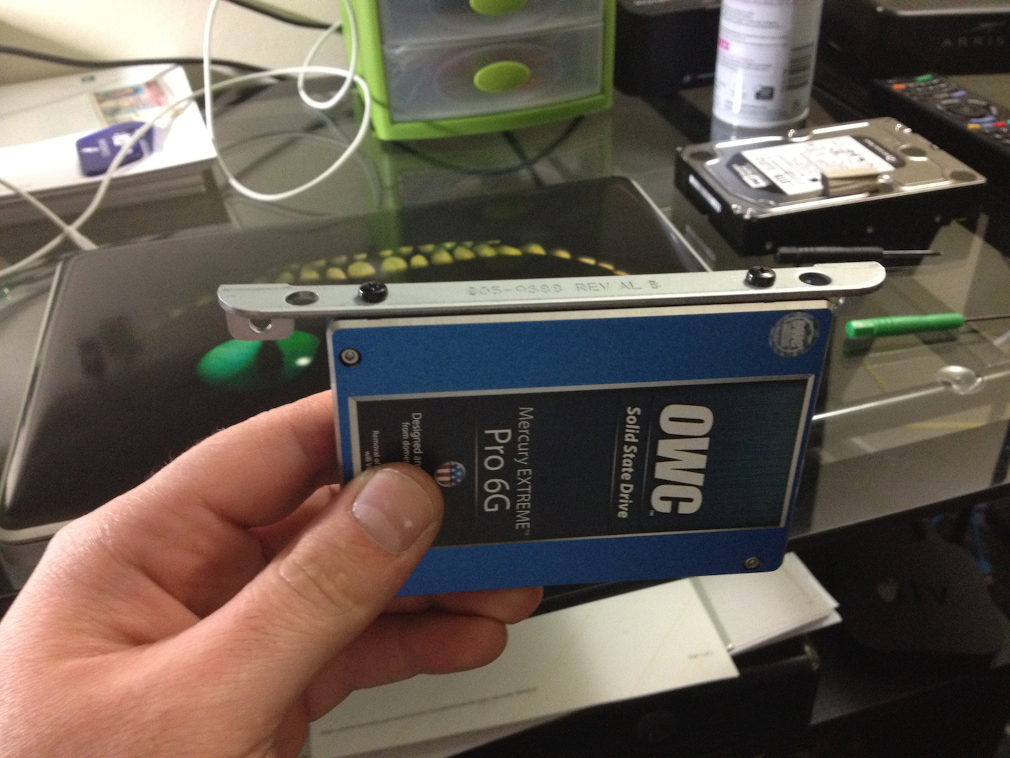

i just took my 3.5 drive out and made custom bracket from apples factory one for the owc ssd 6g hard drive.. i had a problem with the fan ramping up so i look all around and i found that company call hdd fan control had the fix so i bought it.. it does the job.. i just wish i new how one day..now I'm going to make a new bracket to but two ssd in the 3.5 slot..

Would you happen to have a guide on what you did to get two drives to use that mount? Or more pics of the final version? Also, did you just simply use the wires from the optical drive and not have to take the logic board out?

Hi bozzygti,
Did you manage to fit two SSDs into your iMac using a custom bracket? I plan on installing at least one SSD using a similar customized bracket as you pictured. I'd be interested to know if two fit within that bracket. I'm not a fan of installing a second SSD with double-sided tape.

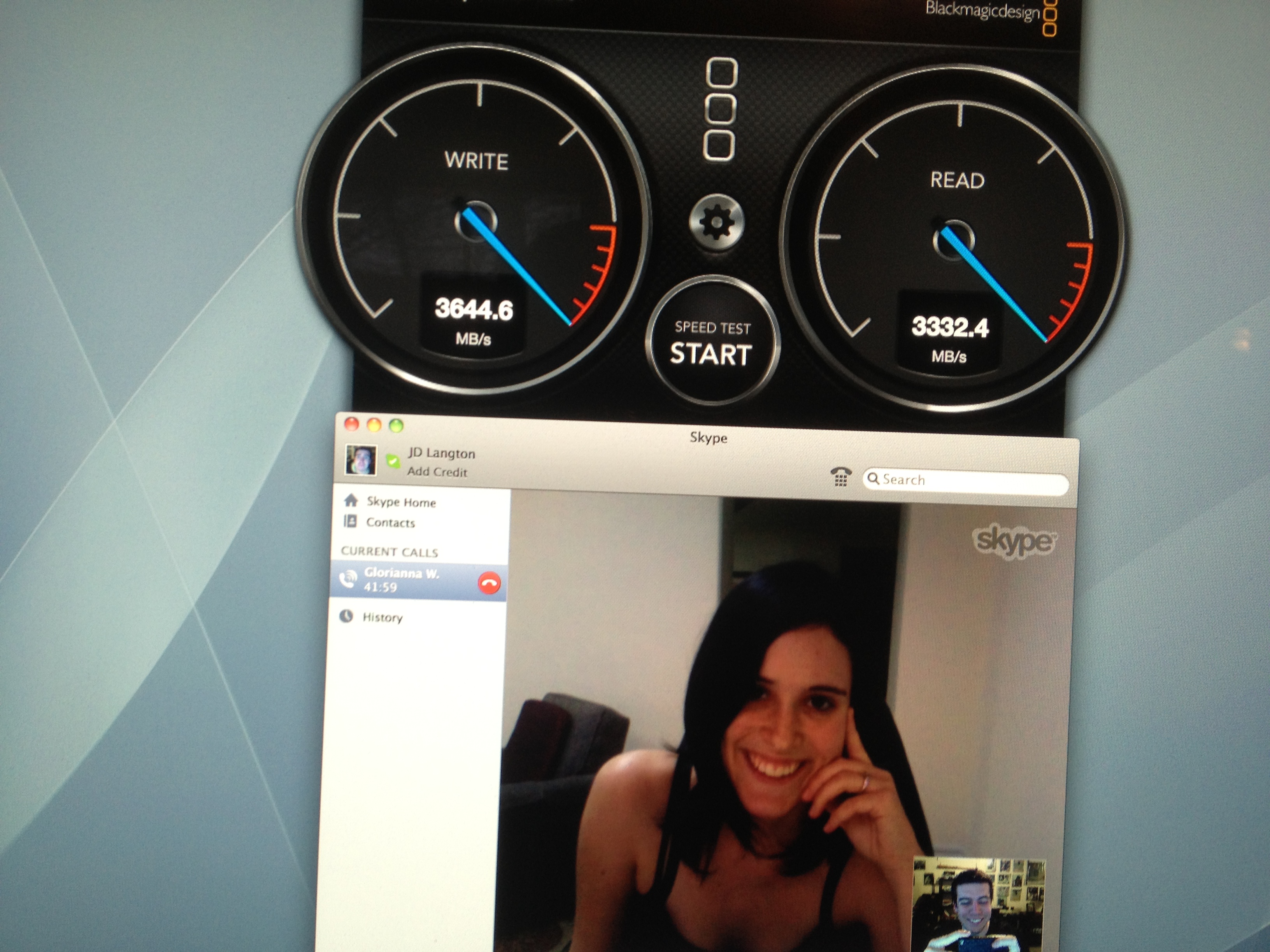

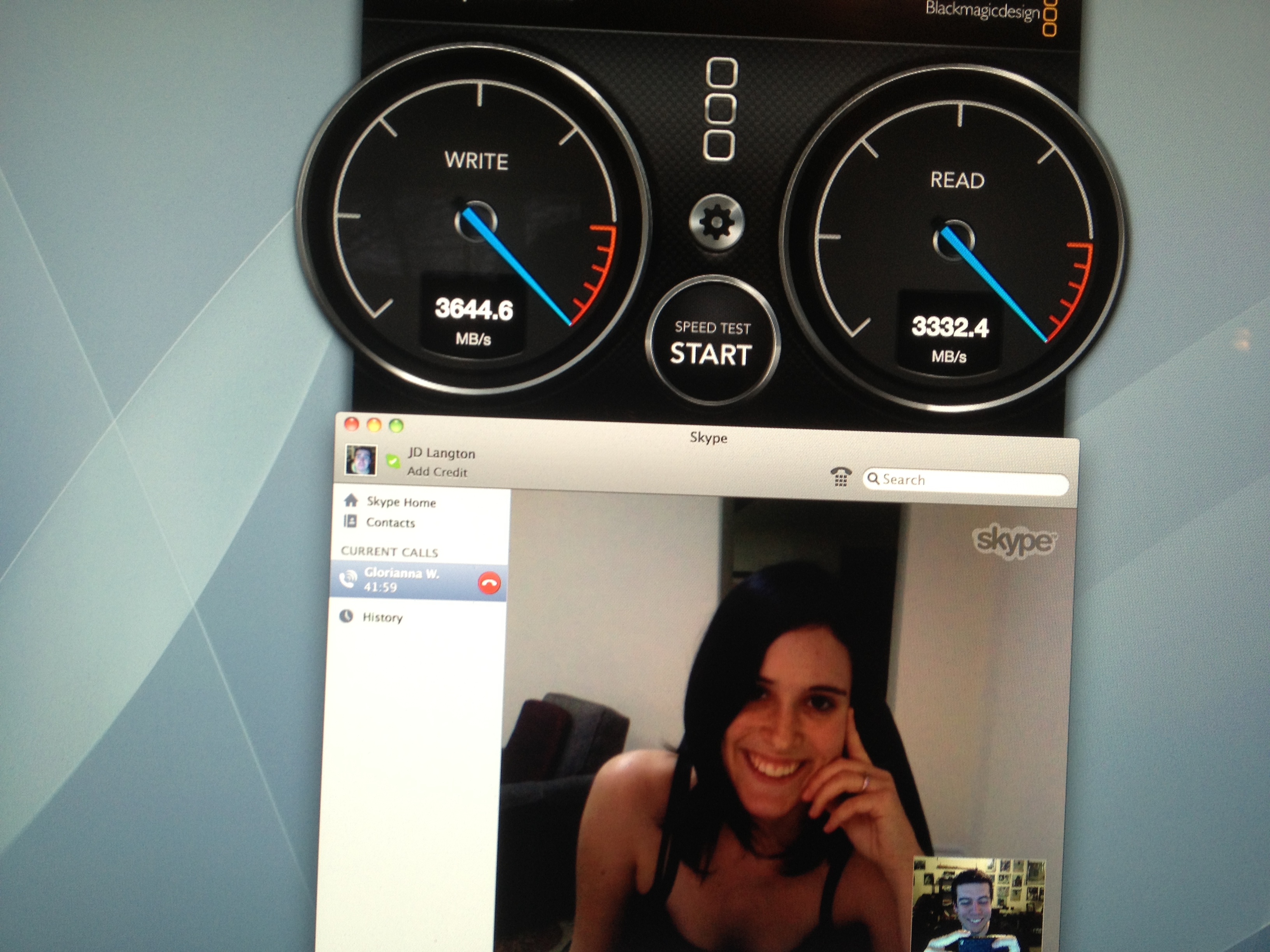

This is a REAL Imac.
View the attached image. Thats real Imac Speed. And a hot girlfriend just to rub it in lol
