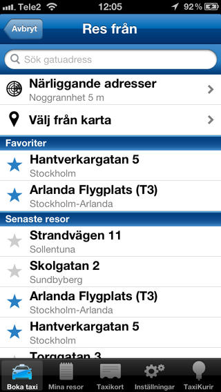

I wan't to implement a favorited section on my iOS app in my tableview. So if i click on a left detail image on a row, it should go up to a "Favorites" section and still be showing in the standard section. and the same by removing it in favorites. Like this:
Please give me some hints! 🙂
Thanks in advance

Yes I have aldready Done that, i have one array with the standard rows and then another one that is empty. I have two sections with headers and the top one is empty because favorites array is empty. In the table view the original array is loaded into the cellidentifier.
Should I have another cellidentifier for the favorited rows?
And use the method moveRowAtIndexPath?
This is where I'm stuck, moving the row to the first section when it gets tapped on the image.
Thanks again🙂
