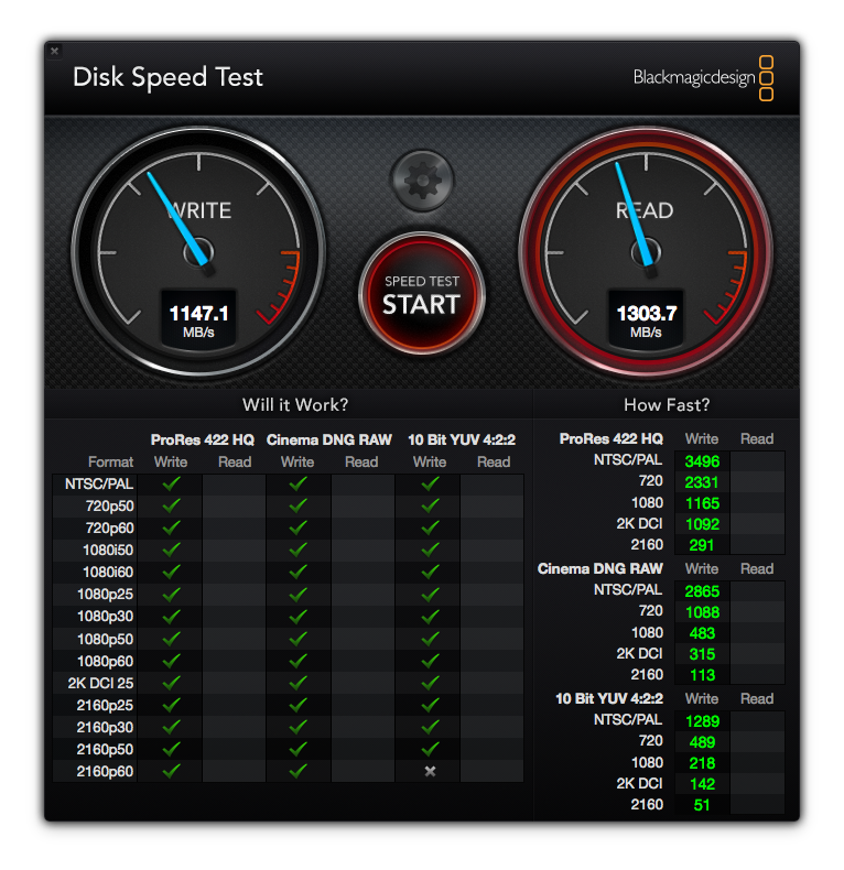

I use Kingston HyperX Predator AHCI. It came with it's own PCIe adaptor and is a x4 card. It's fast and bootable. Many use 3rd party adaptor and Samsung's AHCI or NVMe cards. NVMe cards are even a little bit faster than AHCI because of newer protocol.
I too believe that the last chapter by ActionableMango is a thing to consider. You might need a PCIe card for your work. On the other, many don't need continuos transfer speeds that much. I'm happy with that speed, but I would not necessarily need it - but you might.
This bootable AHCI version of this Predator is starting to become a rarity. They might be ramping down the production of it and go for NVMe only. You need AHCI if you want a bootable drive OOTB. I don't have any experience with NVMe's yet, by they are really good for data and scratch - with no boot option tthough.
ps. I've got a OWC Accelsior S too in one of my machines. It's a x4 SATA III card. It gives me 550MBps with SATA III SSD, out of the theoretical PCIe 2.0 x4 limit =2GBps
pps. I found all this information from this forum, and I decided the best for me is AHCI PCIe x4. Thank You to all former posters about this topic!!
