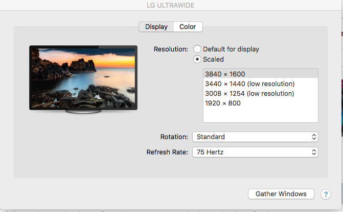

    I have just bought an early 2016 MacBook and an LG 38UC99 (http://www.lg.com/us/monitors/lg-38UC99-W-ultrawide-monitor)
    I have connected it via USB-C however am only getting 30Hz refresh rate, how do I increase this to 60 as I am getting lag with my mouse.

    I am, however I have it running perfectly at 75Hz now!

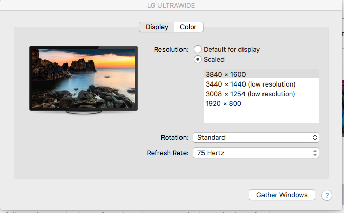

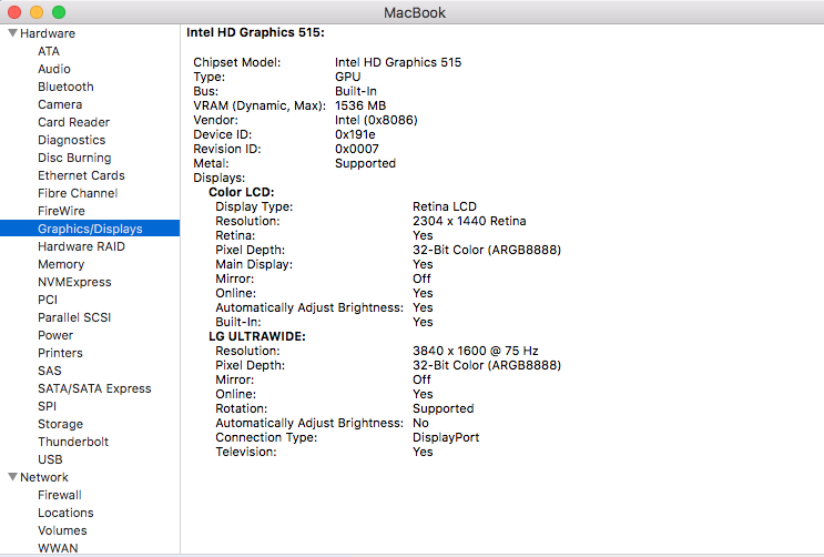

    I followed a guide that I found on 9to5 Mac which worked perfectly!
    See attached. Screen Shot 2016-11-15 at 13.14.54.png Screen Shot 2016-11-15 at 13.15.46.png
