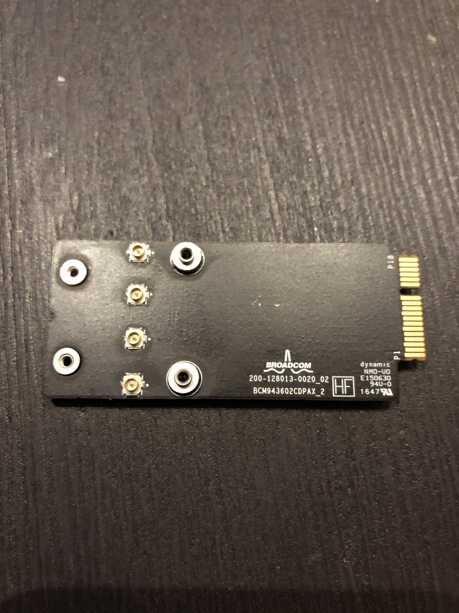

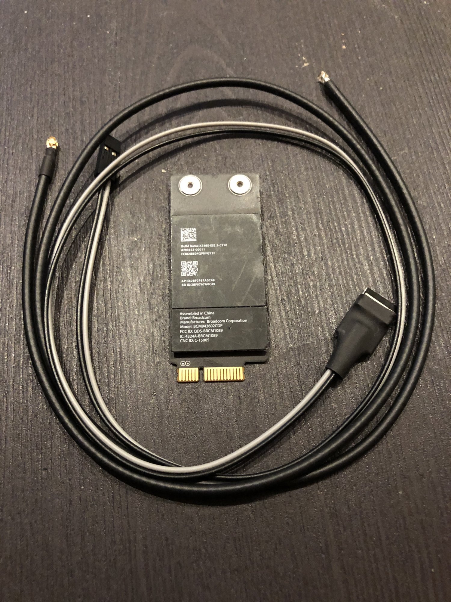

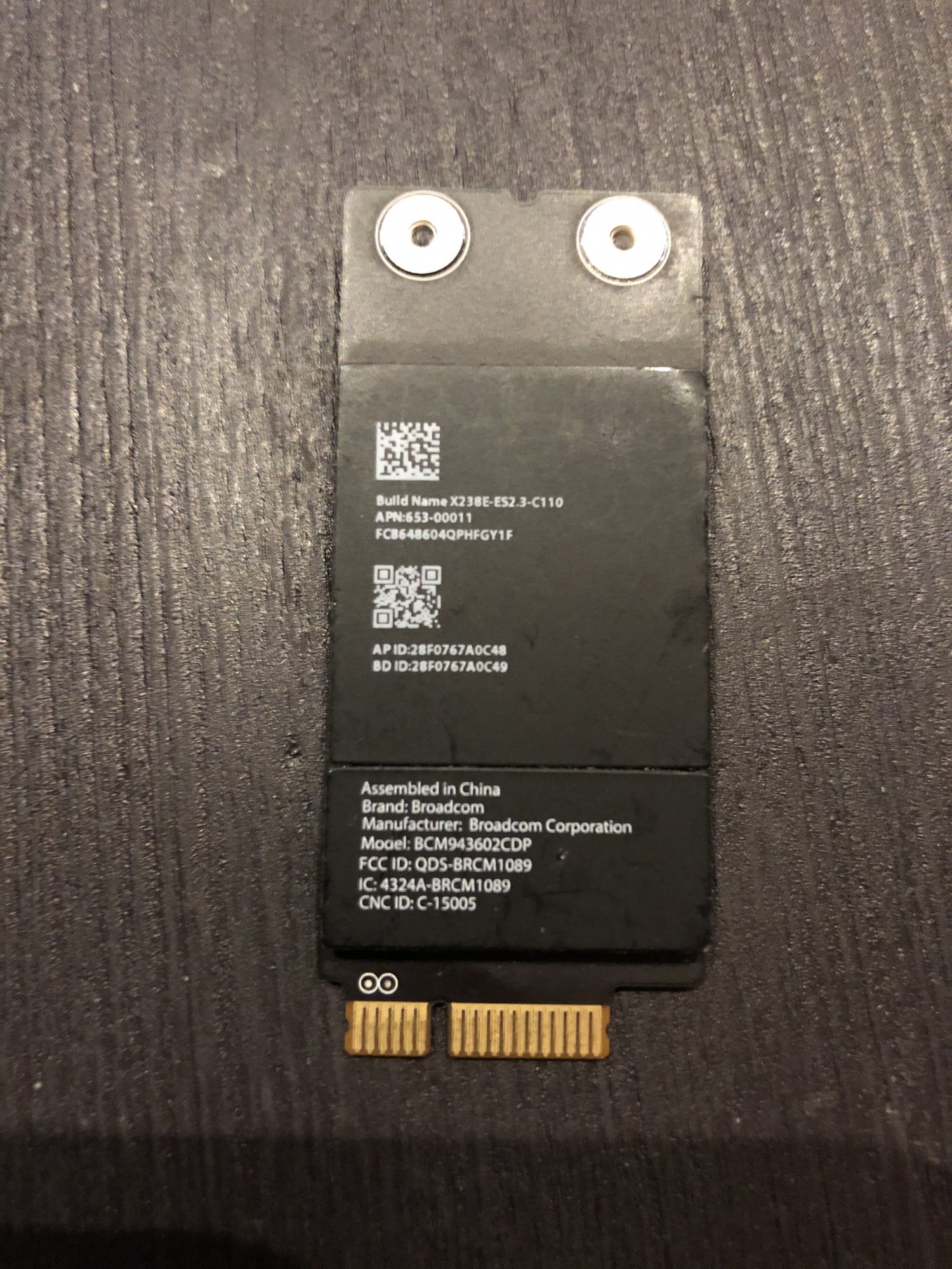

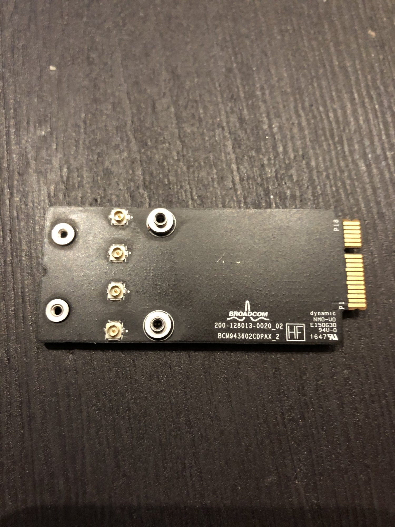

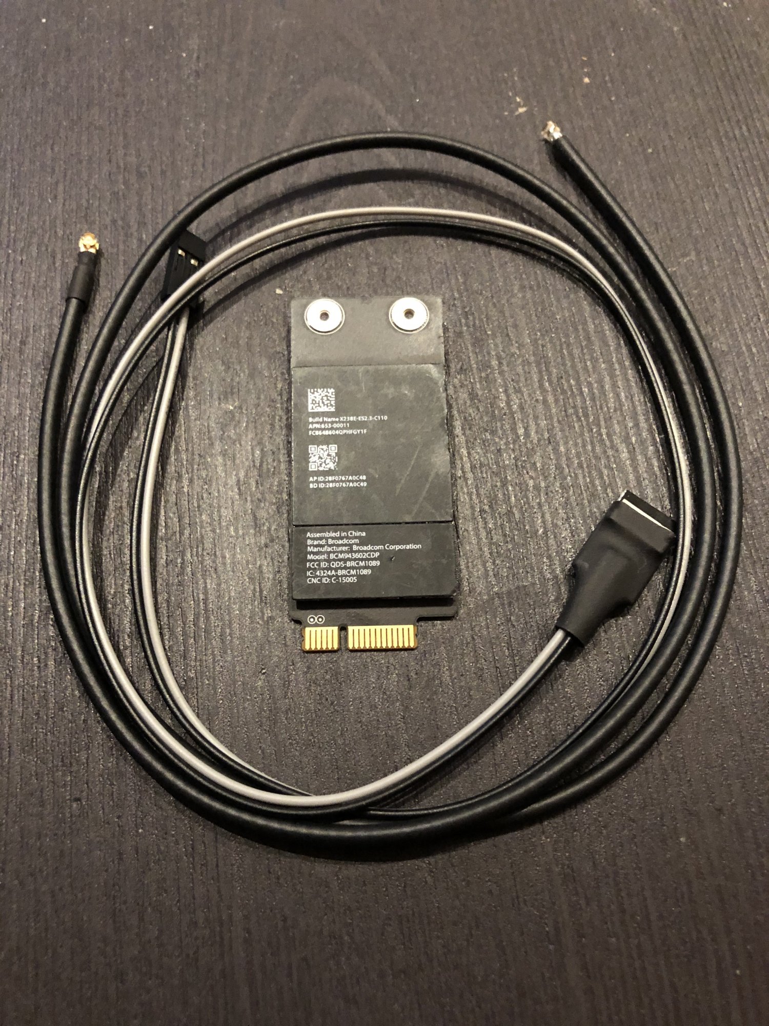

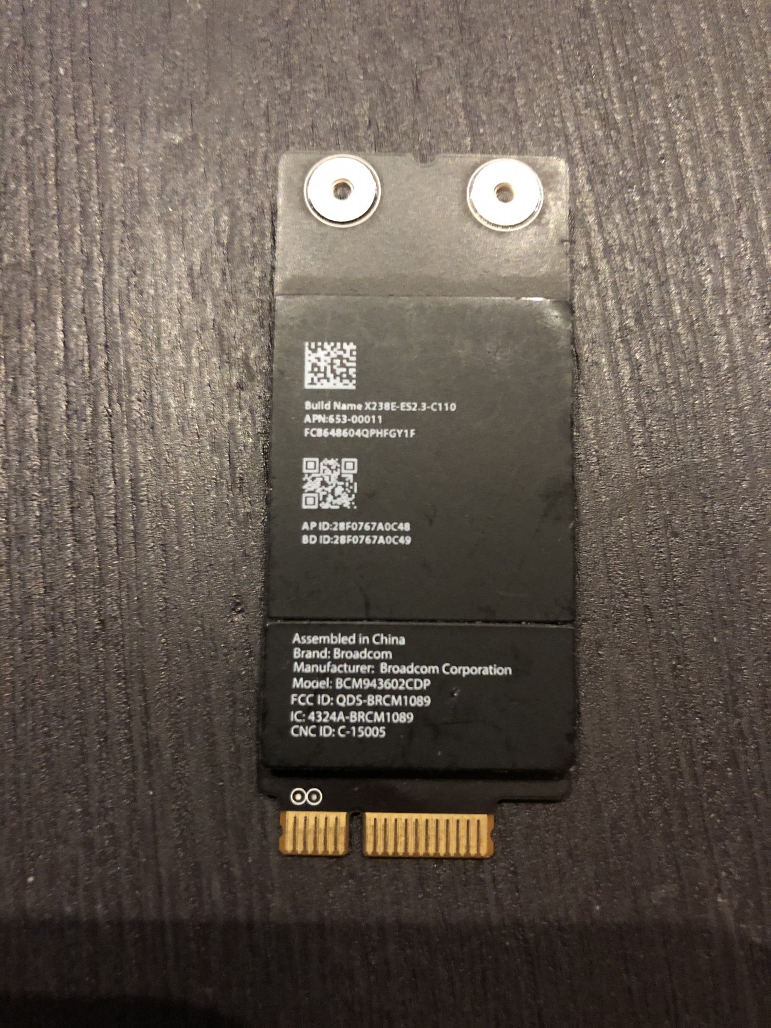

I have a cMP 2010 running on Mojave and I want to upgrade the WiFi/Bluetooth. I don’t know what adapter I need compatible with the card I purchased from Aliexpress.

I was more interested in the cable.
so you don't have to tinker with the USB board and seem to be like osxwifi's - or are they even?
That adapter card will work but the 602CD is too wide for it. I have the same setup (until I broke one of the antenna connectors on the card) and because of the plug on the side for the bluetooth, the card doesn't sit flat. You can screw it down nice and tight but its still going to bend over that plug. The 60CD tapers down so it goes around the connector, the 602CD doesn't.
