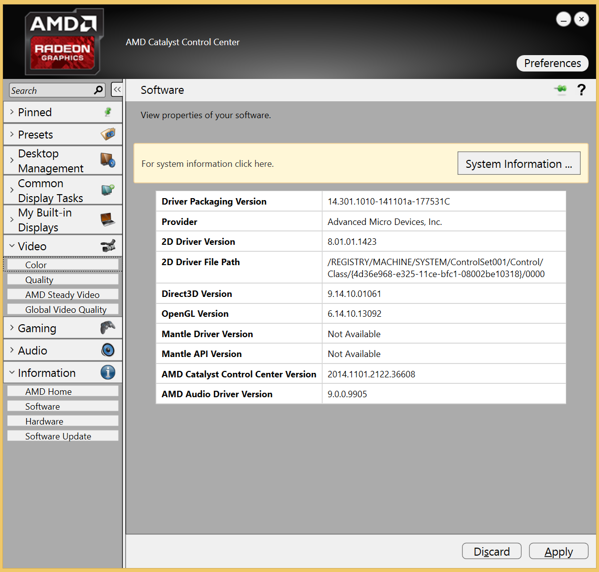

I read that the latest AMD GPU drivers include optimisations for GTA V so I wanted to try installing them on my Retina 5K with a M295X GPU. A couple of months ago I had tried without success but I figured now that the M295X was available in other machines something may have changed. I really didn't want to mess about with editing .INF files or copying old versions of installers over as you may have seen in previous posts about the subject.
I am running Windows 8.1 (64 bit).
My previous drivers were AMD's official Bootcamp drivers dated 16/12/14. Found here:-
http://support.amd.com/en-us/download/desktop/bootcamp
And this is what they looked like:-
So I tried to download the updated drivers dated 13/4/15 directly from within CCC. It was a non starter, CCC appeared to freeze.
I went direct to AMD's download page here:-
http://support.amd.com/en-us/download/desktop?os=Windows+8.1+-+64
I selected the Win 8.1 64 bit drivers and downloaded them. I did not uninstall the previous drivers. I ran the executable which unpacked the file. I let them unpack to the default folder and navigated to C:\AMD\AMD-Catalyst-15.4Beta-64Bit-Win8.1-Apr9\Packages\Drivers\Display\WB6A_INF and ran CU182335.exe
Everything installed no problem and I have not noticed any specific issues. I can alter the resolution on my display (no 5K). I quickly ran 3DMark across them and did not see any particular performance enhancement that couldn't be written off to 'margin of error'.
And here are the new drivers:-
I hope it helps somebody else out.

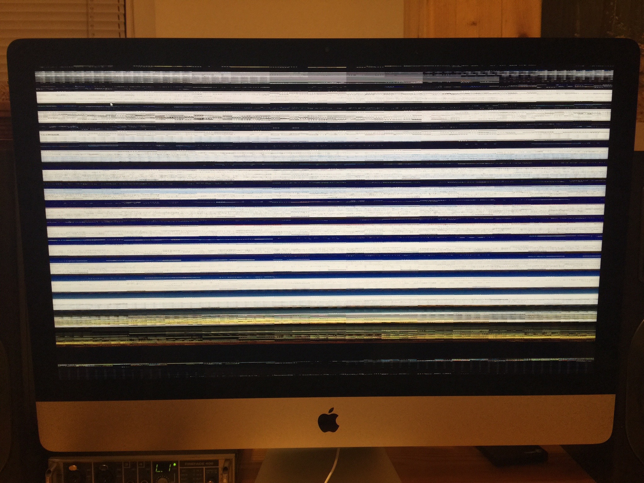

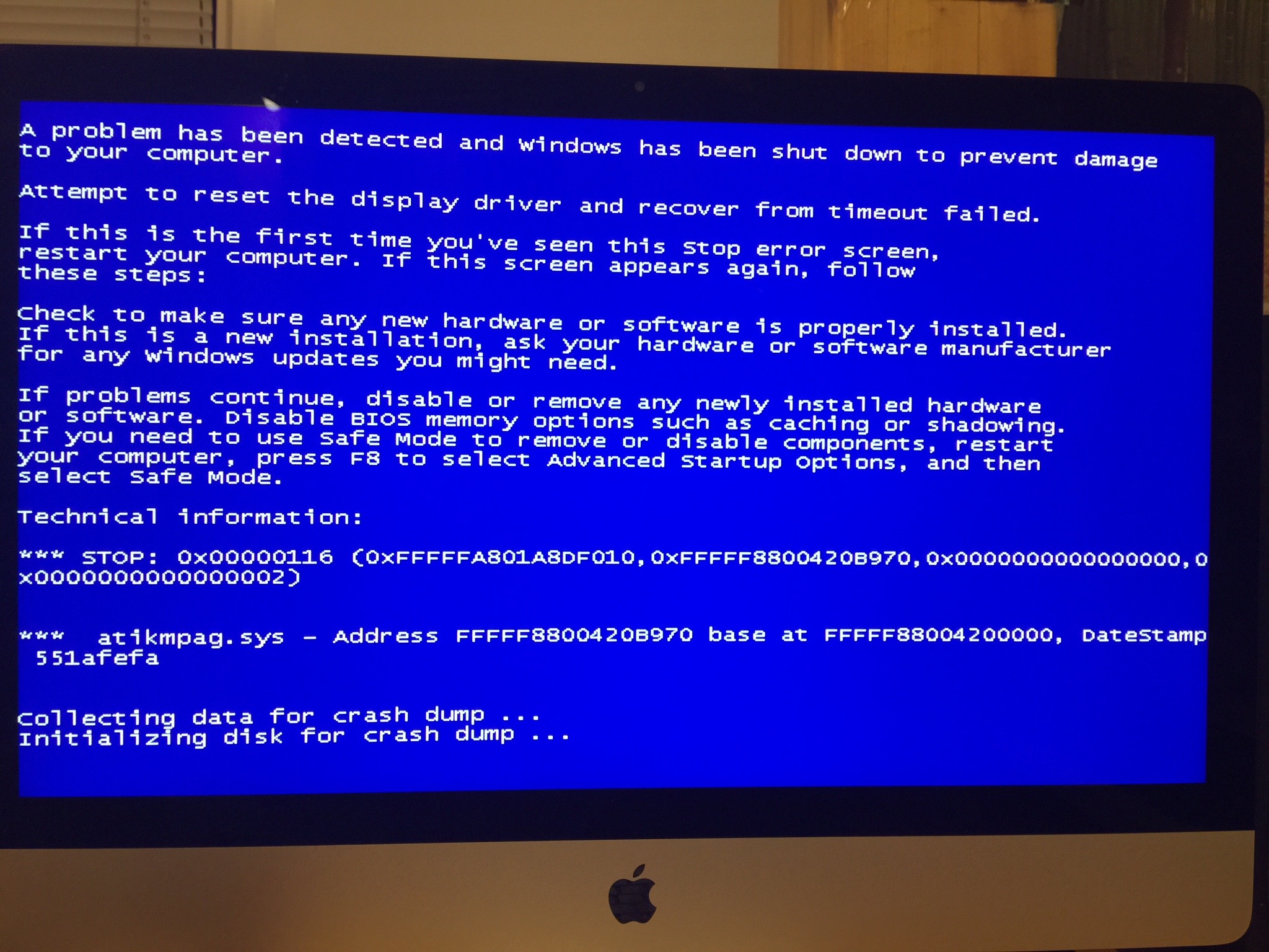

OK, so it ended up being a very bad idea. Did you have any chance to test how the driver works? Maybe it's just me, but this is what happened to me.
Shortly after installing the new driver using your little workaround I fired up GTA V to try it out. Graphics settings were messed up but I thought it was just because the driver is new, but then the graphics settings tab detected only 512 MB of available video memory (as opposed to 4096 it saw and worked with previously). So I turned off the game to make sure everything is installed fine - which is when my screen went all weird (see first picture) and the compter froze. After a hard reset I got a BSOD (second picture) - I hadn't seen one in months since installing Windows on the iMac. Even booting into safe mode froze a couple of times, so I tried the boot repair option and it ended up letting me into safe mode (the regular boot again failed with a blue screen), where I completely uninstalled the AMD driver package, rebooted and reinstalled the whole Boot Camp driver package and then on top of it installed the latest AMD Boot Camp drivers from December. Now everything works as it had before.
It seems there is a reason why AMD makes these drivers incompatible with Macs AND labels them Beta. From now on I'm installing only the latest supported boot Camp updates from AMD.
