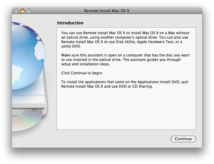

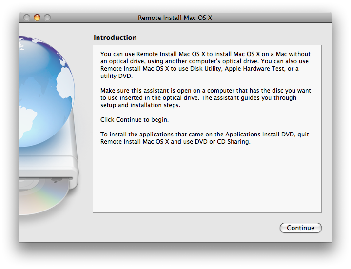

Have you tried using Remote Install Mac OS X?
Something else you could try is using disk utility to restore the dvd image to a partition on the usb drive, and then boot off that partition on the usb drive.
Tried the remote install and it won't even find the wireless networked mini.
Next up is to try your idea.
Worked like a charm. I REALLY appreciate your help. Thank you very much.
