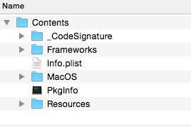

I really need help to install program as folders structure file. It is not DMG, archive, nor package file. I assume you know what i mean. See attached picture of the program file.

@fishrrman, as I said the program is not in any package, DMG, PKG, or anything. It is merely folder files, begin with root level just called "content". I can freely browser the program just by Finder, like any files.
You're missing the folder above that. That folder needs to be named whatever the app is called and end in .app. So make a new folder, name it without the .app at the end, then drag the Contents folder into it. Then rename the folder with .app at the end.
@chrfr, it works!!!! Highly Appreciate. Except one thing, the folder "Contents" must be exactly correct. I move around files at some points i mistakenly change the name to "Content" After change it back, then it works like a charm
