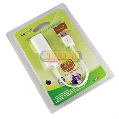

Take a look at the user manual provided with the product. It appears that that there is a driver disc but obviously you can't use that with MBA. Maybe there are some instructions in the manual.
So you connect the Ethernet cable to the adapter, then connect the adapter to the MacBook Air?
What does show up System Preferences > Network >> Ethernet?
The Apple branded Ethernet adapter just works.
I know that says it's Mac compatible but have you looked up that model online and read about anyone who it has worked for the MBA? Perhaps you just got a bad one?
You did go in the system preferences under network to check the settings though I assume? For example if you're using DHCP or static IP address? That could be your problem too.

I've found the solution: just download drivers here
http://yoomon.net/drivers/Umac/MAC10.X.zip
install
reboot
and after connecting adapter to MBA USB port, it open Network, find adapter and working fine.
Thanks for all !
P.S. Adapter for 6 USD much better than Apple Adapter for 30 USD
