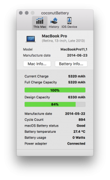

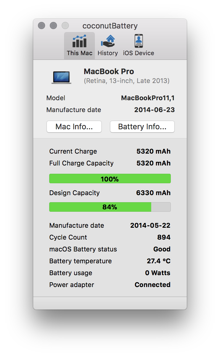

When I first got my MBP I used to obsess about the battery until I read a few threads on this forum. After that I quit worrying about it and just used it as needed and plugged in when not (pretty much what @odoy and everyone else is saying).
Just about coming up on 6.5 years and still chugging along.

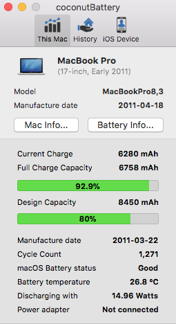

We still have an early 2011 MBP 15" in the house, and the battery has finally given up the ghost. 1,100 cycles - still keeps charge at around 70%, but it spikes down causing a shutdown when it gets warm.
