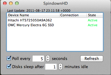

Now, download and install Apple CHUD Tools. Then search for SpindownHD and open it to monitor the status of your drives:
(Don't worry about the "Disk sleep after 10 minutes idle" checkbox. It seems broken and doesn't affect the value we set in Terminal)
If at this point the HD sleeps properly then you're in luck. For me, the drive woke up once in a while for no apparant reason. Also, everytime you open an open/save dialogue, it starts spinning. To make sure that the OS doesn't wake up the HD by mistake, you need to do two things:

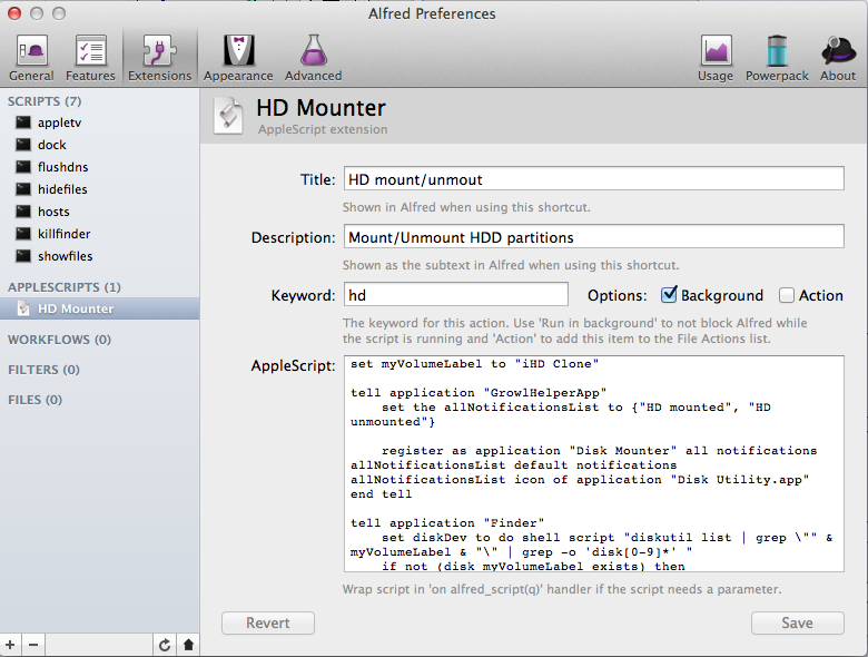

1.Mount/Unmount the drive as needed: There are numerous toturials about this on the web, but the best one which I found that utilizes Growl for noticifications is this:
set myVolumeLabel to "iHD Clone"
tell application "GrowlHelperApp"
set the allNotificationsList to {"HD mounted", "HD unmounted"}
register as application "Disk Mounter" all notifications allNotificationsList default notifications allNotificationsList icon of application "Disk Utility.app"
end tell
tell application "Finder"
set diskDev to do shell script "diskutil list | grep \"" & myVolumeLabel & "\" | grep -o 'disk[0-9]*' "
if not (disk myVolumeLabel exists) then
do shell script "diskutil mountDisk " & diskDev
tell application "GrowlHelperApp" to notify with name "HD mounted" title "HD mounted" description "Hard drive has been successfully mounted." application name "Disk Mounter" icon of application "Disk Utility.app"
else
do shell script "diskutil unmountDisk " & diskDev
tell application "GrowlHelperApp" to notify with name "HD unmounted" title "HD unmounted" description "Hard drive has been successfully unmounted." application name "Disk Mounter" icon of application "Disk Utility.app"
end if
end tell
(Credit goes to here)
Just replace "iHD Clone" in the first line with the name of one of volumes on the HD. This script mounts/unmounts all the volumes on the HD and then notifies Growl.
If you're using Alfred or a similar app, you can add this script as an extension which then you can launch by a couple of keystrokes.
