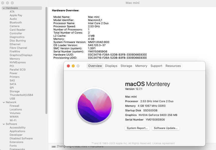

Today I just open my mac mini Late 2009 and I wnat to upgrade 4G memory to 8G, I got beep sound after I replaced new memory. I want to know if the memory has problem or my firmware is lower, does anyone help me?
By the way, mac mini firmware version is MM31.00AD.B00.
I got message "This computer does not need this update" when I run the macminiFEIupdate.pkg. does this mean the new memory has some issue?

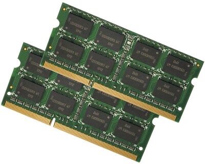

I have purchased ram from this eBay vendor before for my Early 2009 Mac Mini. Below are two links to the vendor's offering for 8GB (2x 4GB). Both links should work, but I'd try the first one.
-- Mod's, I am not the vendor and these are not my items. I am not selling anything. --

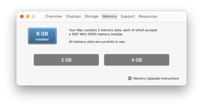

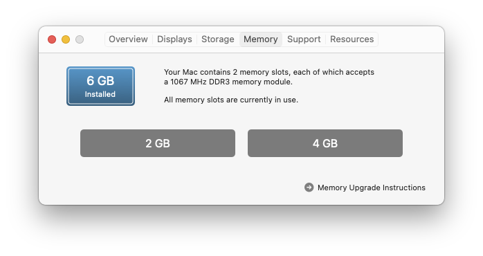

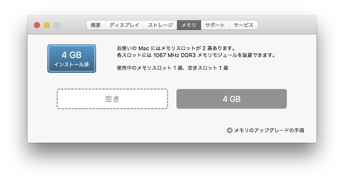

Though I returened memory and buy new one, now I know that memory is no any problems! I tried new memory but I got the same result as past, the sound beep every 5 seconds! I also tried only bottom slot, the result is the same! Then I tried top slot, that is OK! at last I insert original 2G to bottom and new 4G to top, that is what I have 6G memory!
Does anyone has similar experience? does firmware MM31.00AD.B00 only use 6G max memory?

Is that one beep every 5 seconds?
Or 5 beeps that repeat every 5 seconds
One beep every 5 seconds means that the RAM is not recognized at all.
5 beeps that repeat means that the RAM is recognized, but does not pass the power-on test.
Try reversing the memory - 4GB in the bottom, and 2GB in the top
If you get memory to work in both slots at the same time, then reversing those chips should also work.
I think that you still have a problem with seating the chips in the slots, as both slots appear to be working, AND even if only 6GB is working, then the same chips should work in the other slots (4GB in the lower slot, and 2GB in the upper slot.
I cannot find any information that is any different. I think your Mac mini should support 2x4GB chips to give you a total of 8GB installed. That should work.

It might be one beep every 5 seconds...
Both 4GBs doesn't work in the bottom, but both work in the top slot, I tried again and again....
I also found this article mac mini not booting up with 8GB memory after 10.7.2 update, they had the same problmes as mine.
It is also said the brand (Micron, Hynix, Nanya) might work, but I am using non-brand memory, I am not sure if this is the problems, is this possible?
It's a familiar story, many Macs are known to be a challenge to find memory that is accepted by that Mac.
You may find a fix if you try a different source for your memory. One choice is one of those brands that you listed, rather than some generic, no-name memory. I usually am more positive about a memory purchase, when the manufacturer or the seller make a point of mentioning that they either made that memory specifically for a Mac, or they say that the memory was tested on a Mac. Let us know how it goes... Good Luck!

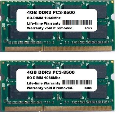

What are the 4GB RAM stick labels?

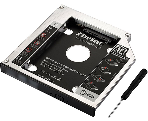

I will use 2bd HDD Candy as attachment, I think it is no problems, do you think so?
Yes, you can replace the internal HDD with and SSD. That swap does not require a change of any hardware.

Just curious now -- your screenshot in your first post showed that your hard drive is named SSD500GB, which made me assume that you already have an SSD installed. I guess now that is just what you named it...

That is a USB SSD where I installed Monterey by OCLP, I named it to SSD500GB when I formatted it before installation, it still keep this named even I already change it to Monterey, how do I modify this name in OCLP EFI?
