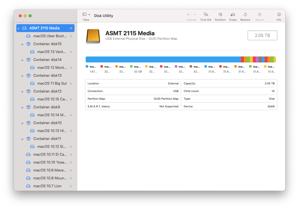

Ok, so I'm on my 'great journey of tedium' and started things off as making the partitions on a 2TB drive. I have cribbed those above and went with 32GB partitions as follows:
So for 10.7-10.11 I made HFS+ partitions. Then for 10.12-13 I made 32GB containers each with an APFS volume in there. That leaves about 1.67TB free for 'future expansion' and I left that a big HFS+ partition as a work space and a place to put work files/utilities if I need. The thinking being that HFS+ will be more compatible with more OSs. At some point I may go back and put in earlier operating systems. Who knows all the way back to macOS 1!
Anyway, I also chose a SATA 2.5" drive. The reason is some of the NVMe drives, even plugged into USB do not come up on some of the older machines (for whatever reason) and this Sata drive is easy to attach via USB or even into old firewire enclosures if needed. So it's more flexible with older stuff but still works well enough with read/writes around 500MB/s.
Did I do something stupid here? would you guys have done something different with container/partition design?
Thanks for any feedback.

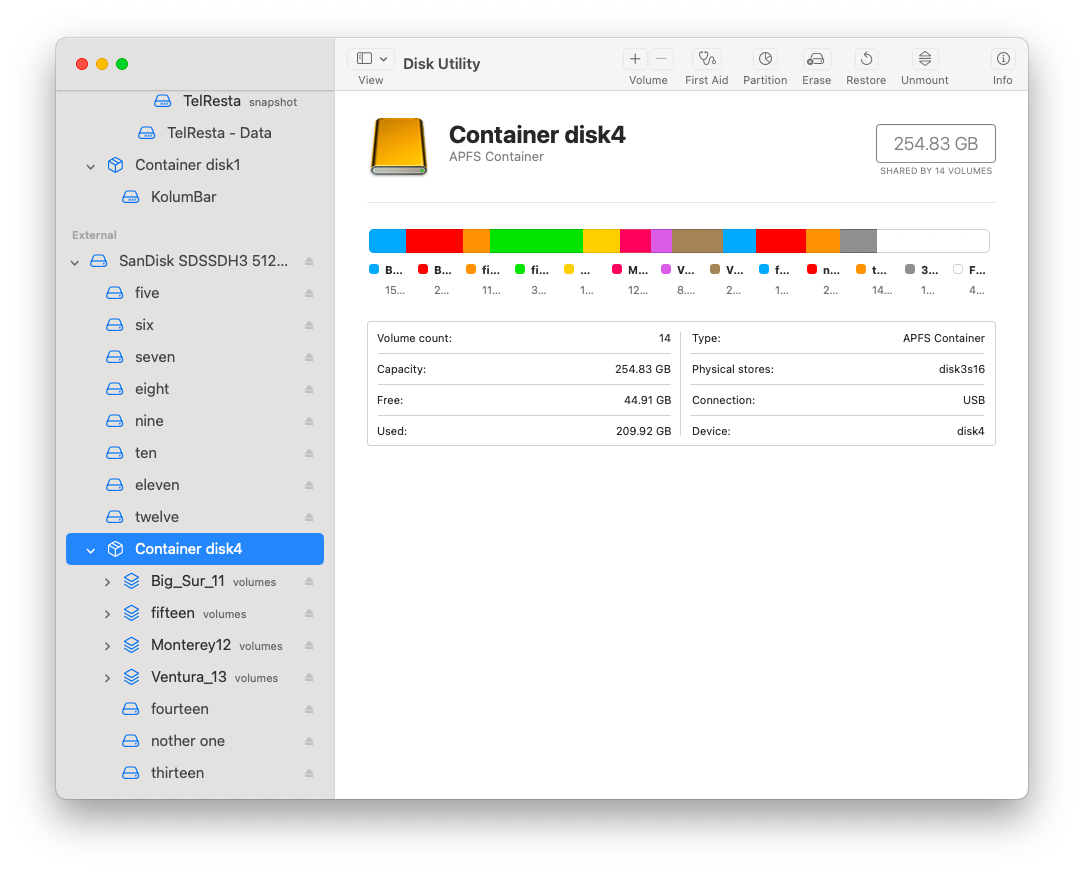

DU shot of my take on a multi-booter drive, Systems on High Sierra and later all share the same container space.
Not sure why I would put a Sierra system on APFS, as it is only APFS-aware, but doesn't set itself up with APFS as all later macOS versions do. Older systems are on 32GB HFS+ partitions, and HS and newer all share the 256GB space in the container. Also, on an SATA SSD, I do have a partial set of booting systems on an external NVME drive, and also had some "difficulties" in getting either booting, or mounting all partitions, so I have moved to later systems-only on that multi-boot drive.
Reactions: ZombiePhysicist

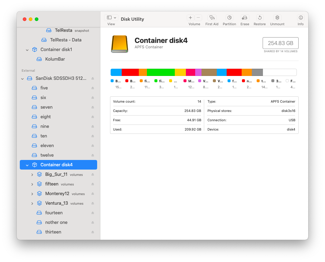

View attachment 2144780DU shot of my take on a multi-booter drive, Systems on High Sierra and later all share the same container space.
Aye, so Sierra should not be installed on APFS. UG! Double UG! I just went through this, installed Lion, all went well. Booted. Still well. Used for 3 seconds, not well. The boot drive ran out of room. 32GB is too tight for Lion, and I imagine will be too tight for later builds. You probably could squeak by with 64gb, but at this point, I just got a 4TB SATA SSD I had laying around, and am giving everythign 128GB.
So why the UG. You cannot go back and just 'resize' these partitions. You have to redo them from scratch! Luckily reformatting the 10.12 Sierra from APFS to HFS was just a reformat!
Just as an example: My boot system with Lion is on a 32GB partition. It has only a very basic install. I have added a couple of disk maintenance tools, and an app or two. like OnyX, that I use for a very simple setup when booted to that system. The Lion install, fully updated, takes up just under 7GB. So, it actually has more than 24GB of space available.
Well, OK, not a lot of space, but I dont generally need a lot of space. These boot systems are just to find out if a particular Mac has problems when booting to a basic system, using a variety of systems that should boot without trouble. I don't really do anything that will fill a system. I wonder what it is that is filling your Lion drive while booted. Should be pretty easy to discover that.
I only have one boot system that takes up more than 16GB, and that happens to be Yosemite (because I tend to go that as a quick boot for many older Macs, so have a bit more stored on that - so, at the least, there is still more than 16GB free space regardless what system I boot from.
OK, if you want to change an APFS container to HFS+, that's pretty simple from Disk Utility. I was just doing that today.
From Disk Utility, choose the container holding the Sierra volume. You will be able to choose to erase as HFS+, which will remove that (and only that) container, leaving you with an HFS+ volume. Only takes a few seconds.
