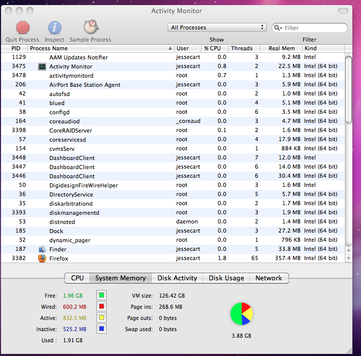

agreed. OP, can you post a picture from your activity monitor showing your computer under normal use? A picture of the Page ins/outs under the "system memory" tab would be good.
If that represents normal use for you, you're not maxing out your existing RAM, and adding RAM would give you no improvement in performance.
I opened ProTools, Logic, iMovie, mac Word, Reason, Garage band, iCal.. and five other programs. Didn't even peak over 2.6 out of the 4.
