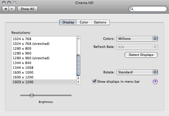

This does'nt work, as i said in my previous post:
The TV is not detected as a second display, so it does'nt show up in the display prefs window. Even when i press 'detect displays'
This only works with a XT1900 graphics card, and i have the other one.
Anyone with an alternative?
can you tell me what you've connected to the DVI port?
i say this as the preference window you show suggests that the DVI to video adapter is not being detected, which could be that its not "attached fast" to the DVI port or worse, that the adapter is not working!!!
