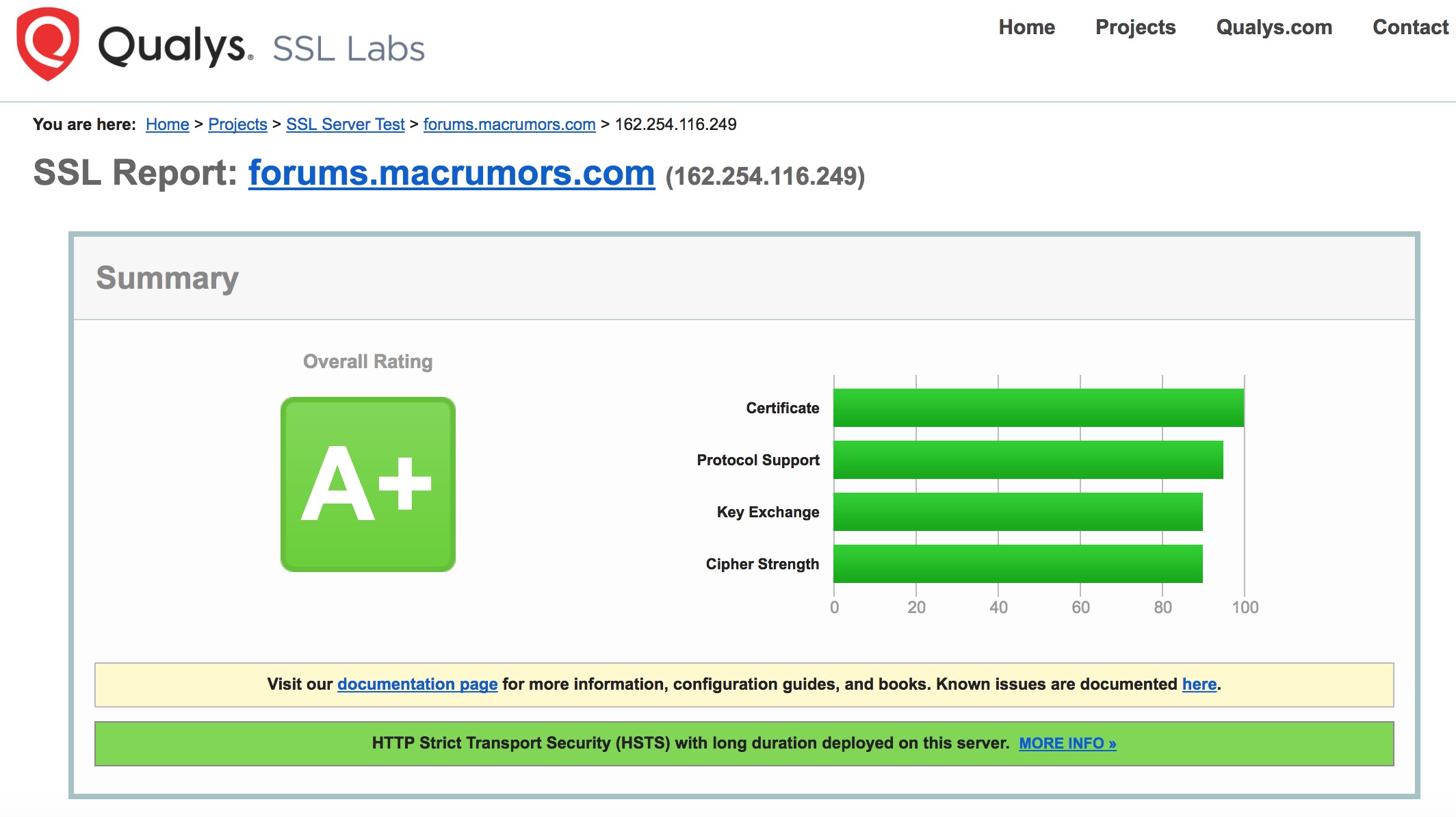

  • When entering sensitive information to be sent over the internet, ensure the cryptography is modern with a TLS check - https://www.ssllabs.com/ssltest/

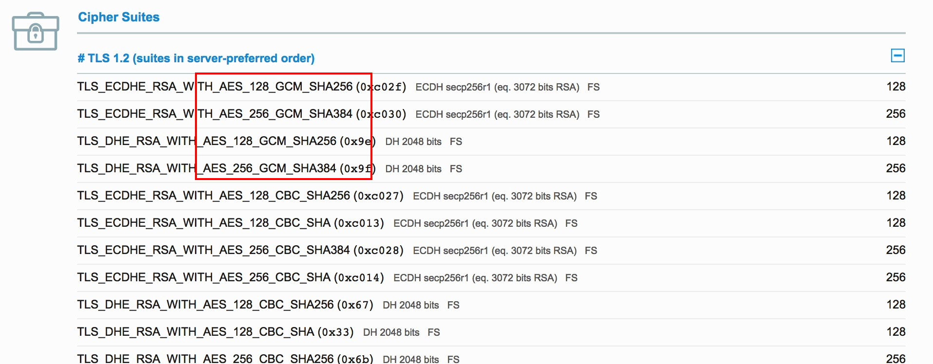

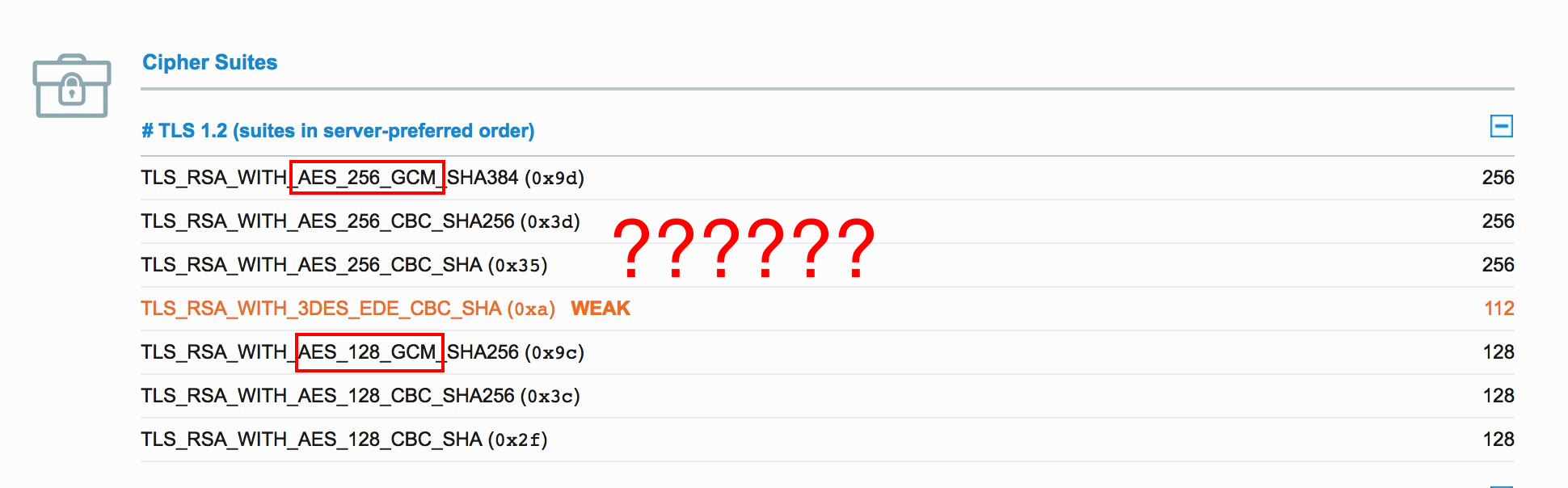

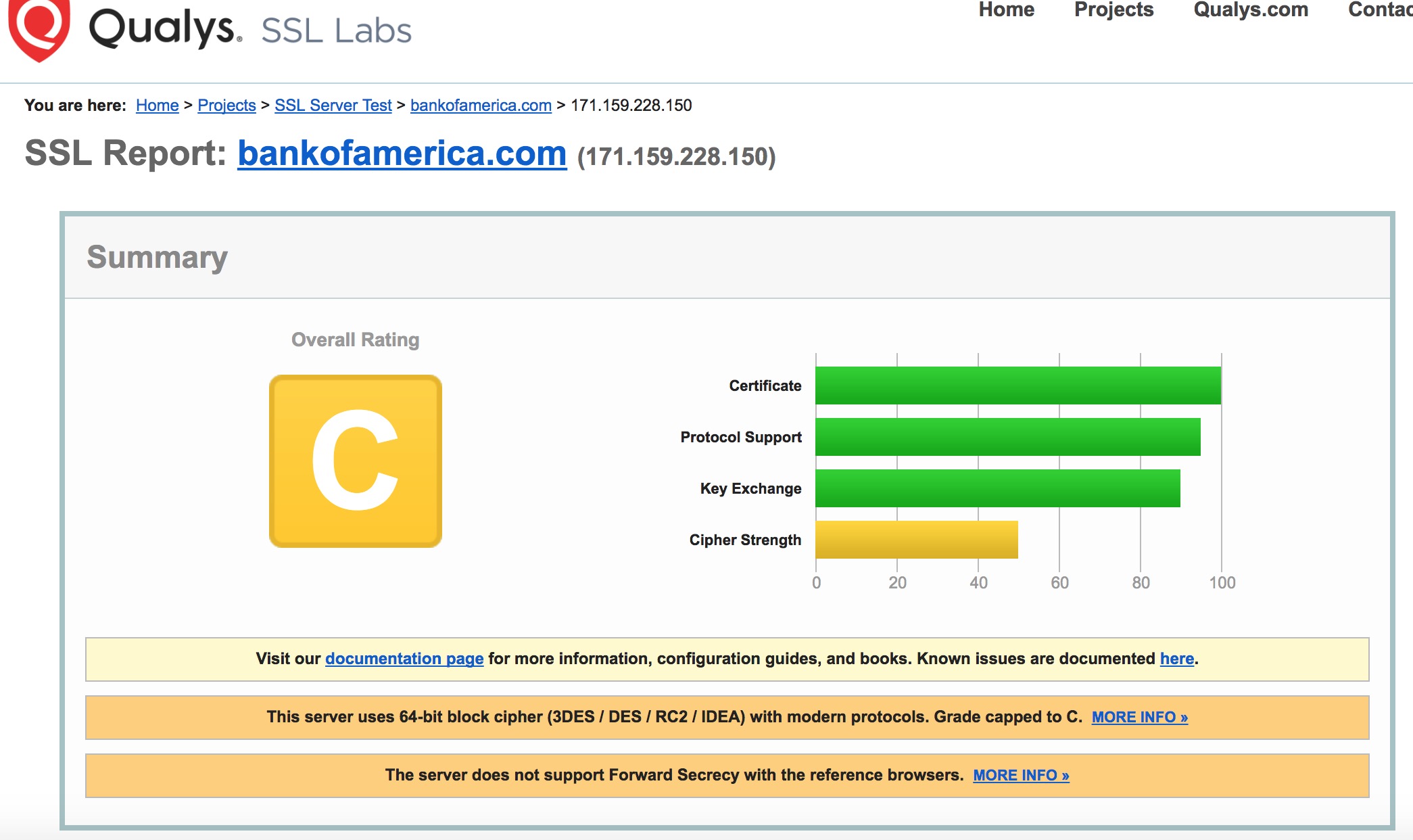

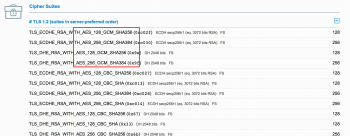

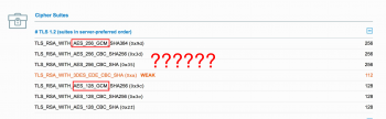

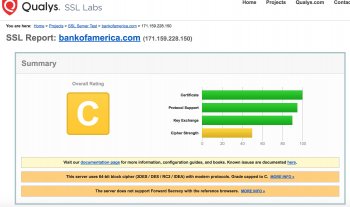

One limitation I have observed with banking is the deployment of new cryptography among financial institutions. One would think they would be fast to adopt the latest standards. However, that appears to be often untrue. Addressing vulnerabilities to downgrade attacks and other man-in-the-middle attacks were slow, at best, and TLS 1.2 adoption was anything but fast, and the GCM cipher adoption was, in some cases, disturbingly slow. Presumably, TLS 1.3 adoption will not be quick either. Unfortunately, the implication here is that you could do everything right on your end, and still have your data being vulnerable depending on what a company is doing on their end. Again my understanding here is very primitive.
MacRumors
Bank of America
My knowledge on security is very limited, but why on Earth would they set this order?!?!
My knowledge in this sector is very limited, too. I can imagine that The Bank of America prefers to use the Galois/Counter Mode (GCM) because of the better performance compared to Cipher Block Chaining (CBC) to serve such many clients with an optimal speed of service. The bigger problem your screenshots are showing is probably that their server doesn't support Forward Secrecy (FS) to prevent compromising past session keys, but maybe past sessions will get deleted immediately by them so that there is no real risk with that.
