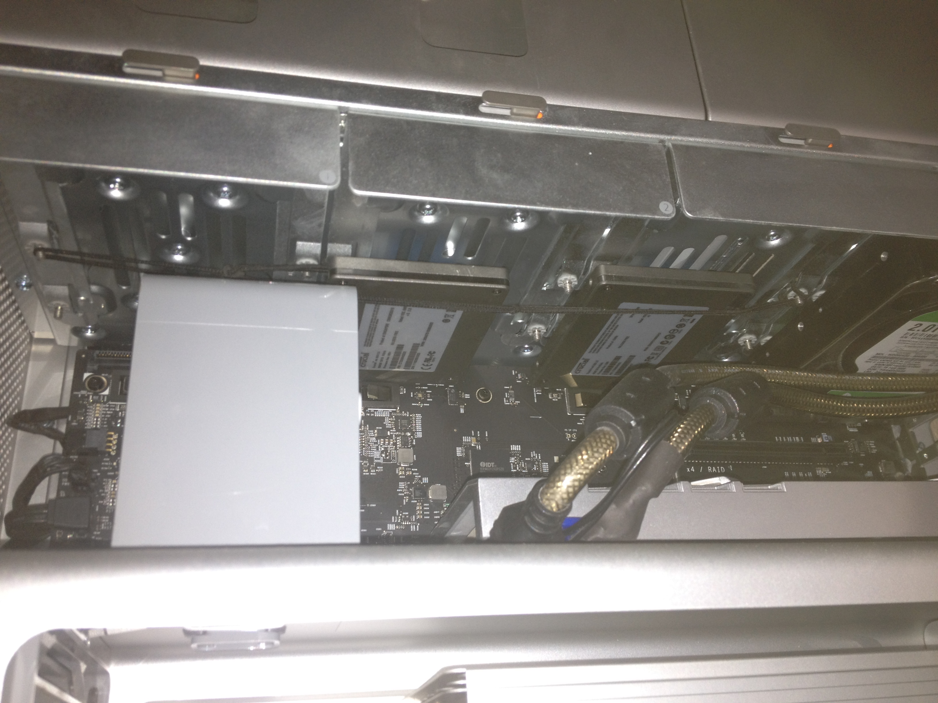

Here's my ghetto mount till my OWC Mount Pros come in 😎

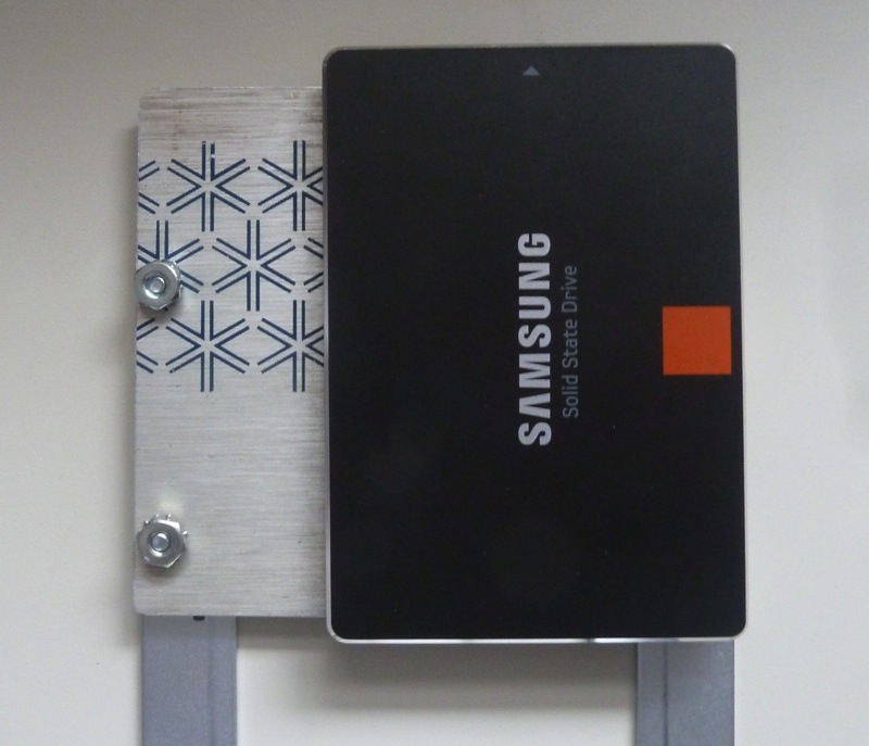

This describes a DIY adapter for a 2'5 SSD mounting in a standard MacPro-bay.
Time: 20 minutes.
Cost: less to nothing
Level: if you can hold a drill you’ll succeed!
Details: leaves no permanent marks on your Mac or any accessories.

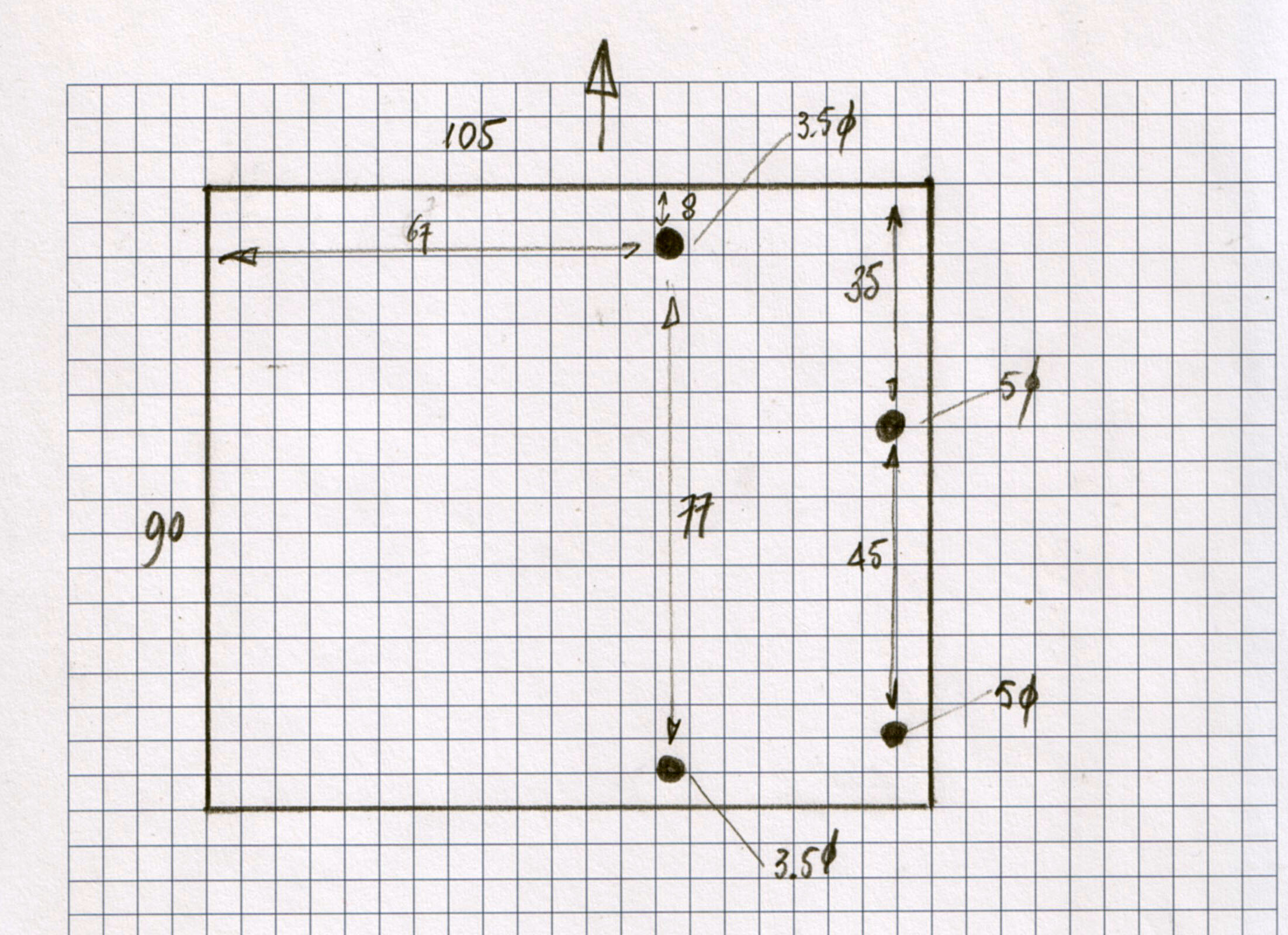

What you’ll need:
materials:
-aluminium sheet, 90 x 105 mm, thickness around 0.5 mm
This sheet material should be sturdy, but somehow flexible as well.
(I took mine from an old fridge-door…)
-2 bolts for the SSD (M3-size for the Samsung I was about to install)
-2 nuts and bolts M5 (for the MacPro-bay)
Tools:
-knife-cutter
-drill
-screwdriver

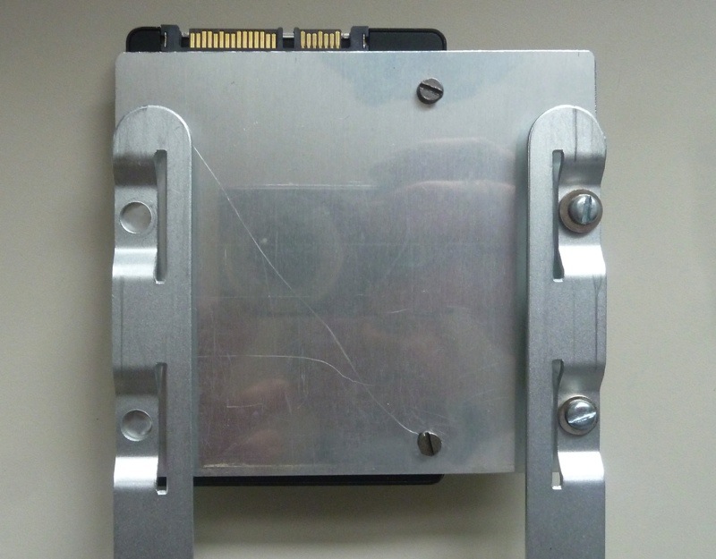

This how to:
Refer to the drawing below. This has a 5mm grid.
1. Cut the alu-sheet to size with the knife-cutter.
2. drill 2 holes 3.5m
3. drill 2 holes 5mm
Use a file to smooth any irregularities. Now keep your work area free from any aluminium particles messing up delicate electronics!

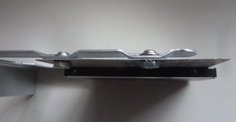

4. mount the SSD with the two M3 bolts.
(after you've seen the final result, you will understand you won't need the other 2 bolts)
Now you have your SSD-base ready.
Next:
5. Remove the bolts (and its rubbers) from the MacPro-bay
(the rubbers prevent vibration from a HDD-drive; SSD won't need this)
6. Fix the SSD-base to the MacPro-bay with two M5-nuts and bolts.
Align and fix, according to any other available HDD-bay from your Mac.
7. Now retract your SSD-bay carefully in your Mac. Don’t force!
When it doesn’t fit easily, try to re-align your SSD-base and try again.
Mine worked flawless at first attempt!
