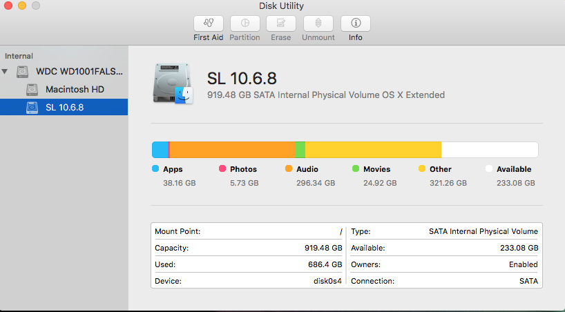

Here's my situation. I have a 1TB internal hard drive on my 12,2 iMac that, when i first got it, i split into 2 partitions. I got my refurbished imac shipped with El Capitan, but i wasn't ready to make the move from Snow Leopard yet since all my old music projects relied on the older software and plugins, so i made 1 partition 920GB to host my backed-up Snow Leopard system, and the other partition was 80gb so i could casually use El Capitan for a while and see if i liked it.
Fast forward almost 2 years and i finally upgraded my 920gb Snow Leopard drive to El Capitan (and all my software works fine), so now i have no i need for the 80gb El Capitan partition anymore, and i want the disk space. I just want 1 partition HD.
However there's software on the 80gb drive that i'd like to use on my final 1 drive too. So i'd like to either merge to the 2 partitions OR copy+paste data over to the 920gb and then deleting the 80gb partition.

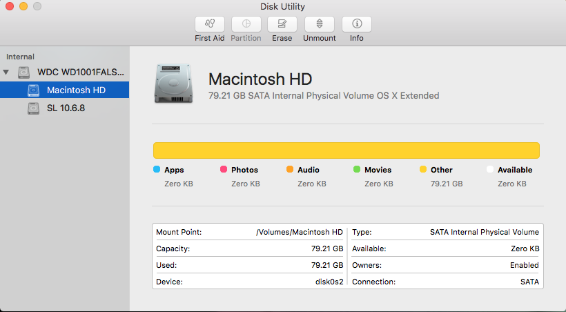

Here's my setup...
The 80gb El Capitan drive is called "Macintosh HD". Or disk0s2:
(pic1)
^ I realize this drive is full. I can fix that if needed for functionality reasons?

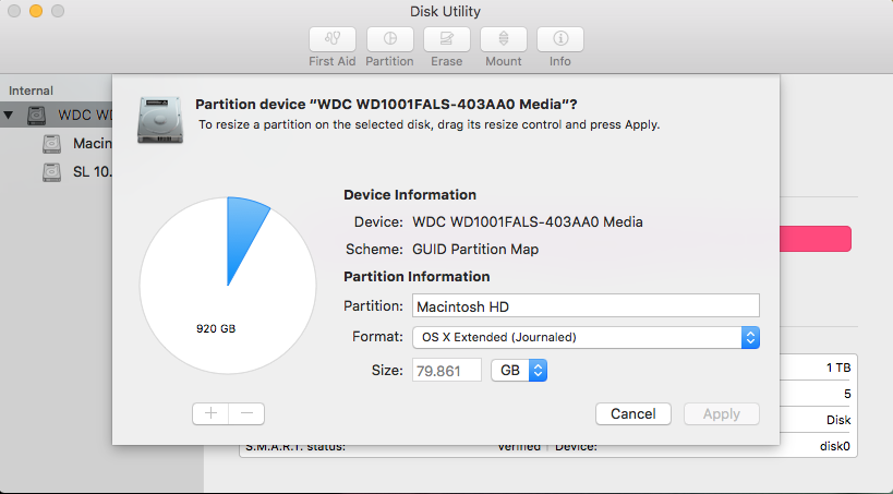

The 920gb drive is called "SL 10.6.8". Or disk0s4. Despite the name, "SL 10.6.8" is running El Capitan as well (since today)...
(pic2)
^ This is the only drive i want to use going forward. It has old software on it that would be a nightmare to reinstall.
My problem is that, when viewing Disk Utility from the 920gb partition, the "-" button on the 80gb partition is greyed out so i can't delete it. And i can't resize it down, only up. Not sure how to proceed.
