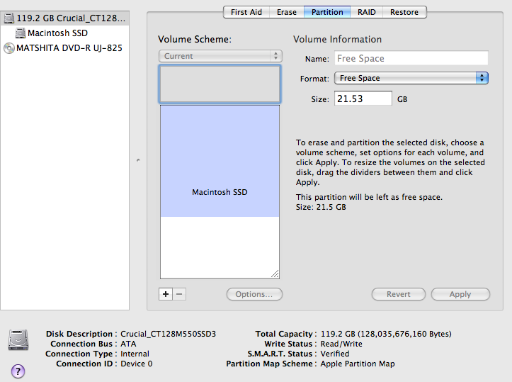

Alright, so I've been trying very hard to try and get my main partition to take up the whole hard drive after deleting Debian (needed more space). But in Disk Utility, I can't move my partition up; strangely, the free space seems disconnected from the main partition (unless this is how it's supposed to look and I've just forgotten). I've tried booting into the Leopard installer and doing it from there; yet it still didn't work. I've tried using a Lubuntu live CD and using GParted (and even parted) to try and move the partition but I get the error "Sorry, HFS+ cannot be resized that way yet.". Hell, I've even tried grabbing a SATA to USB adapter; plugging in a hard drive, making a bootable backup of the internal hard drive using Carbon Copy Cloner, booting off that, format the internal hard drive, and make another Carbon Copy Cloner backup to the internal hard drive again; but I can't do that either because my Powerbook refuses to boot off of USB for some strange (and frustrating) reason, and it doesn't matter if I'm trying OpenFirmware or holding down the option key at startup. I'm lost here. What can I do? I've also included a picture of the partition map from Disk Utility; maybe some of you guys can see something wrong with it or something. Thanks.

Here's the best method, I think:
Backup your SSD to another drive.
Change the partition scheme so there is just one partition, then click the Apply button.
When that completes, you will have only one partition, freshly erased.
Restore the backup to your SSD.
You could do what you are trying now, if the partition that you want to remove is BELOW the one you want to keep.
But, the partition scheme won't allow removing a partition higher in the list. All you can do is erase it, but you can't merge the space with a partition under it without erasing both.

Should I try a different cloning tool this time (such as dd?) I already have a clone of my SSD on an HDD where I used Carbon Copy Cloner, but since that's a file-level clone, I don't know if it would work the same.
But if I did that, wouldn't it not be able to boot once I copied the files back? That's why I've been thinking of using dd; it's a bit-perfect copy.

So dd is a less than suitable option for disk clones then? Again, I already have a CCC copy of the internal hard drive, but I'm not sure if it's going to be bootable once I restore it back to the SSD (and I really don't want to screw up in that regard 😀)
dd will work, but it's overkill and can be slower than CCC. CCC is almost always bootable when cloned across drives.

Alrighty then. Going to go boot into my Leopard disk and restore the backup (using Disk Utility); wish me luck.

Operation was a success; restore worked fine! Typing this from the Powerbook G4 right now, and I can now use all the available disk space. Rather silly that there is no way to just move the partition IMO, but maybe that's just how HFS+ works (not really an expert).
